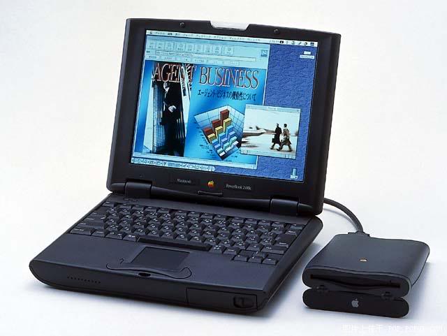

Pierre Films
macrumors member
Nov 6, 2004
33
Patmian212 said:
I was thinking of installing one in my new 12" ibook. Does anyone know if its is very hard. I'm pretty tech savy, I've installed RAM and Videro Cards. I am aware it is more difficult then RAM but is it very hard? Also is It just plug and play?
Believe me, It cannot be any harder than installing a hard drive into my (your old ;)) Powerbook.
I recieved the 20gb hard drive for the Powerbook 2400c a few days ago and installed it successfully. It took me about an hour and a half since I had to literally take apart the whole machine ( :eek: ) to get to the hard drive itself. It is now happily running OS 9.1 without worries of space. :)

CanadaRAM said:
Oooh. Wrong answer.
Installing hard drive in an iBook is nothing like the powerbook. It is a nasty little job, about 2 hours for the mechanically adept and meticulous, and not gennerally desirable or even possible for a newbie hardware jockey.
Perhaps, but this is the (ultra-cool :cool: ) sub-notebook Powerbook 2400c.
I seriously doubt you have to take part everything (literally) including the LCD screen, keyboard, trackpad/entire front cover, and motherboard just to get to the iBooks hard drive. You have to do all that and unscrew about 30 or so screws of different sizes just to get to the hard drive of the 2400c. Not very fun.
Pierre Films
