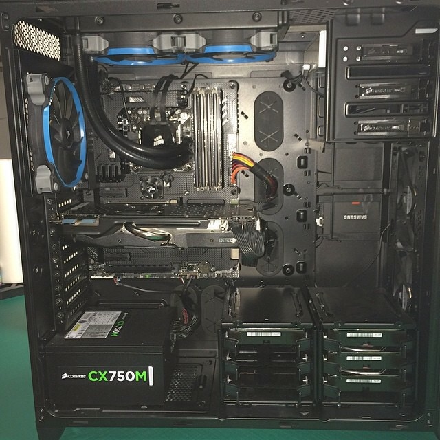

Please ignore the wiring mess. I never got around to giving it a proper wire tuck.
That ain't bad at all.
You should see mine. I had to replace the PSU about 3 years ago. I spent a good hour and a half routing all those wires back when I first built it, making sure everything was as neat and hidden as possible. It took me about that long to get it all back out so I could replace it.
