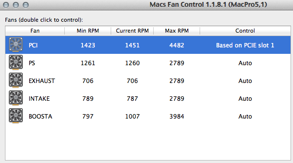

So now that I've upgraded my other computers fans, I actually am noticing the 1900RPM my PCIe fan is doing.
I have a MP 5,1 Hexcore, an unflashed GTX670 in slot 2, and an 5870 (from Apple) in Slot 1. I have the 5870 just for bootscreens (ugghhh). The 5870 is hooked up to the two 6-pins on the mainboard, 670 has external power.
I downloaded this app (mentioned previously) to manually control the fans.
I noticed that PCIe slot 1 is 47C while idle.

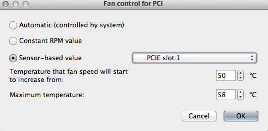

I actually have a SECOND 120mm fan in the PCIe bay I rigged up with a manual fan controller (hint: remove the HD from bay 1). I built a manual fan controller and I keep at around 1400 RPM as well.
So I used Macs Fan Control to change the Fan to respond to "PCIe Slot 1" at 55 C. The temperature bounces around between 47 and 55 and the application spins up quickly and immediately. You can actually broaden the range between min and max temp to make it more slow.
For some reason, it says the minimum RPM of the fan is 1423... I read in another thread it should be 900? Is this true with the 5,1 ?
This did it. My fan is now running at 1400RPM and it's quiet like a kitten. This had NO IMPACT ON TEMPERATURES.
I'm wondering if maybe the system knows something I don't--like the actual GPU temperature.
Anyone know of an app that can give me a temperature on my GTX670 or 5870?

@slughead:
I think my defaults/minimums are 800rpm for PCI and 600rpm for PS. I actually run them lower than that with the script that follows and then I use Macs FAN Control to run/control the fans.

Holy poop that worked. Again, no effect on temperatures....
Why the heck does Apple put the Min fan speed nearly double of the actual min fan speed? Is it a result of adding a second card?
Hi slughead,
I just wanted to share further confirmation of my fan speeds, in response this earlier question of yours. I have the same model MP as you and always get around 800/600/600/600/856 at idle (when the fans are behaving properly). This matches the minimums listed by smcFanControl. I've attached a lil' screenshot of my exact RPMs.

You can use "Macs Fan Controller" and change the PCI expansion fan from "auto" to "sensor" based. I would suggest to base it on "PCIE ambient". I have mine set to start at 36 C with a max at 60 C.
Thanks.
