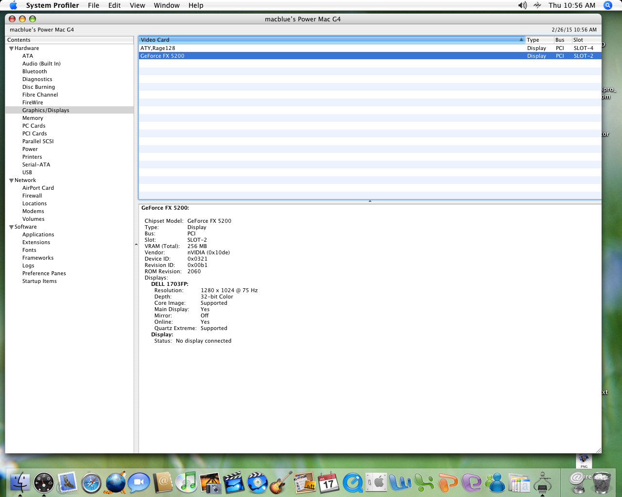

I'm happy to report that I was finally able to successfully flash my PCI 5200...with my impending X-serve arrival I needed at least a decent performing PCI video card, so I think this will serve in that role nicely(at least for me to get the computer set up for how I intend to use it).
I ended up locating an older version of NVFlash-version 4.5.something I think-and it worked perfectly.

Does CoreImage work on PCI cards, or the 5200?

Edit: I see the image says it supports CoreImage but I didn't think that works on PCI vards due to the limit of the PCI bus.
Core image works to the extent that the 5200 is capable-i.e. it gives ripples when adding a widget to the dashboard, but won't give the translucent menu bar in Leopard(the AGP FX5200 as well as the built-in 5200 in the iMac G4 and 12" Powerbook have these same capabilities/limitations)
