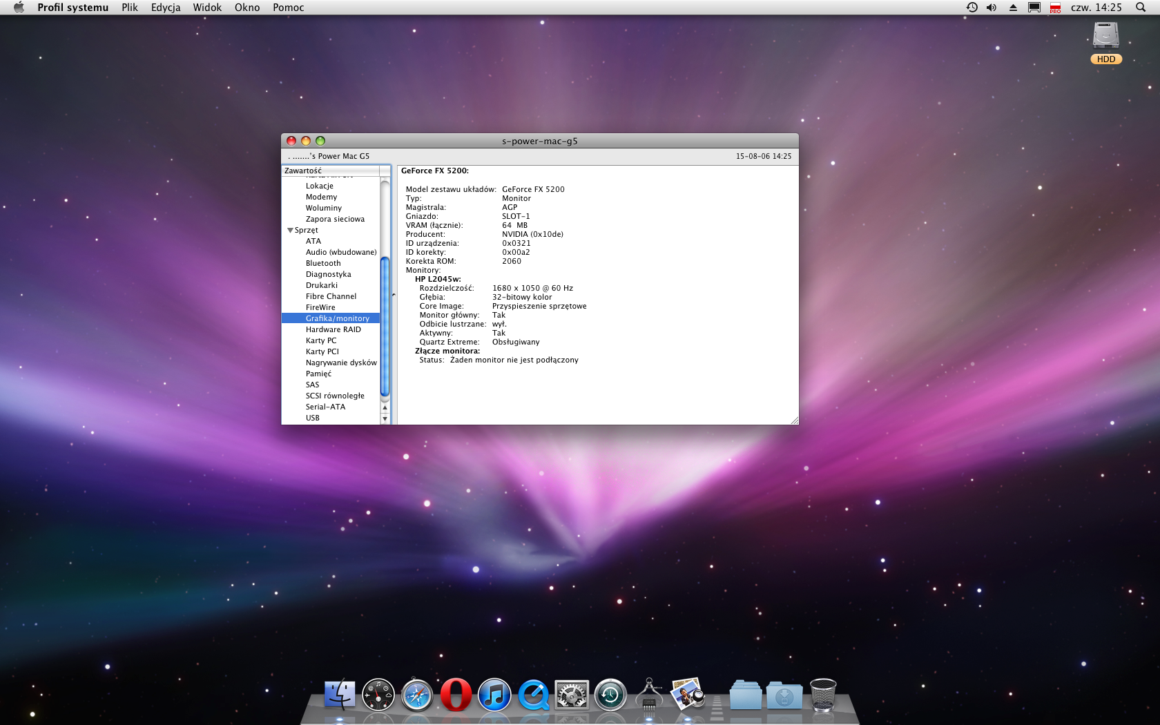

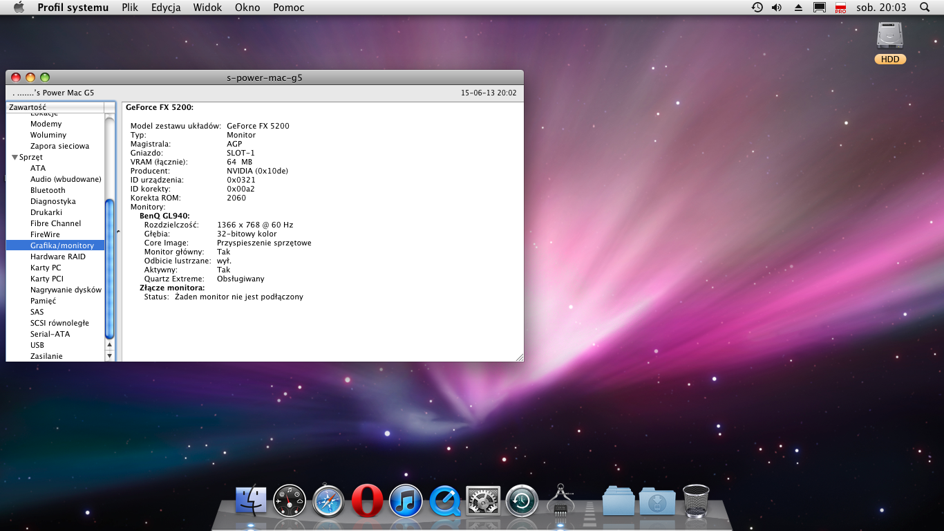

Hi all!
long long time... ;o)

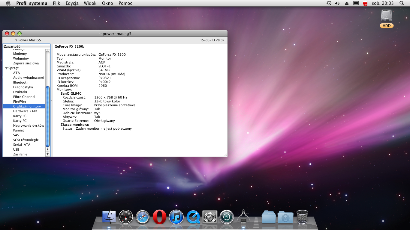

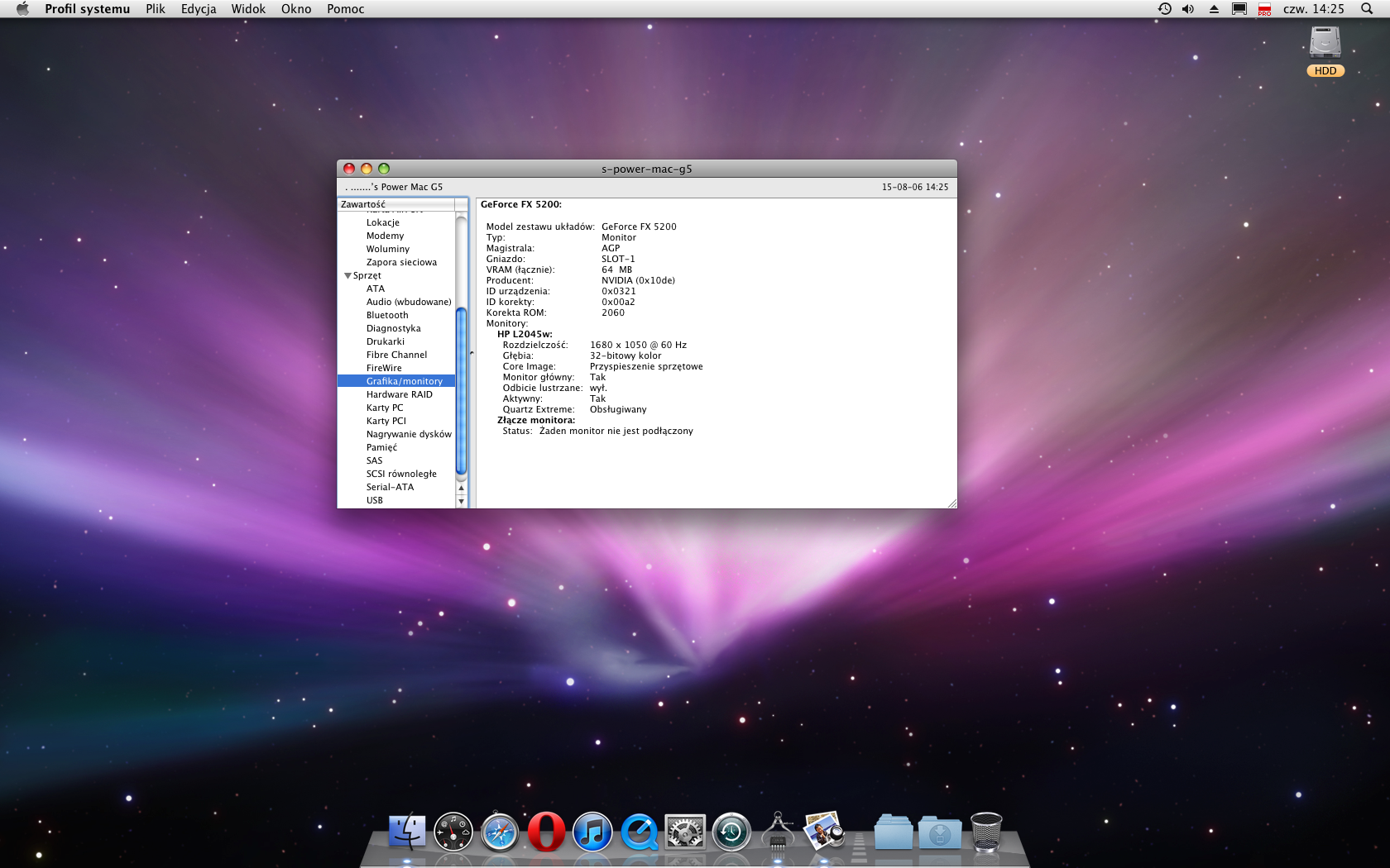

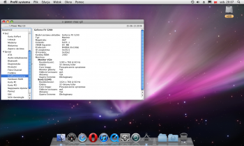

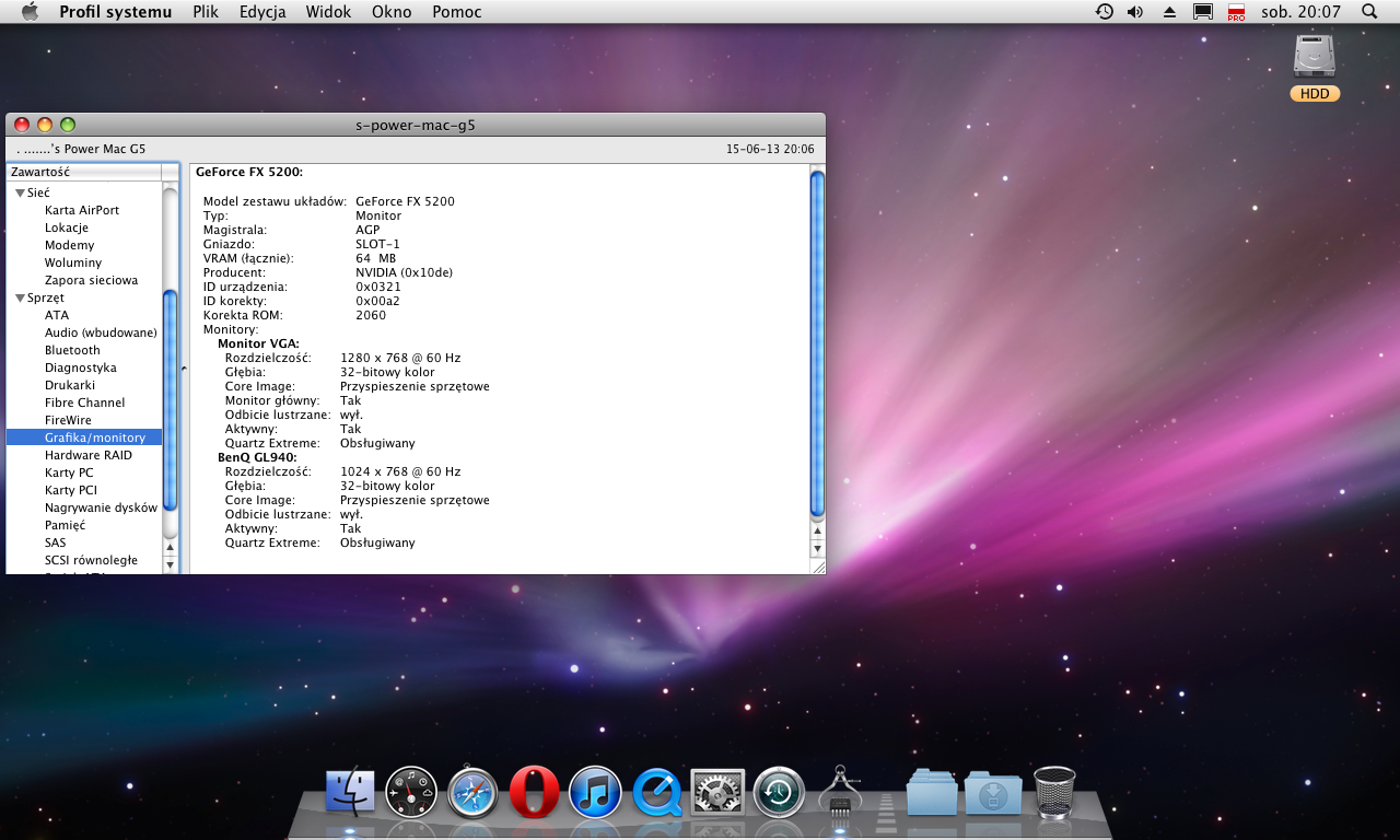

Finally I found model FX5200 with fully working DVI after flash (of course I use this trick in bios we said before)...
This card it is model Albatron FX5200EP 128MB.
Nice to see FX5200 with working DVI... it works good by DVI on 19-inch led Benq (1366x768) and on 20-inch lcd HP (1680x1050)
Minus is that this card is 64-bit so after flash System Profiler shows 64MB (similar like with Radeon 9200 64-bit models)...
How to check if any of FX5200 card have fully working DVI?
Simpy test it before in PC - if it giving needed resolution (for example 1680x1050 or more) by DVI so after success flash will be ok too... if not forgot about DVI...

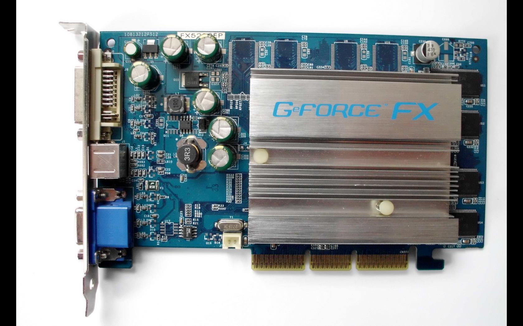

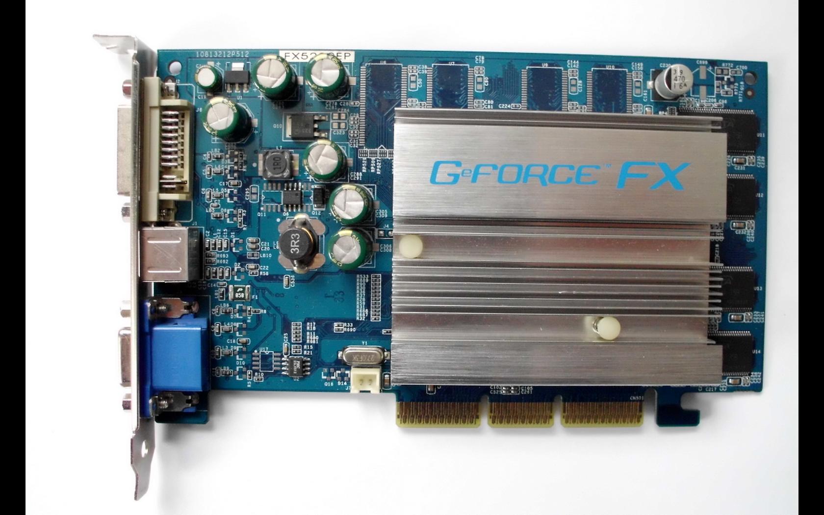

Here it is photo of this card:
