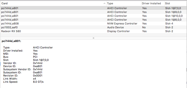

...and one more question just by curiosity: What is the 9,0,0 behind SLOT-2 (in the screenshot) stands for?

Simplifying a little, Slot-2 9,0,0 is the address of the card in the PCIe space when you use a switch.

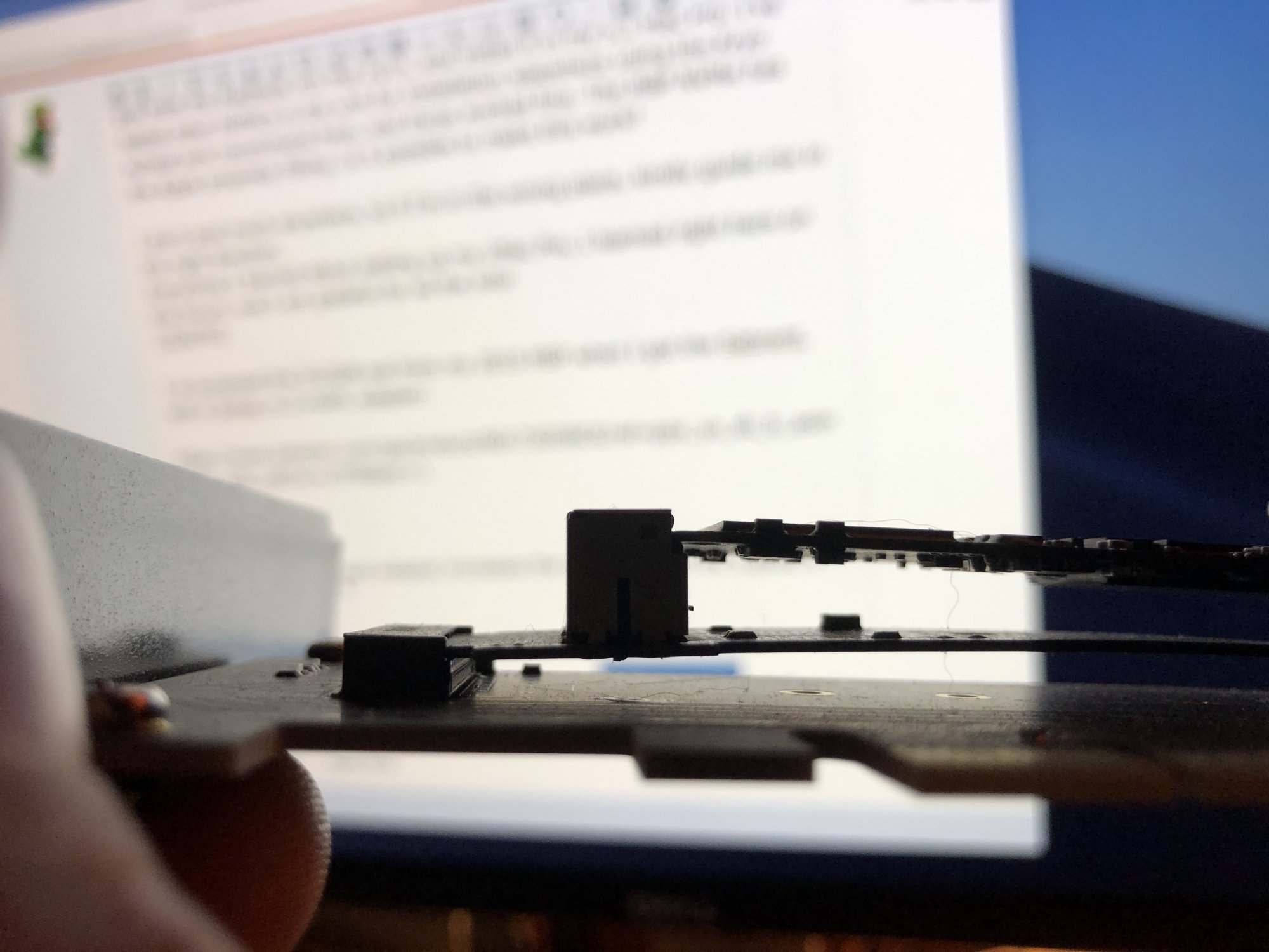

I re-purposed the 512GiB ssd from my 2015 MBP when I got the Sabrent, with a Sintech m.2>12+16 adapter:
https://www.amazon.com/gp/product/B0173ODBCE/ref=ppx_yo_dt_b_asin_title_o05_s00?ie=UTF8&psc=1
Only caveat is that said adapter increases the vertical height by almost 9mm:
In this photo, the m.2>12+16 ssd adapter is attached to a EZDIY-FAB m.2>pic-e 4X adapter...
https://www.amazon.com/gp/product/B01GCXCR7W/ref=ppx_yo_dt_b_asin_title_o06_s00?ie=UTF8&psc=1
It gets the Job done 🙂
I do not know 'why' said m.2>12+16 interface needs-be twice the vertical height of the {industry} standard m.2 interface, that's just the way it (currently) is ;(
There are multiple options for the m.2>pic-e variants, and I've had no failures with any of the ones I've purchased/used.
hth
