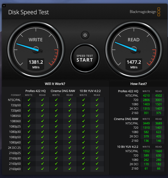

How are you guys able to hit more than 2,000 tp 3,000 R/W for NVME? I only can manage to hit 1,500 or less with my nvme EX950 1TB? Thanks.
I think the challenge here is to get more than the bandwidth offered by a single 4 lane PCI 2 slot, i.e .purchasing an exceedingly expensive adaptor (10x cost of a 4 lane) with a PCI switch that does not rely on PCIe bifurcation to give you double the lanes or more and finding a spare x16 or x8 slot to plug it in to achieve what are already pretty super fast speeds. You can do the calculation based on the advertised speeds for PCI 2 vs. 3 and what the NVMe's advertised performance is. I guess you could also try and software RAID 0 across 2 cheaper 4 lane cards for significantly less money if you have the free slots to harvest the performance of 2 x 4 lanes.

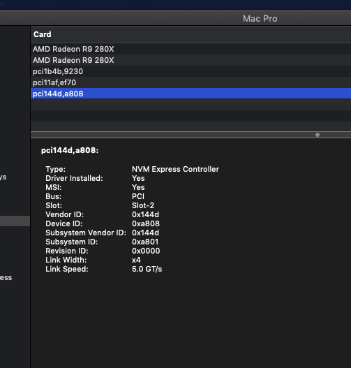

When I Insert second Samsung 970 EVO M.2 the carde is not recognised by Mac pro ?
Is it Bifluctration incopatibility problem or something else?
Maybe I havent enough power?
The card is recognised as X4 PCIe not x8 PCIe ?
Any advice will be healpfull.

Here is Result with one 970 EVO
If the card doesn't have a PCIe switch then it is bifurcation and you can only use one NVMe.
macOS System Information.app does not show PCIe switches so you need to use ioreg or pciutils to find out.

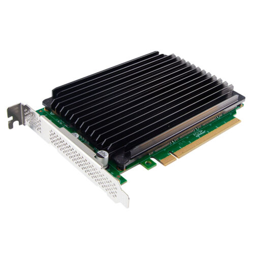

New candidate on ebay
NVMe SSD Adapter Card, PCIe x16, (4) M.2 NVMe connectors, NV95NF
What do you think about this one?

Thank you for response I have
Looking at the pictures of the cards (Aliexpress for the first one) they obviously have no PCIe switch, which means they require bifurcation to support more than one blade.

If you want to use more than one blade in a single PCIe slot, then you need to spend more than $100 to get a card with a PCIe switch for the Mac Pro or any computer that doesn't support bifurcation.
