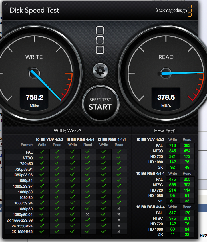

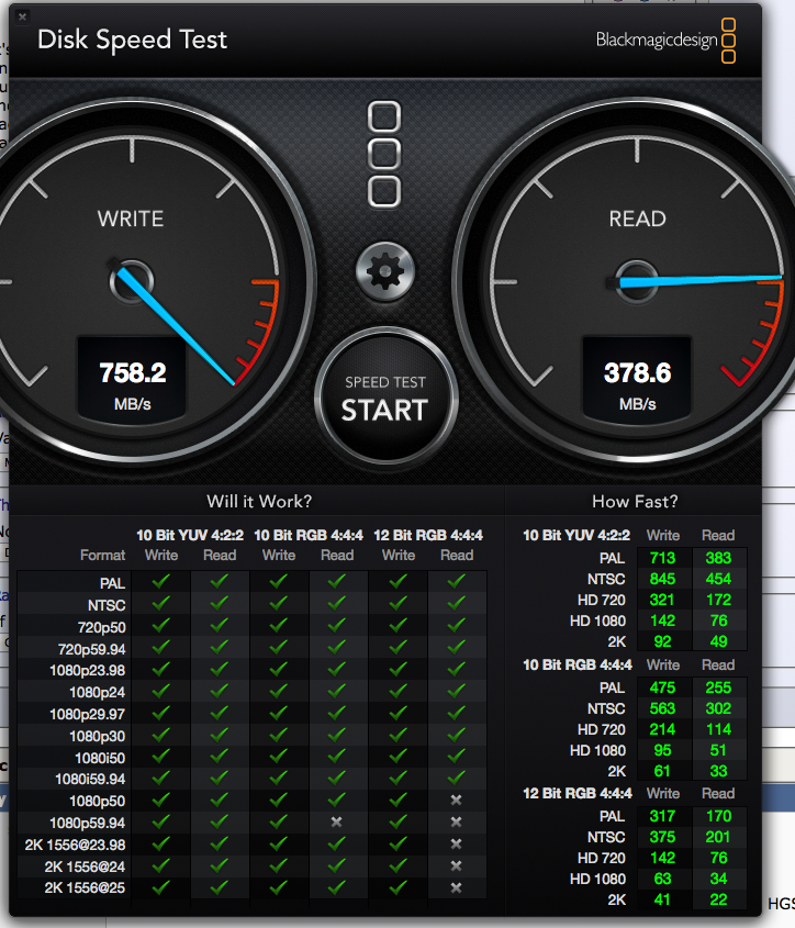

I did a test with the Write Back setting selected. Pretty interesting.
I just setup my Pegasus2 R4 is in RAID5 .. 4 x 2TB - Hitachi 7K4000 - HGST HUS724020ALE640
Stripe Size: 256KB
Sector Size: 512 bytes
Read Cache Mode: Read Ahead
Write Cache Mode: Write Back
Updated the firmware to 5.04.000.18
Plugged into a nMP 6 core over TB2. Only one monitor hooked up atm, on TB bus 1, P2 r4 is on TB bus 2 AFAIK.
Tested with Blackmagic and AJA.. I used the first Blackmagic numbers, because I think the cache comes into play in the 2nd round which spikes the numbers into the 600 even 700 range. So my numbers below are avg.'s after 1 BM, and 2 AJA tests.
I'm getting about 465 MB/s write (+270), and 340 MB/s read (-100) compared to with the "write thru" setting enabled.
Does the P2 raid controller have a battery backup, to negate the need for write thru?
I need to think about my avg. use case. If I would rather have and extra 100 mb/s read, or a plus 270 mb/s write?
I think this raid will mostly be media and bulk storage (read).. and scratch disks will be on the internal 2x-4x faster 1TB SSD.
