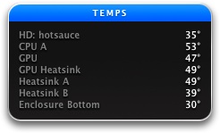

Mine:
Hey alphaod,
thank you for your reply, especially the answer to my 3rd question sounds pretty interesting / logic. Also thanks for the iStat screenshot - those temps are almost the same on my MBP (+ - 2°C)
I would appreciate it, if anyone else would share some screenshots of their own Penryn MBP when it has been sitting idle for a couple of minutes.

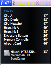

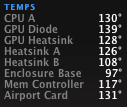

these are the temperatures when my 2.6ghz mbp is at about 90% idle, is it normal???, I think it is too hot...😱

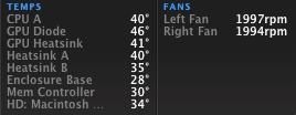

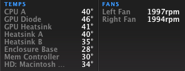

. . . 12.5 hrs walltime; fancontrol installed & active - min set at 1500rpm.

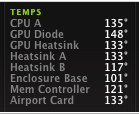

I finished watching a 2 hour movie in iTunes 5 minutes before I took this pic. The temps are what I usually average on a day to day basis...
90% idle? Do you mean 10% used? Also on both cores? The temperature seems about right-- 135F~57C. I usually manually set my fan to 6000RPM to cool the computer down if I need to.
