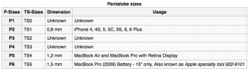

Like I've said earlier, I have tried P2 and P5 from my iFixit tools, neither worked. P2 is .8mm that you use on iPhones, P5 is 1.2mm that are used on MacBooks(I've attached a table of sizes from http://en.wikipedia.org/wiki/Pentalobe_screw if you don't believe me). Those sold on amazon that are compatible with iPhones should be P2. The one that bandgate guy provided is also for iPhone, so it should be a P2, but somehow it worked in his video, my explanation is, since the screwdriver looks cheaply made, the size of the tip might not be that precise.
My suggestion for those who want to try, it is most likely a P3 or P4 would work.
Added: I suspect the "pentalobe driver #2" in the official document might be TS2, or P3. The only way to prove my theory is to find another document in which the TS4, or P5 screwdriver is called "pentalobe driver #4", but I've got no results from googling.

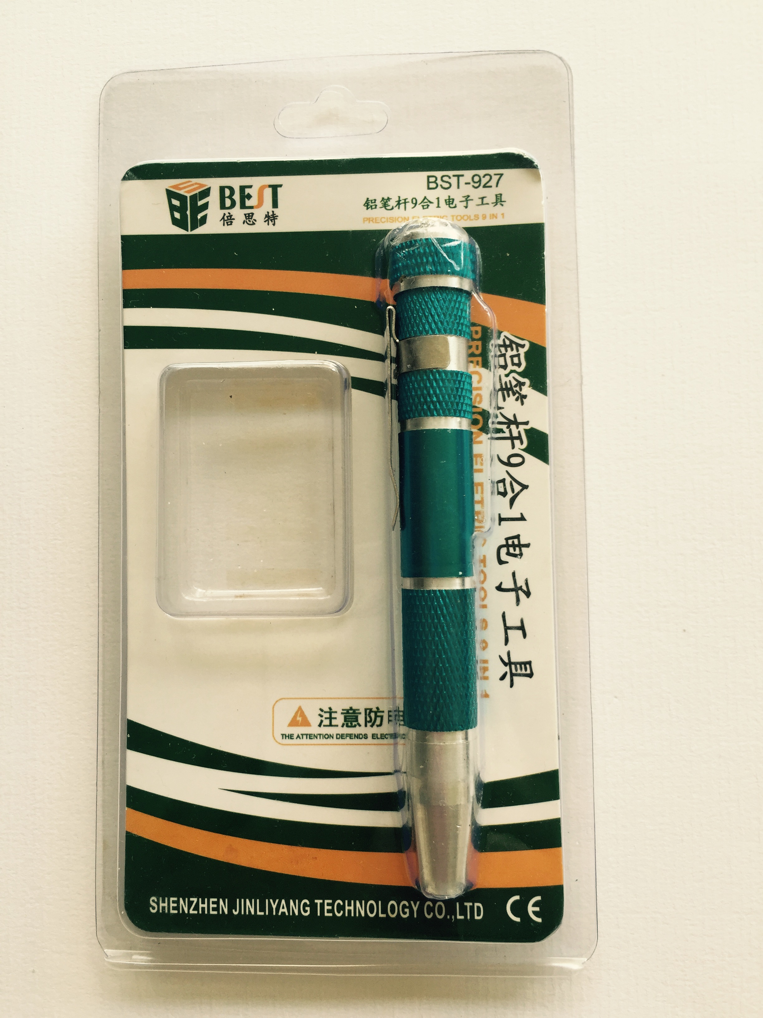

Just got this kit in from Amazon and it had a bit that fit. Replaced band no problem.
This is the kit http://www.amazon.com/gp/product/B00D9NQHU2/ref=oh_aui_detailpage_o00_s00?ie=UTF8&psc=1
The bits are so tiny even with my reading glasses I could barely make out that was a pentalobe. So I'm gonna say 1.2mm is the one.

Pentalobe sizes
P sizes TS sizes PL sizes[11] Dimension Usage
P1 TS0 Unknown
P2 TS1 PL1 0.8 mm iPhone 4 (Late), 4S, 5, 5C, 5S, 6, 6 Plus, 6S, 6S Plus
P3 TS2 Unknown
PL2 0.9 mm Apple Watch Band
P4 TS3 Unknown
PL3 1.1 mm
P5 TS4 PL4 1.2 mm MacBook Air and MacBook Pro with Retina Display
P6 TS5 PL5 1.5 mm MacBook Pro (2009) Battery - 15” only. Also known as Apple specialty tool 922-9101
PL6 1.6 mm
The iFixit set only includes P2, P5 and P6.

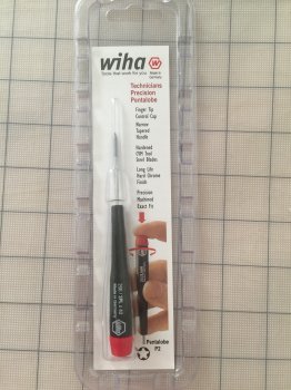

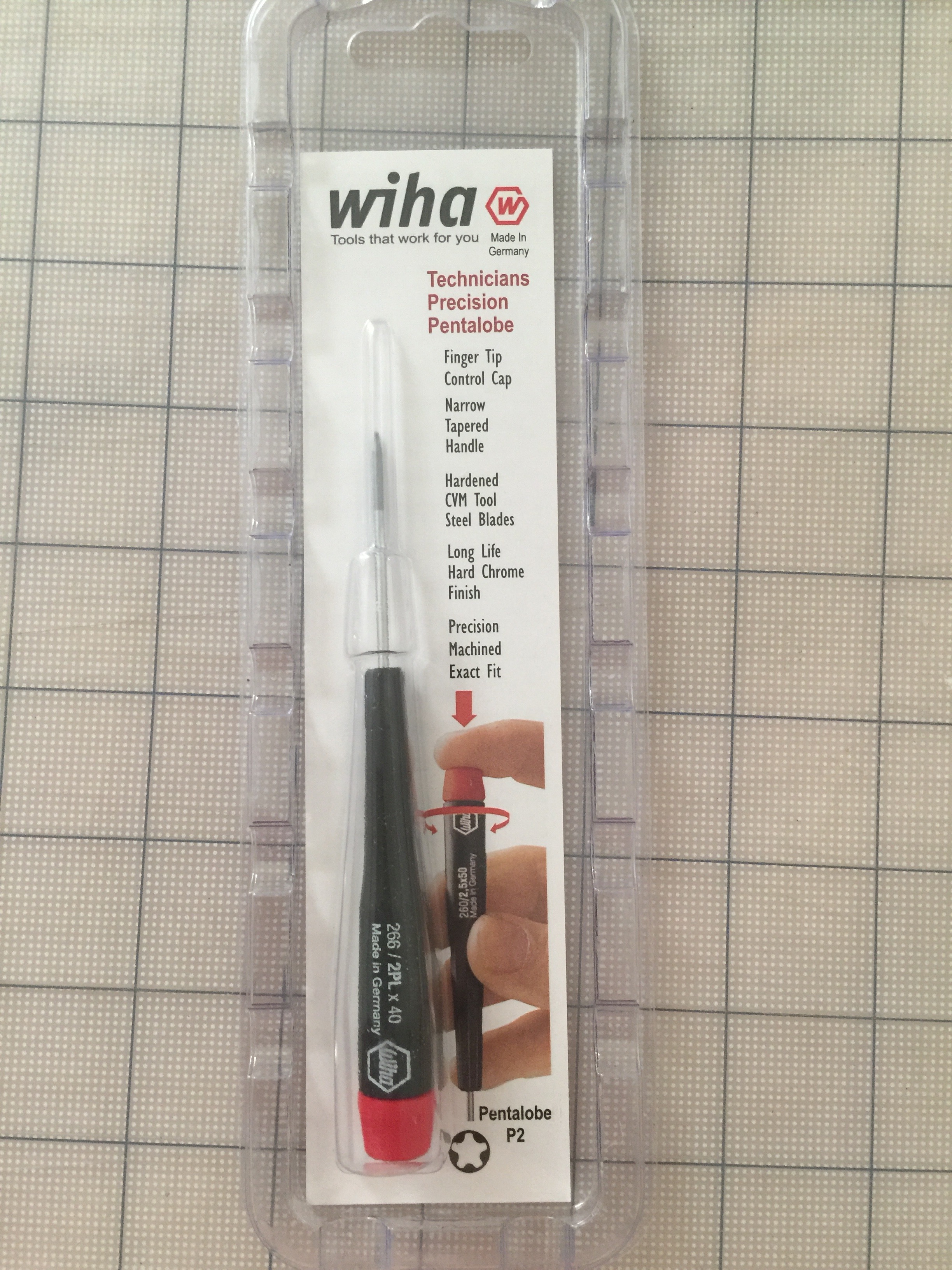

The markings on it read, "266 / 2PL x 40".
That was me posting in the link above. And yes the screwdriver pointed to on the KC Tools website works. No need to buy a whole kit and spend a lot. $7.63. Man those little screws are buggers though, so tiny. Here's a photo I just took of it. Can't say enough good things about the company I bought it from BTW. Very pleased and happy to recommend.
http://www.kctoolco.com/wiha-26762-precision-p2-pentalobe-screwdriver-p/26762.htm
BTW I picked up Apple's recommended Loctite 435 (Zoro Tools on eBay sells a 20g bottle, http://www.ebay.com/itm/381484041509 ) so I can add my bands on 3rd party classic adapters. I can see why you need it to keep those little screws in securely.
