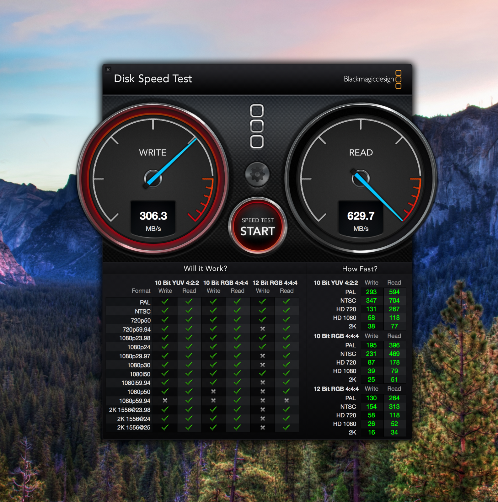

  • Yes I have a "Fusion drive" but I still did the Blackmagic test

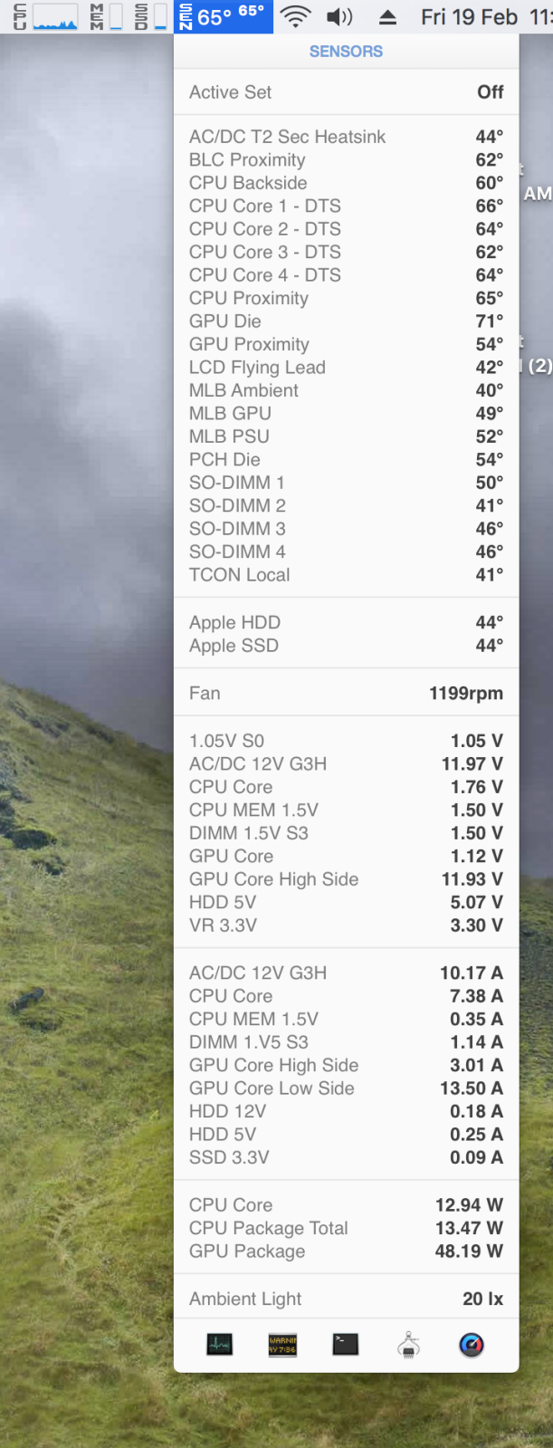

Get iStat Menus, as that will report the CPU temperatures.

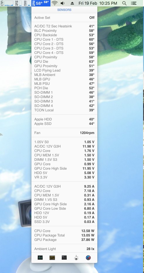

What should I be looking at, you said about the CPU temp what there are a couple of different CPU temp options here.
I use the basic CPU which is being display at 65c. Is that temp at idle or were you using some intensive apps when you snapped that picture. Those temps are higher then I see. My idle temps are in the low 30s.
If 65c is your idling temperature then you might have a problem, for that is right on the border for being safe. When I used to build my own computers I look at 150F(66c) as being the border limit for a computer under load. I learn one fix that you might want to check is dust, get a can of air and try to blow the dust away. Tip, make sure your computer is unplugged and when you start using the air press it away from the computer and don't get too close to it. Though with the iMac being enclosed it's probably unlikely this is the culprit, but it might be worth a shot.
P.S. One would think you would be hearing the cpu fan if it is at 65c?
Looking at your stats over again 71c for you GPU is high, it's probably a bigger problem than dust if that is the idle temperature.

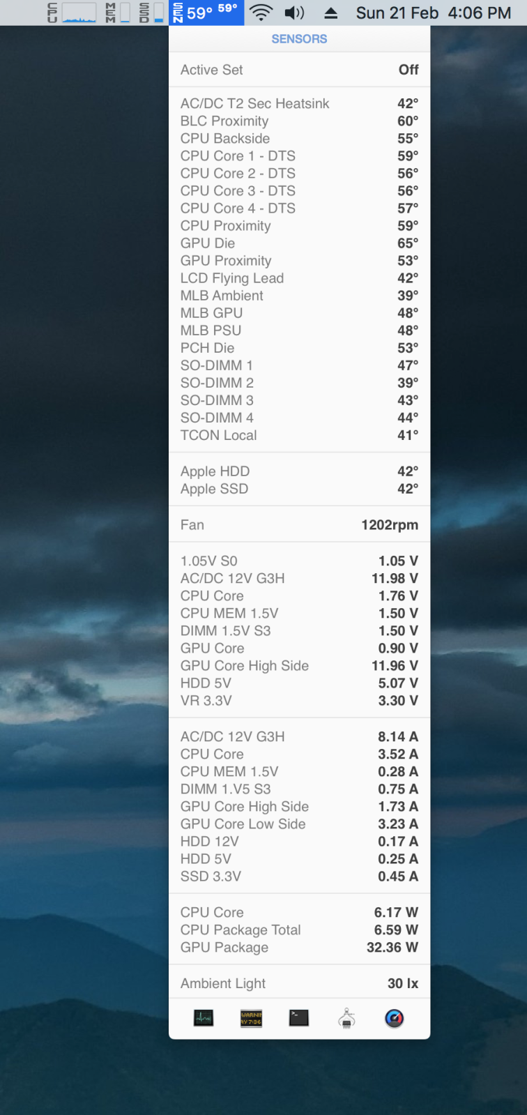

I don't remember what I was doing at that time, I think I may have been working with AE at the time. Here is a screen at ideal.
Still high
That's still very high

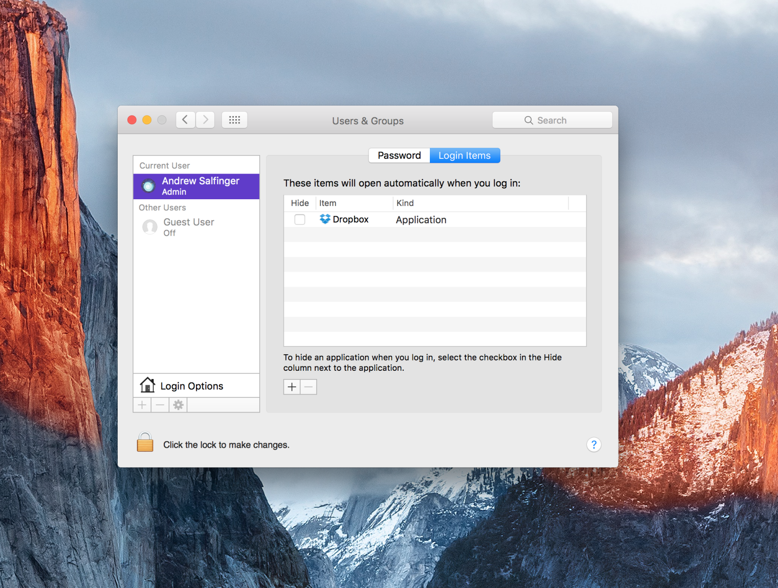

Why not go to settings/Users & Groups, and have a look in your account to see exactly what 'login items' programs/processes are set to start up and run in the background while you are logged in? Hopefully something there stands out.

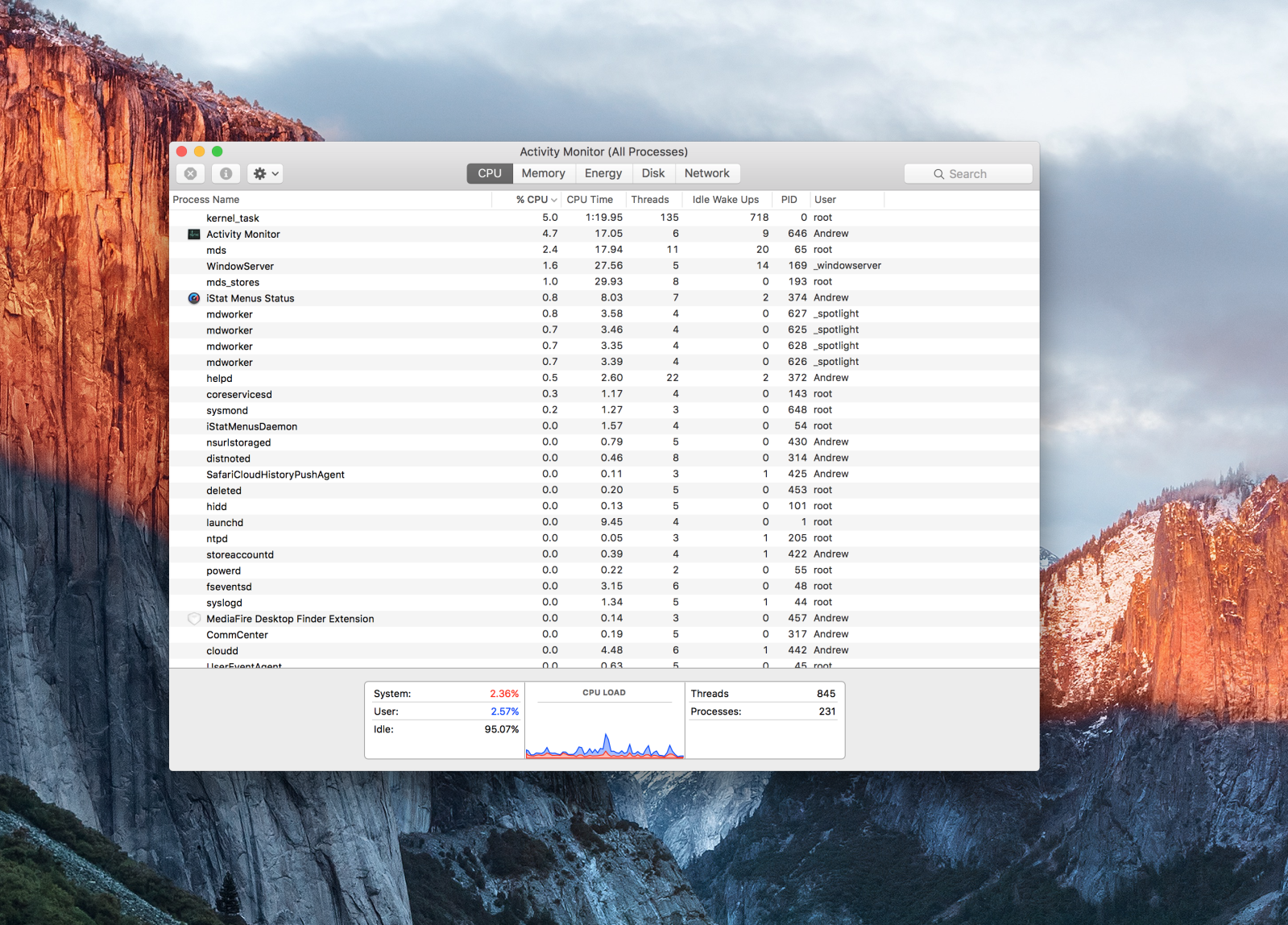

Also - you have been showing the TEMP of the CPU - but what about in activity monitor? What % of the CPU is being used when idle? As an example - my system is running at ~99.50% idle while just reading this site and typing this out with 5 other programs active in the background. (Mail/Safari/Terminal etc)

For 'login items' all I have there is DropBox:
As for activity monitor this is what it's showing while my computer is in idle:

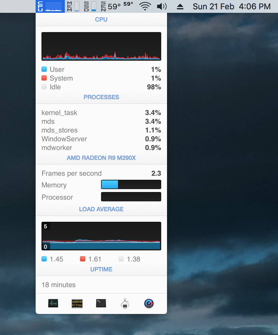

UPDATE: Here are some more screens from iStat (of the SEN and CUP (don't know if there any help))
You're computer is not showing a lot of activity. You can call apple and see what they have to say but I think its mostly that the model you have runs hot and will throttle once it gets too warm.
For giggles report back what the temps are when running the apps that start seeing the performance degradation, though I suspect you'll be see temps in the 90s.
