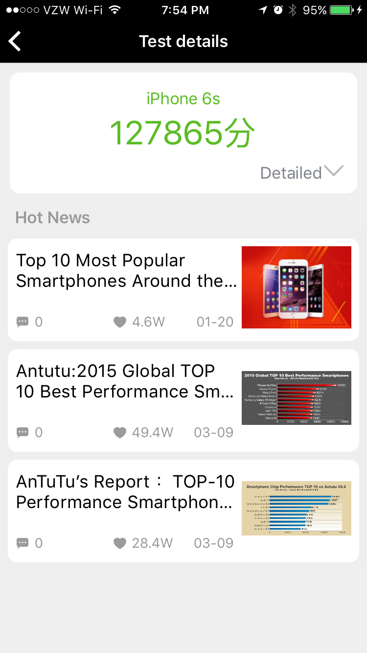

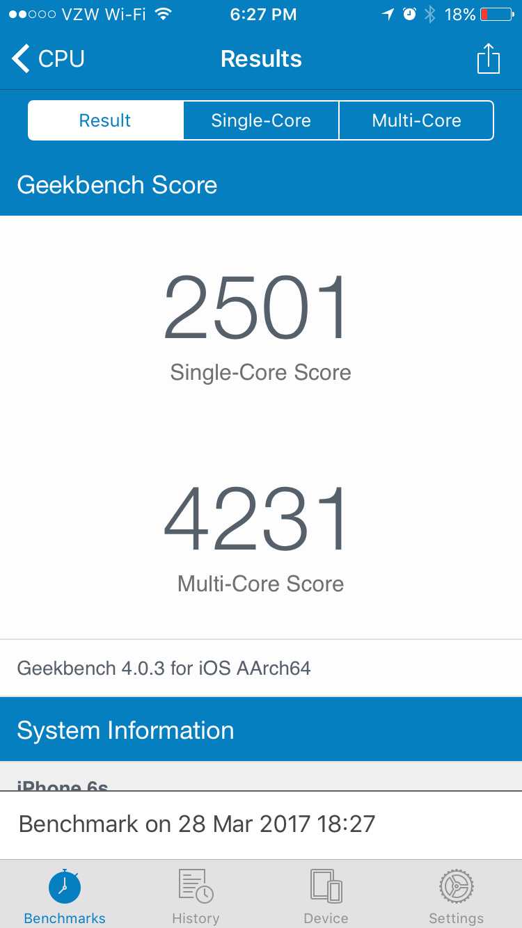

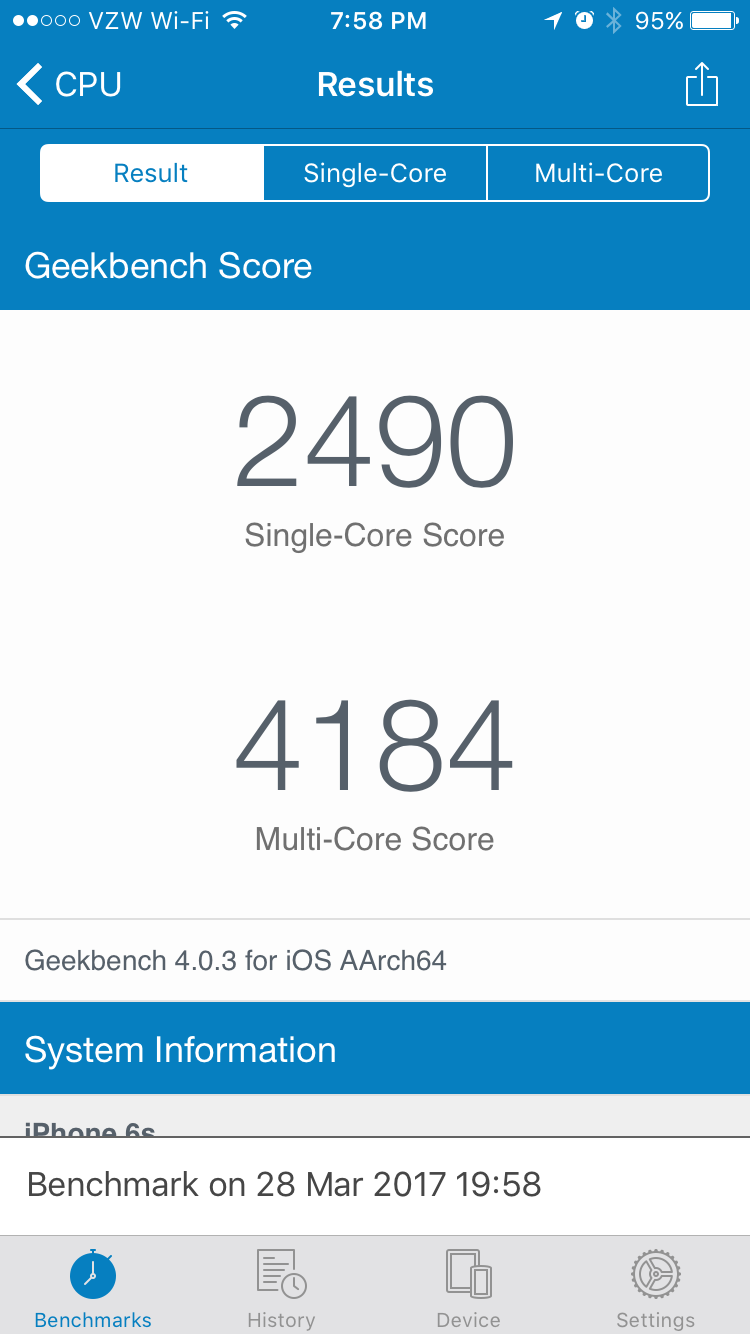

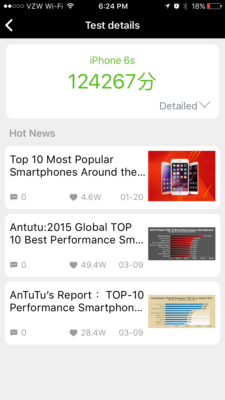

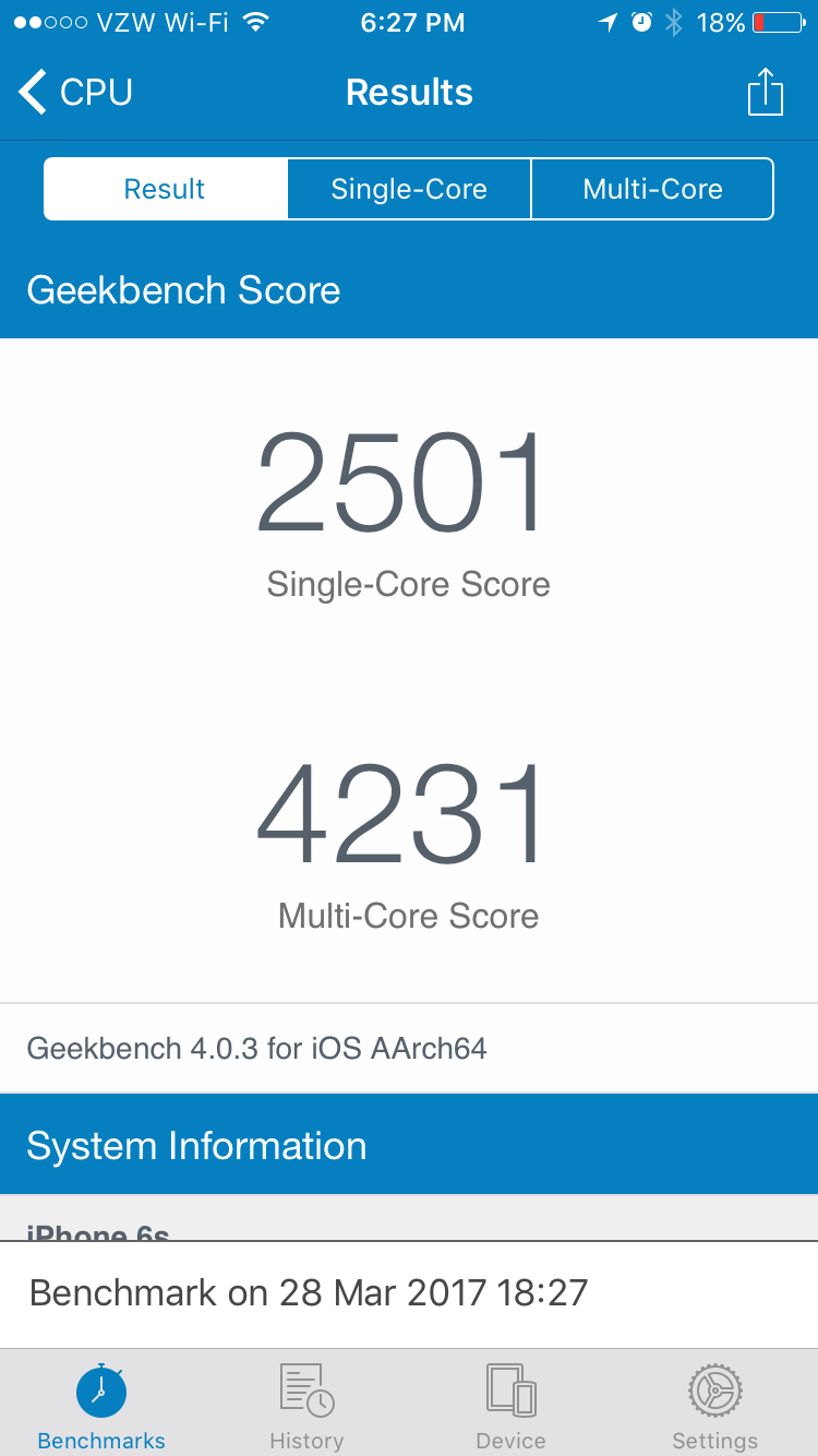

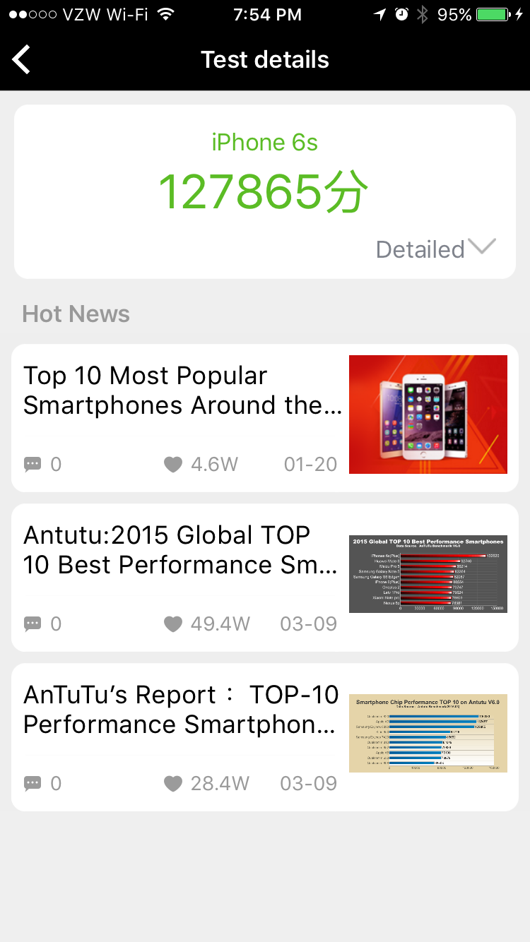

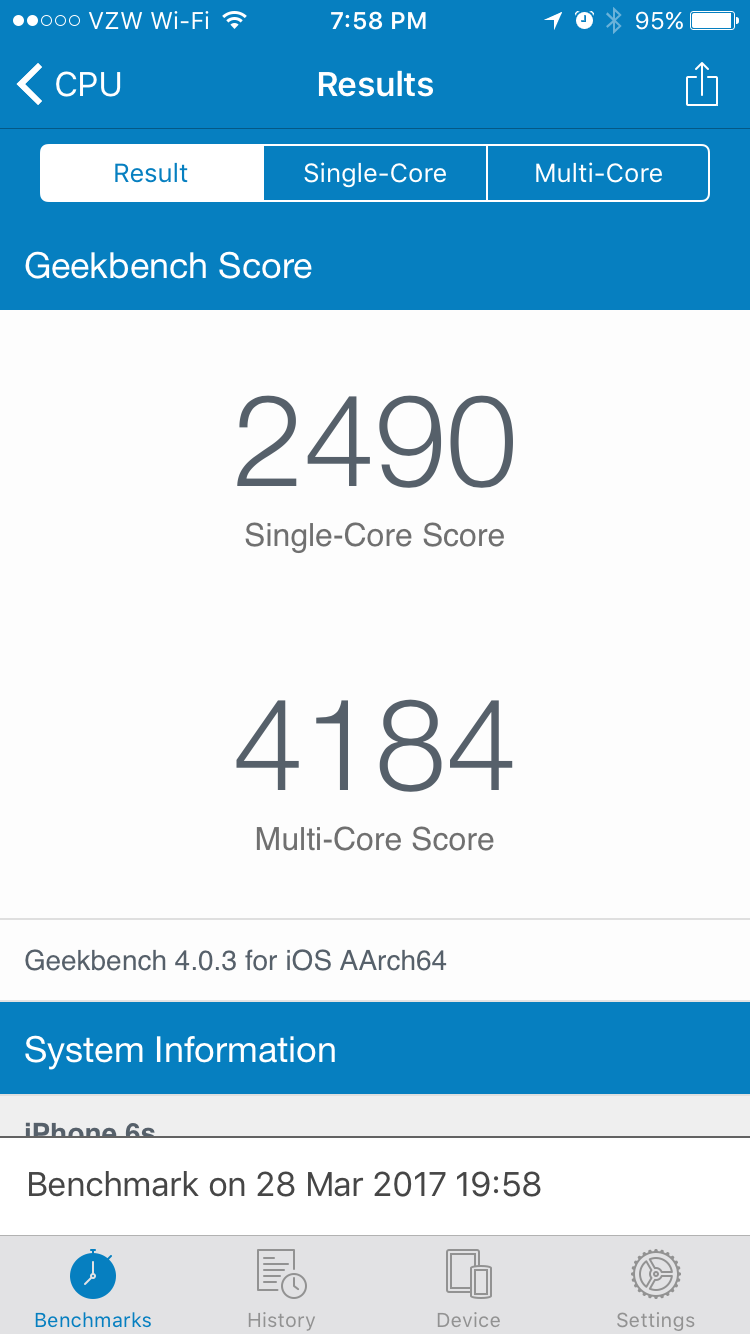

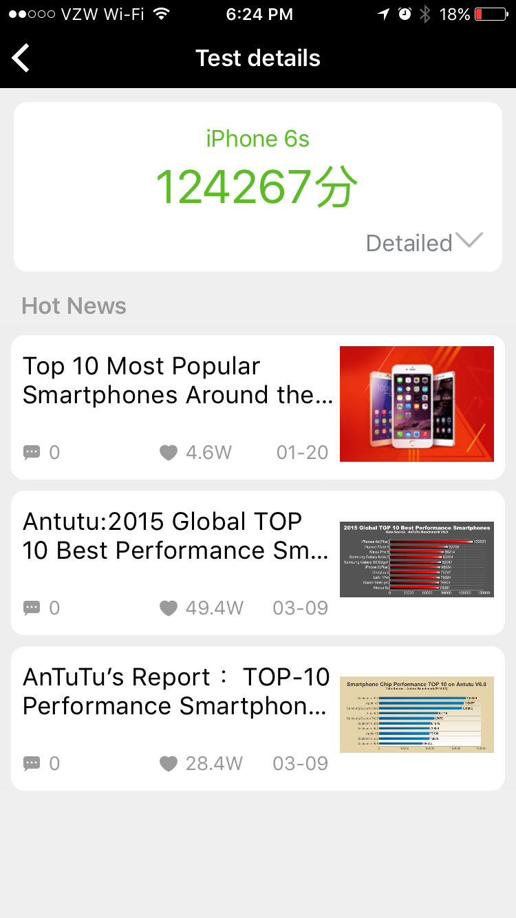

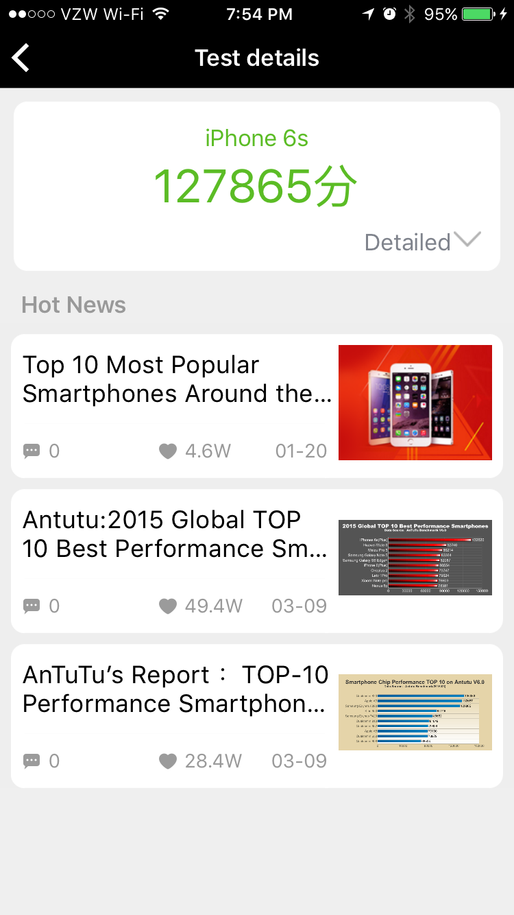

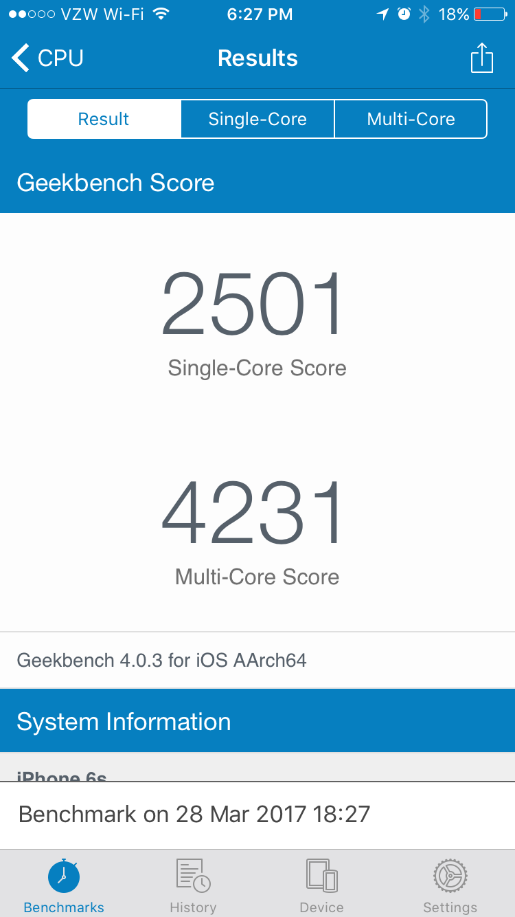

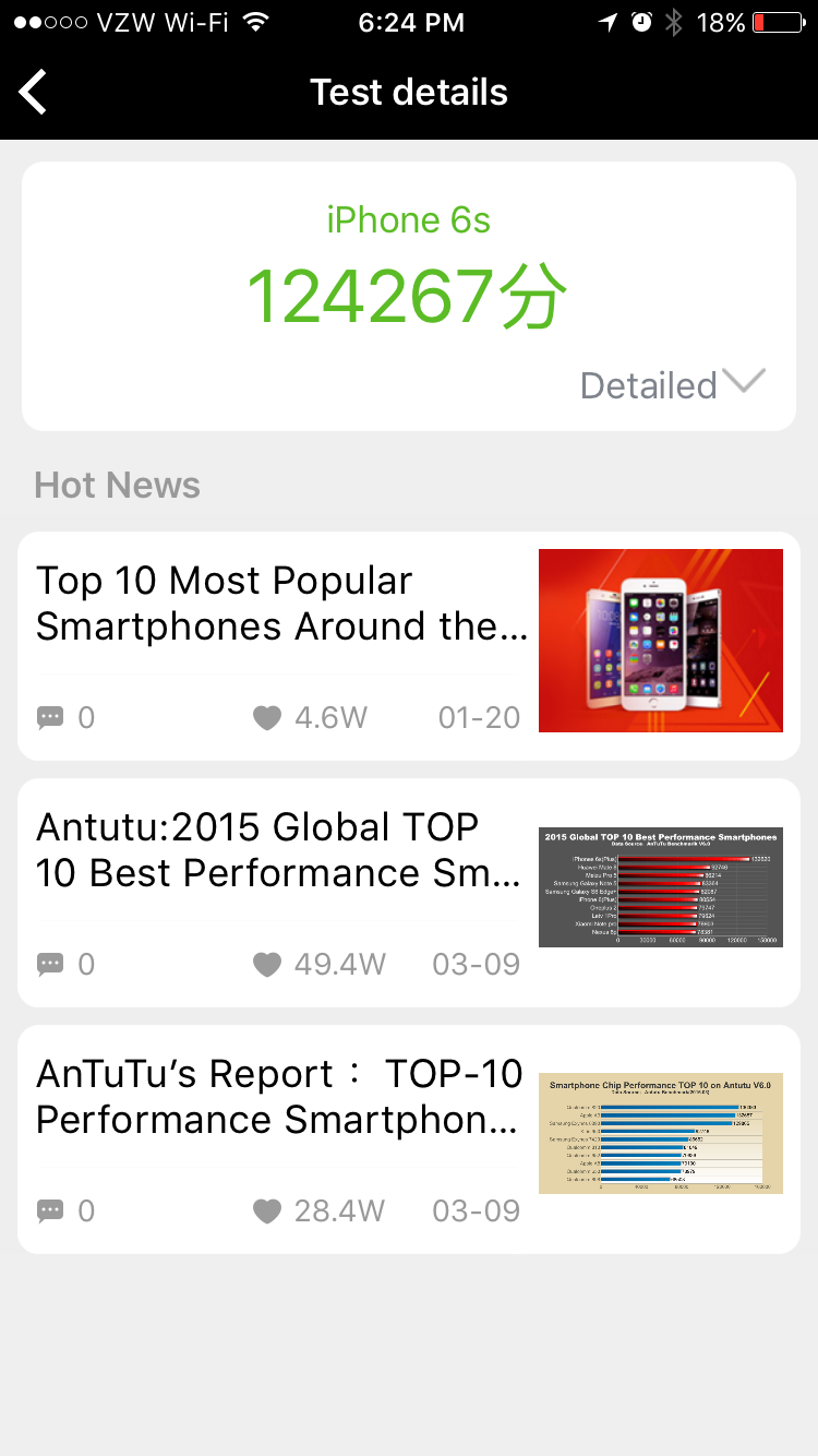

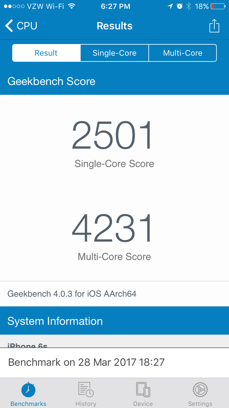

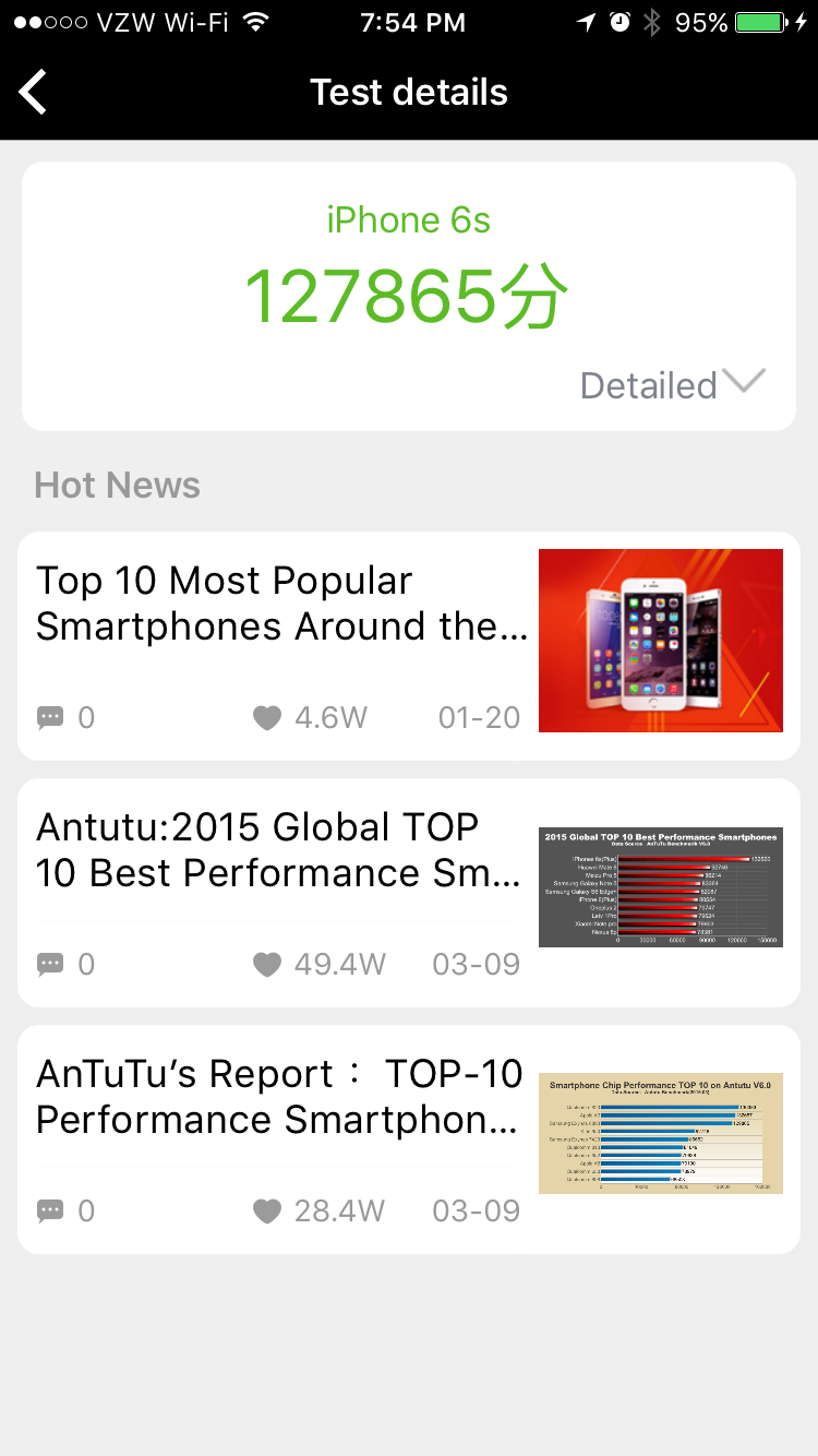

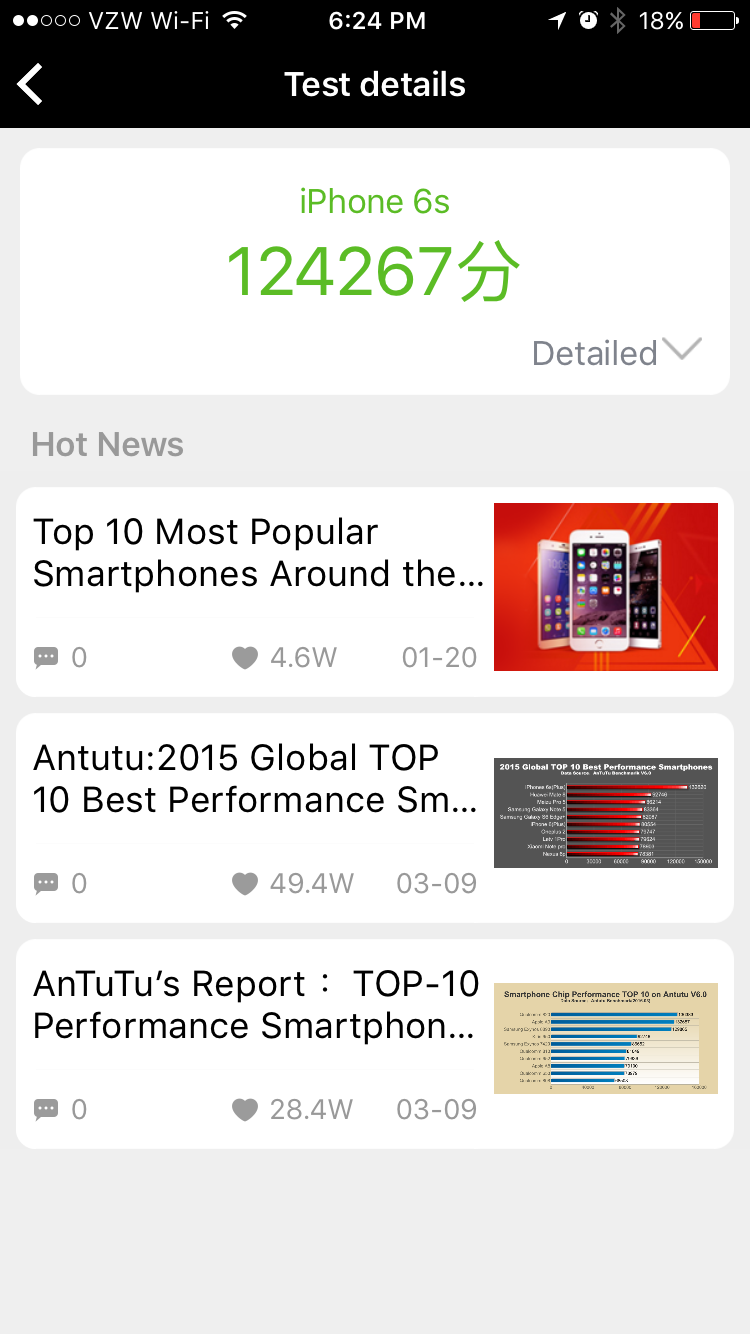

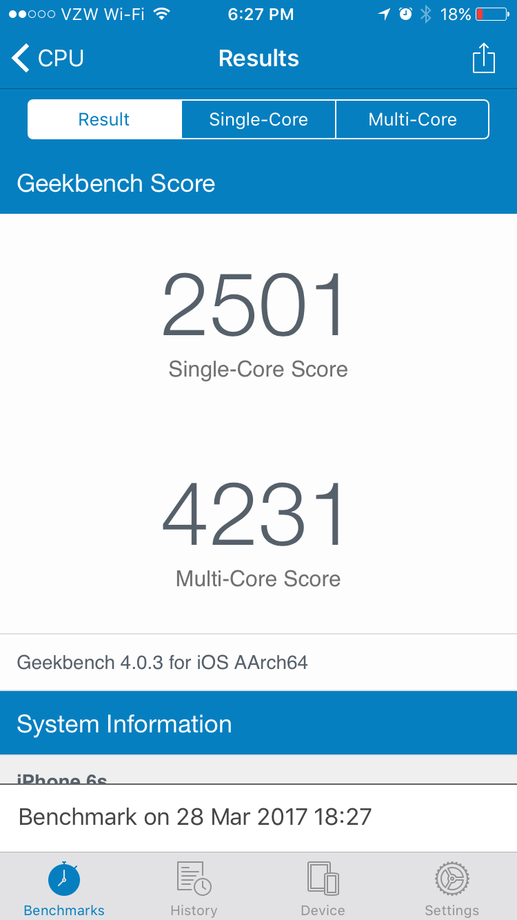

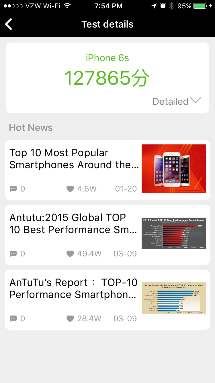

I can not sense or feel and differences between performance and battery life. And although I do not like synthetic benchmarks here are a couple.
iPhone 6S 64gb iOS 10.3, all apps closed in the app switcher except the benchmark app.
AnTuTu tested at 18% and then 95%
Geekbench 4 tested at 18% and then 95%
So I saw a better score with AnTuTu with higher battery percent. And a lower score with Geekbench 4 with higher battery percent.
If I run these test a dozen times I get a dozen results. The first AnTuTu score I got with a higher battery percent was 109xxx. Not sure what happened so I reran it and got the 127xxx.
So at least in synthetic testing (in a very limited quantity) there is no difference in performance based on battery percentage.
