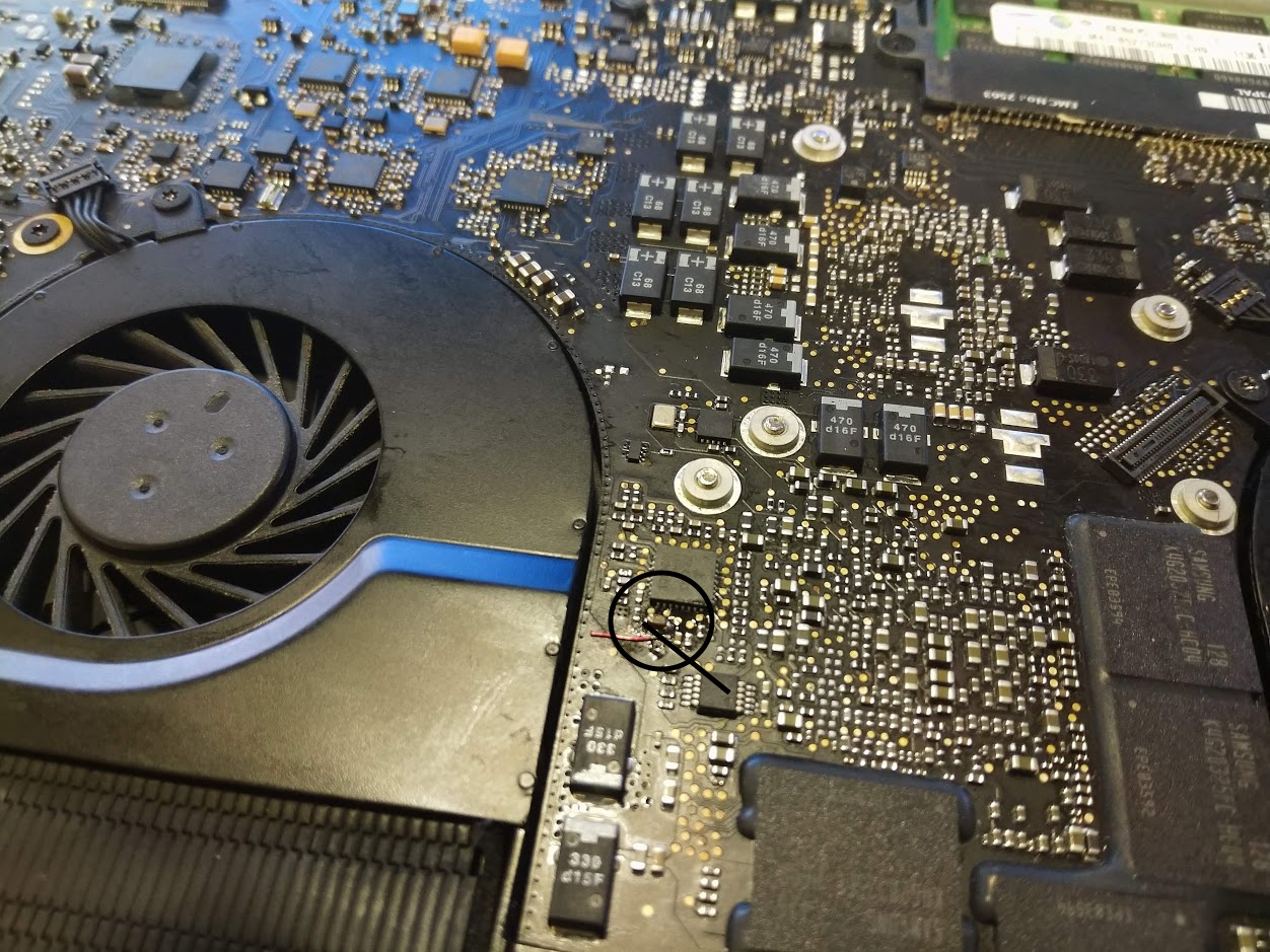

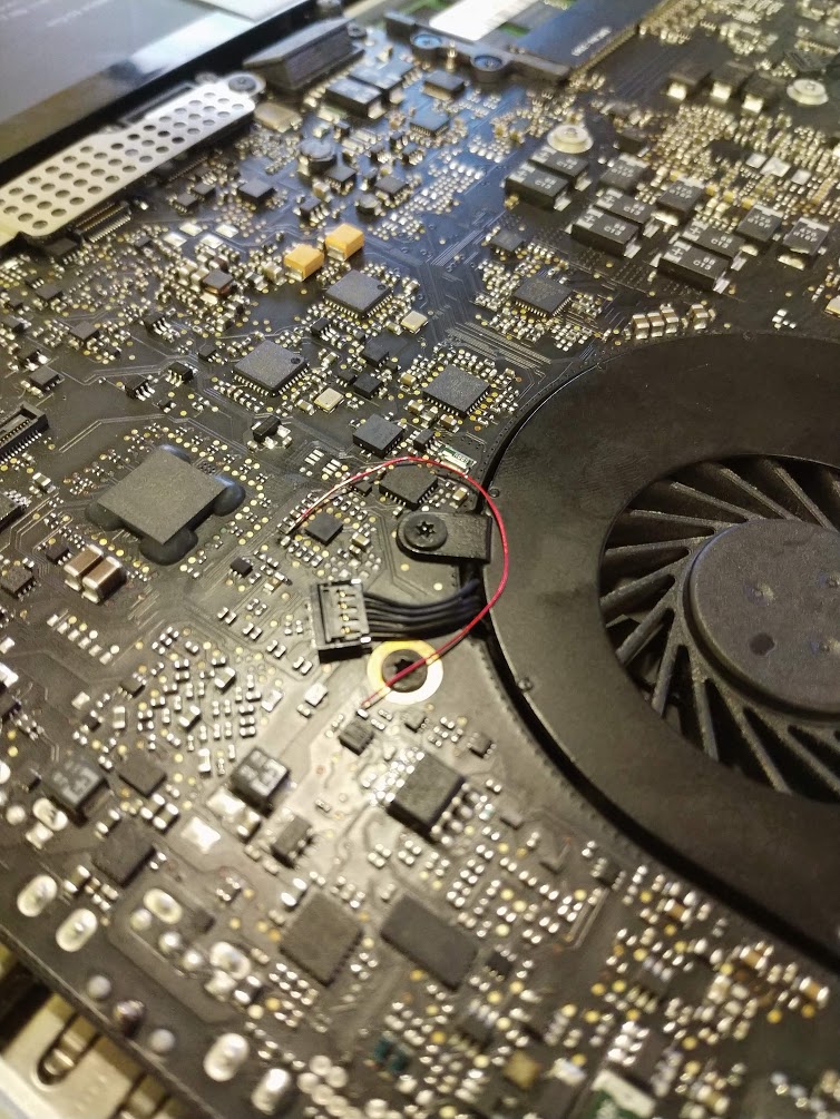

I may be the biggest idiot in the world, and I've done this on 2 prior 15" 2011s, but today I seem to have damaged the tantalum capacitor right next to r8911.
It literally has no solder points exposed anymore. I was in a rush \:
edit: the capacitor is damaged, NOT the traces!
Is there any way to bypass or use another one from somewhere else? I've run bridges on the 2 prior but didn't have any issue.
tl;dr: I really messed up my 3rd repair and have no backlight whatsoever. It does chime, though.
That shouldn't be an issue, as it's just part of the GPU VCORE circuit, which isn't even being used when this mod is performed. Have you verified that you've done all your wiring correctly?
No wiring has been done yet. In fact, I only did the wiring mod (using tiny enamel coated wire) on my personal machine for the brightness. The capacitor is being held in place just by a little extra solder right now but I guess isn't completing the circuit. I did bridge r8911 with that same wire and it is showing as OK on my multimeter.
Now I have a braindead idea as I am able to get into OS X Sierra's installer (single user) from USB. I can tell I'm in the terminal based on the caps lock key responds properly.
So I guess I may try the nvram stuff. Other than that, I have no video / screen / backlight at all. I'm going in blind I think.
EDIT: I did my idea above and it WORKED. screen powers on and I'm good to go. Installing Sierra now.

big success on my 3rd mod. honestly that worried me quite a bit as I thought I threw away $150 for another machine, lol.
Got the sleep mod done as well. High Sierra is ready for action!
Even people like me who do this 10 times a year makes newbie mistakes (^:

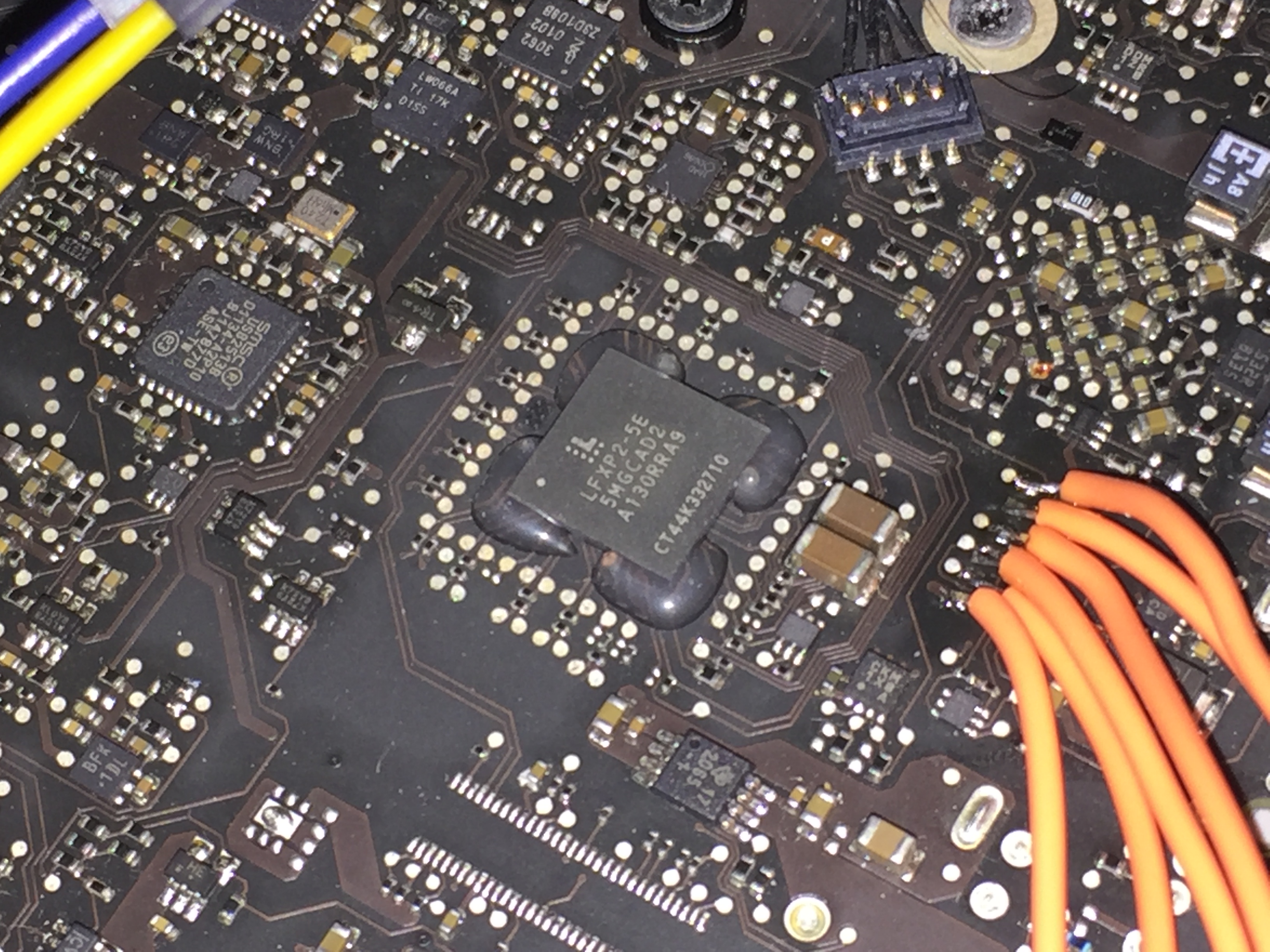

At long last, I have finally done it... the ULTIMATE solution to permanently disabling the dGPU on one of these machines: Custom firmware for the gMux IC! No backlight brightness control implemented yet, but everything else works perfectly! The system runs great with NO hardware modifications, NO special NVRAM/EFI variables set, NO OS modifications, and the dedicated GPU PERMANENTLY disabled!
