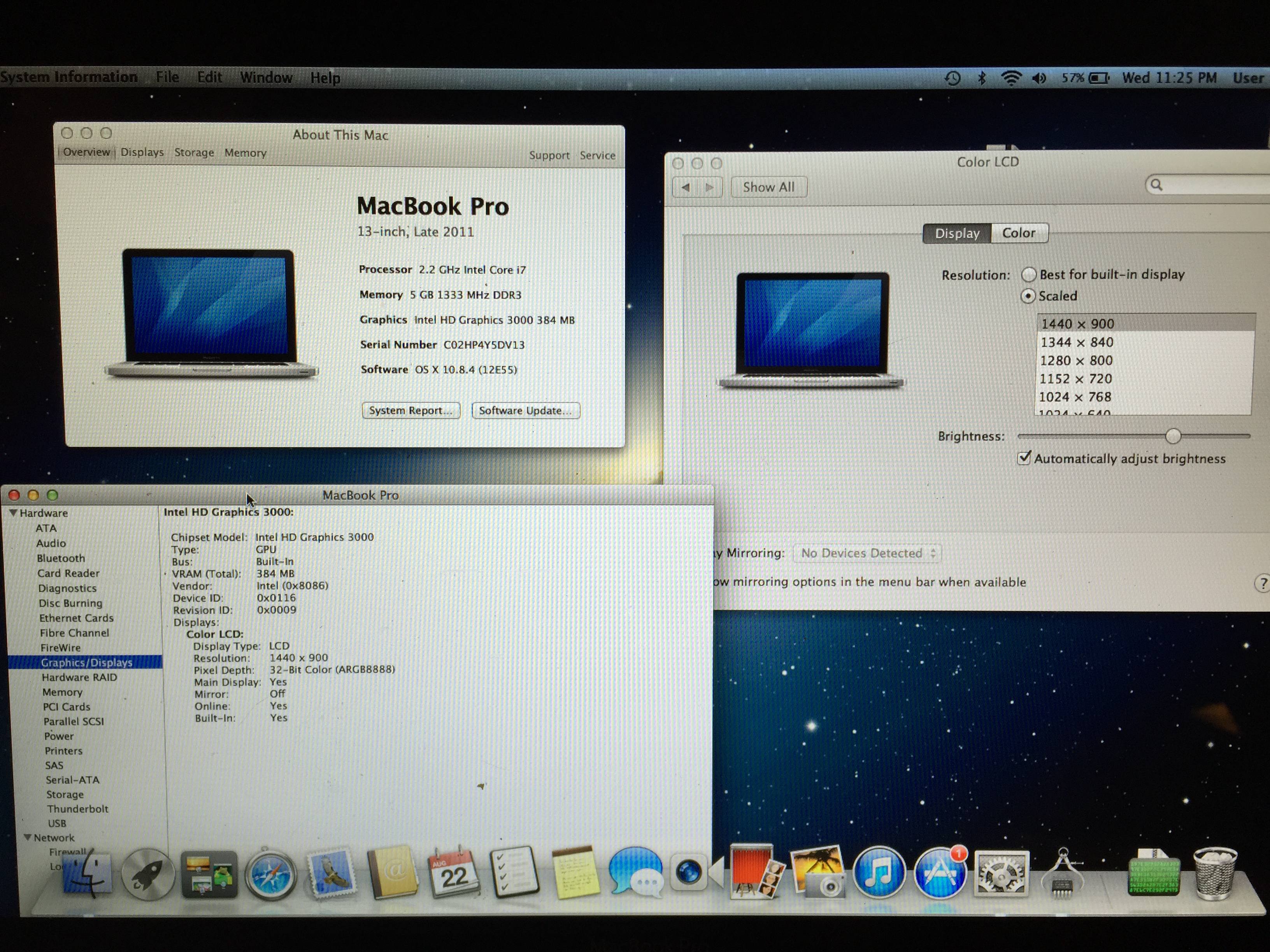

Also if anyone has a permanent solution of for the GPU fix WITHOUT soldering that allows PRAM/NVRAM reset and working backlight control in High Sierra and higher like Mojave that would be great.. if so, please let me know 🙂.
Working on Sierra with R8911 resistor removed and a special USB Ubuntu bootable that modded the EFI. All works like a charm but looking for a solution as described above.

UPDATE: I have finished working on a new solution for backlight brightness control! You can read about, and see this modification in action here.
Finally, once all that is wired up, the system should be good to go! The final product will look something like this:
Last Step
After all your wiring is complete, you will need to cut power to the dedicated GPU, otherwise it will simply produce waste heat. To do so, all you need to do is remove the resistor that supplies power to the GPU VCORE regulator IC, R8911.
At last, once all that is complete, you are now done! You will now have a fully working 2011 15" or 17" MacBook Pro, running off ONLY integrated graphics! No OS X modifications are necessary, and it is not reliant on any NVRAM variable (obviously). This, short of making custom firmware for the gMux chip, is the BEST solution for rectifying the defective AMD GPU issue on these machines. The only issues are the lack of brightness control as mentioned earlier, and the external display port will not work. Other than that, though, everything works perfectly!
I have a video showing the mod in detail here.
