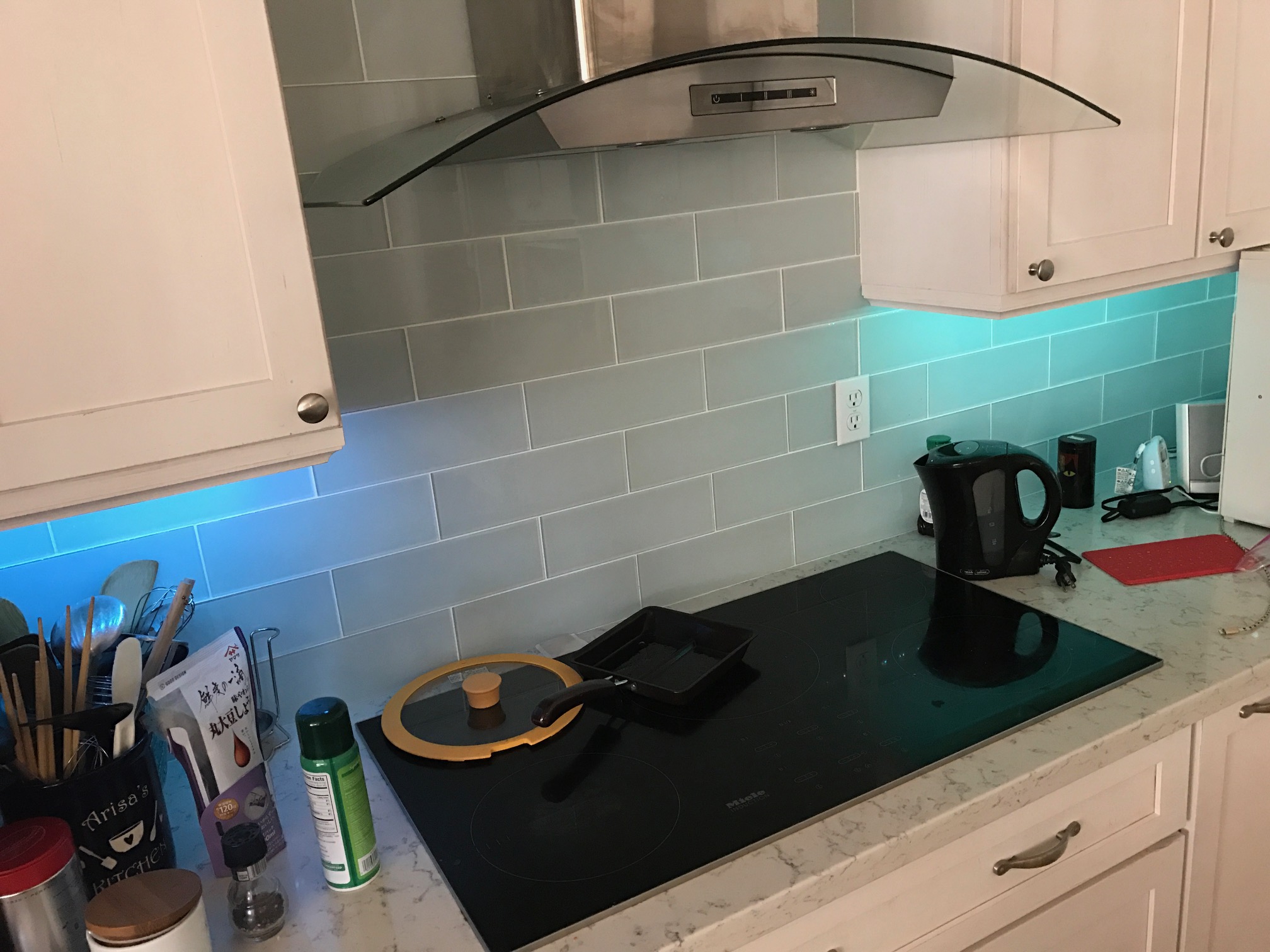

Anyone done much with lightstrips? We just remodeled our kitchen so I picked up two of the 80" Lightstrip plus units plus a 40" extension at the apple store locally.
The first one installed great, looks good. Yesterday I got around to putting in the second one with the extension and while the install went fine, the colors are SIGNIFICANTLY off the first one. I was hoping it was somehow a firmware thing but by today the 2nd unit had updated to a matched firmware and the colors are still very off. Reds and blues are the most noticeable (very orange and green respectively on the 2nd unit).
I've reached out to Phillips but haven't heard anything yet.

Are they the same generation? The second-generation bulbs have different hues and the same might be true for the second-generation light strips.
I've seen this before. One of them is damaged or has a loose connector.
When I first installed strips by my stove (just like you) I cheaped-out and cut one strip in half. I thought I'd insert a few yards of multicore wire between the two halves to connect them. The idea was that the wire would run up behind the extractor fan (out of sight above the stove) and would save me buying a second strip.
It took me a few attempts to get the connections perfect (there are something like 5-6 conductors) but when they weren't, I got exactly the effect you're seeing.
Great info to know. I was planning to do the exact same for my kitchen. I was planning to solder the sections together. How did you connect yours?
Heard back from Phillips and the guy said to just try a color instead of a "scene."
If I tell Siri to "turn the kitchen lights blue" or manually choose a color (not easy to match exactly since it's a color picker and not simply a selection) they match.
I don't understand his reply regarding how scenes "won't match due to the ambiance of the scene." I asked him for clarification but haven't heard back on that.
At least I know there is no physical issue and I don't have to tear them out!
OK, I know what's going on now.
In the built-in scenes that are based on a photo, all the bulbs and strips are assigned a different color from the photo. If you want these two strips to look the same, you'll need to create your own scene manually and set both of them to the exact same color.
