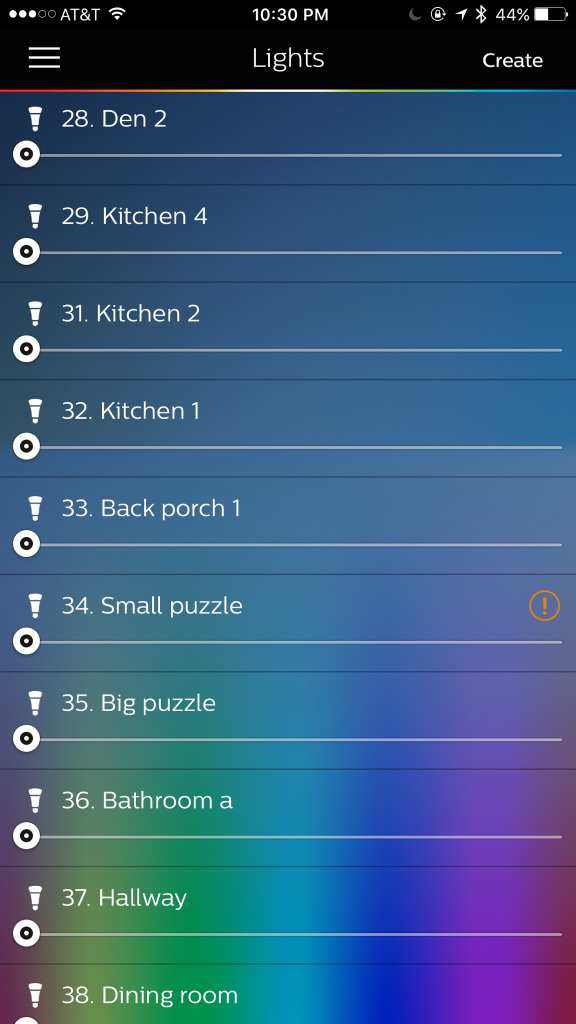

Did you open the hue app then lights do you see any of these? The small puzzle light. I get these with some lights now and again. Unplugging or flipping the light switch will fix it.
never any exclamation marks or connection issues inside the hue app. but HomeKit and Siri are constant problems on my iPhone.
