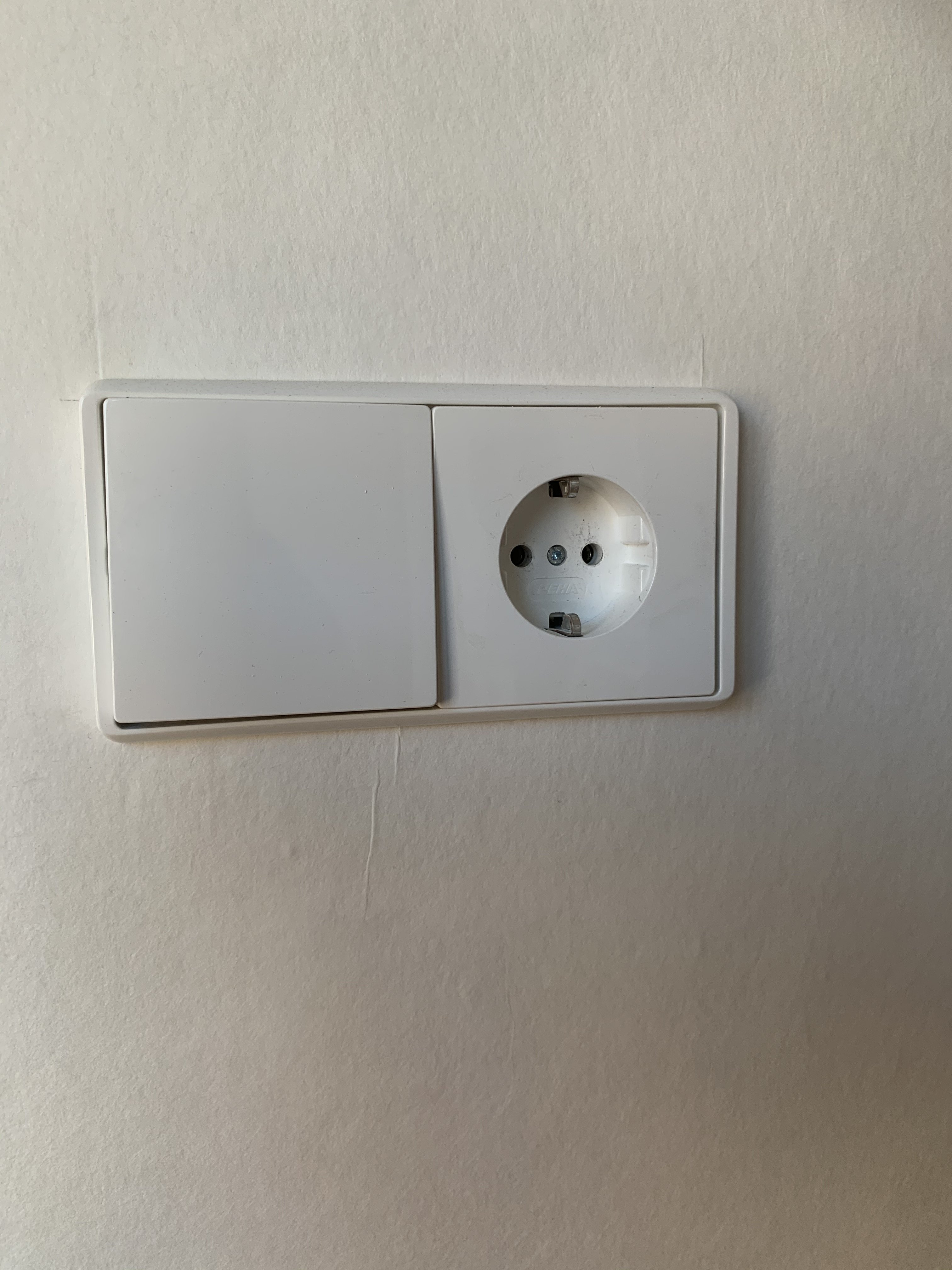

They do not fit in the European boxes without hacks, I want to chose my own switches, not some ugly ones from such as philips.

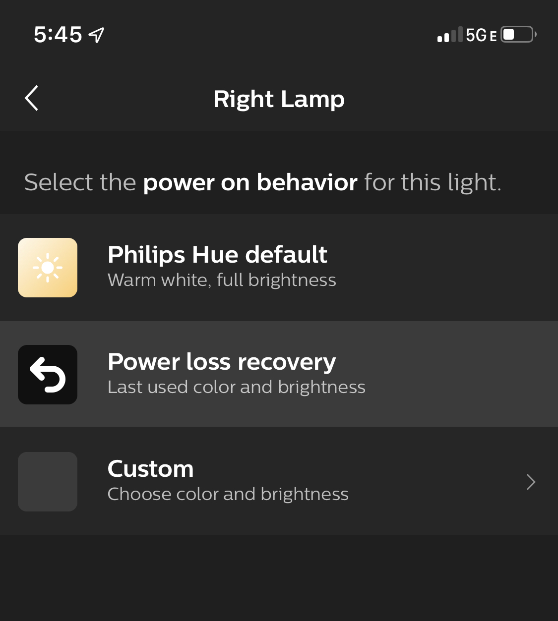

As of a few months ago, you can set hue to remember the current state when the power goes out.

Is that so?
I thought that the only thing changed was that it would not be full blast after a power cut, so if it was off it would be off when power returns, not colour nor intensity.

Yep!

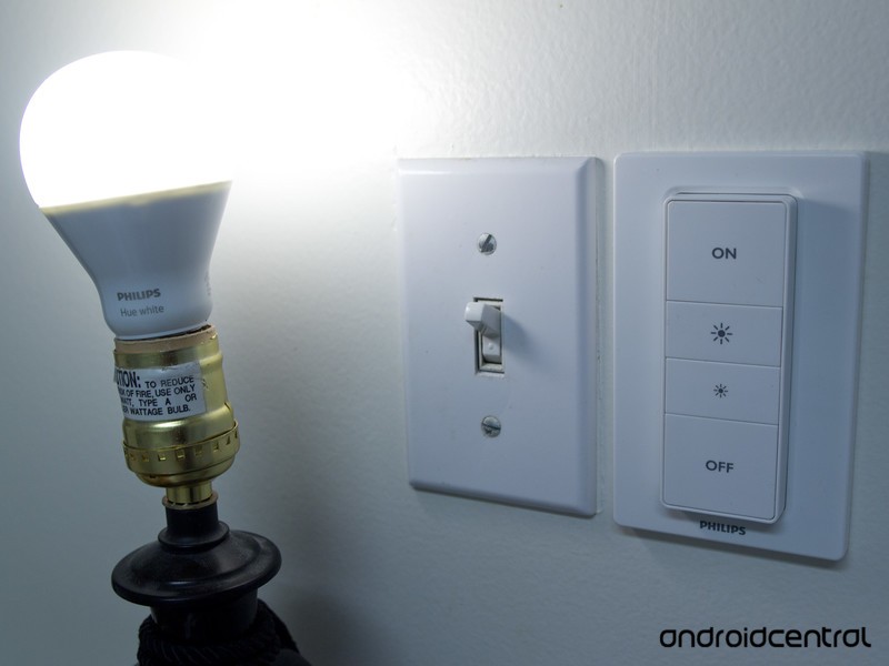

You don’t have to hack anything for the dimmer switch. You stick it on the wall anywhere. It doesn’t need power it charges from batteries in the case.
I have one, the same as in the picture you posted, the format is completely different than the ones used in the EU.
I do not want to use other switches than the ones I have.
It's possible to hack the other Hue dimmer (Hue tap), there's an enocean module inside, crack the dimmer open, get the module out and put it behind a normal switch, it can be done but not with my brand switches.

I have these switches: (Bit dirty...rebuilding and painting)
