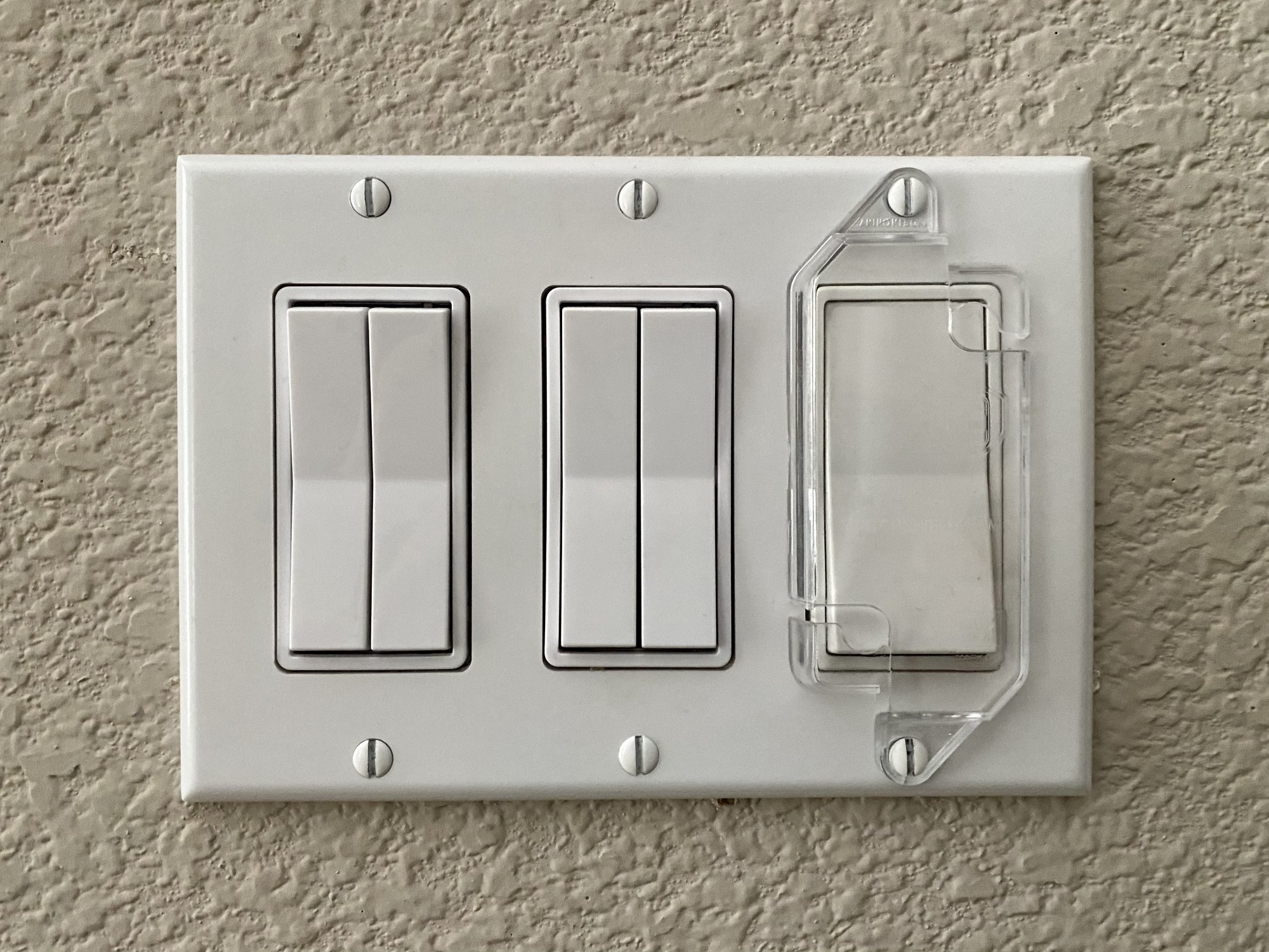

True, Philips doesn't have one, but RunLessWire does and their product has been perfect for me so far. No, I don't work for them. I too was looking for a way to replace the Hue dimmers in my home with something in the actual gong box and came across these. I was using two-way 3M Command velcro strips with the dimmers which was not very pleasant looking. https://runlesswire.com/click_philips_hue.

The problem with smart bulbs is the physical wall switches that needs to remain on. These switches are a clunky workaround.

My electrician just popped open the switches and joined the wires up behind or in the switch. The switch now does nothing and power is always on. The old switch is still there, but harmless.
I wish there was a Hue switch like this one but (in my case for uk sized wall plates) include a cabling option behind that would just do this bridging. Then you could just swap out the switch and the power is always on.
