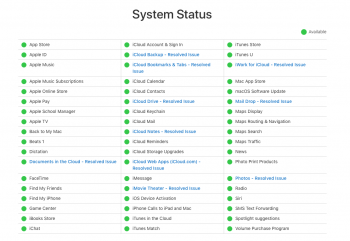

so i just tested a few things out. photo library on the mac hasn't updated since earlier. i just took 4 new pics with the phone, and they never showed up in the photos app after a minute or two like they always do. i went to the iCloud website and sure enough, the photos weren't there either. i guess this means that the phone is failing to upload to iCloud. rebooted the phone, turned off icloud library and back on and still nothing. when i turned it back on, it gave me a low storage warning saying i was trying to upload 24.1 GB of pics to iCloud and didn't have the room (doubling up the photo storage already there). so the phone shows 8021 items but the mac and icloud show 8018. those recent 4 aren't updating. however, imports from the mac to iCloud seem to be. according to their system status page, looks like they were indeed having iCloud issues but it says resolved.

I did exactly the same thing. I don't think the issue is with iCloud, as my photos are still syncing fine between icloud.com and my iPhone. Either way, its incredibly annoying 😡
