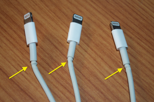

They stop working after a year of use consistently, and it's because of the same thing that has caused problems for Apple cables for the past 10 years.
There was a time when they used buffers that actually did the job of letting the cable bend, and it used materials that worked well.
Then they decided that they needed to stop using the notched buffer piece, and make a simple thick sleeve buffer, which is more rigid than the actual cable. This causes it to bend sharply and kink at the part where the buffer piece begins. And that bending tears the inner wire, making it stop working.
This is a valid design flaw that they refuse to fix, because they don't care about other people's cables. "Go buy a new one".
I've had 2 of my Lightning cables stop charging without breaking open or exposing wire. They looked like the ones above.
Nobody cares if your cable is still like new.
