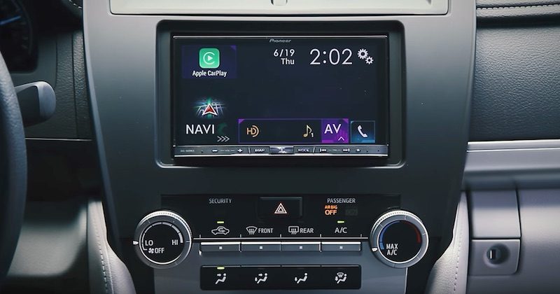

Pioneer has informed customers it has discovered an incompatibility between iOS 11 and AppRadio Mode on certain in-dash receivers it sells.
If you connect an iPhone or iPod touch that has been updated to iOS 11 and launch AppRadio Mode, you will experience a blank screen or other display malfunction that disables AppRadio Mode, according to the company.
Pioneer said it is working to resolve the issue and will update a notice posted on its website once firmware updates for the receivers are available. For now, the only solution to maintain compatibility is to remain on iOS 10.
AppRadio Mode is Pioneer's own interface for running over 30 compatible smartphone apps, browsing the web, navigating, and listening to music, podcasts, and internet radio through your car's speakers.
Pioneer's list of affected models include many AVH, AVIC, and SPH receivers, some of which double as aftermarket CarPlay systems.

I have the Pioneer AppRadio 4 with CarPlay and it works fine with my iPhone 6s Plus running iOS 11. The AppRadio has been updated to firmware 1.18 which was available last month. No issues.

AppRadio mode is in most higher end Pioneer head units regardless of name. I have an affected head unit myself, the popular AVH-4100NEX, and have never once wanted AppRadio mode over CarPlay.

CarPlay seems to be affected in some ways too. I started getting an error message on my Pioneer AVH-4100NEX occasionally the day I installed iOS 11. Unplugging it and plugging it back in solves the problem, but it's a little annoying that I have to go through this.
I’ve found waiting till the 4100 is completely booted before plugged it in solves all the issues I had with CarPlay not launching or it crashing.
