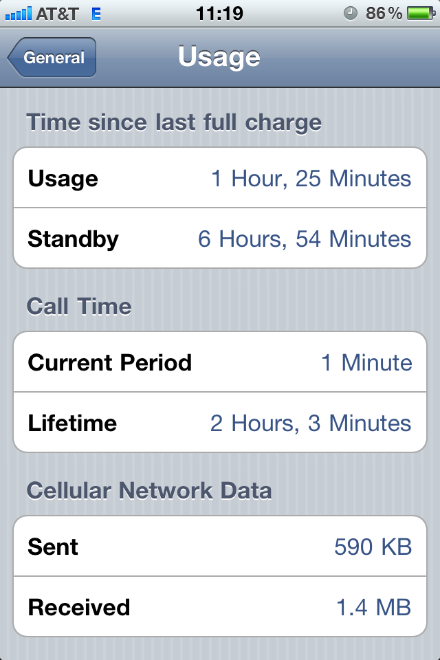

Here is mine.
My battery's better than that, but I'm definitely not impressed with it. If you set up as a new phone do you lose your saved texts?

How Does Mine Compare?
I've been wondering about my battery, too. It's nowhere near as good as I was getting with my 3GS. Attached are my usage stats since 4:30 this morning. The usage was about an hour of web stuff on WiFi and 25 minutes of it over 3G. I've also begun turning everything off except whatever I'm using at the time. So these stats were with everything off except WiFi, then WiFi off and 3G turned on. Brightness is around 50% and auto turned on.
I find, as others do, that killing the Mail app in the task switcher helps a lot, and of course, turning off push and fetch.
Opinions on my battery? I'd hate to exchange this phone, everything is working well, and I feel kinda blessed for that fact. 🙄

Your battery looks fine to me. I'd be interested in how it does with more usage. Like when your less then 20% battery life
I've force-drained it twice since I bought the phone on the 18th, but I wasn't awake to observe sub-20% performance. I've noticed that the performance has been overall improving the longer I've had the phone, which was the case with all my earlier iPhones, as well, but I've done so much tinkering with settings that I'm not sure that's conclusive. It also seems like this phone is kinda the opposite of my car: It doesn't do as well between full and half as it does below half.
