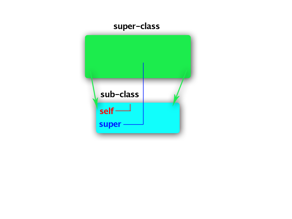

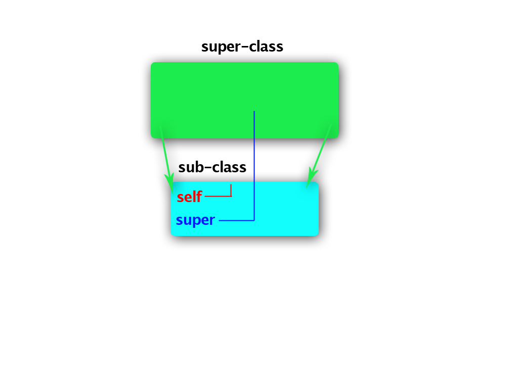

Is this right
Is this what happens?
Precisely! As a developer, I inherently lack even the artistic skill to draw that! 😛
Self is relatively easy to understand; since all instance method calls take the form [objectname methodname], then it's clear you need the self keyword in order to call methods in the same object.
Super is a bit less clear; but it's often necessary. Particularly (as mentioned by another poster above) if you override a method in order to add to the functionality of the parent's method, not replace it entirely.
So in your method you add the code specific your subclass, then (using super) call the inherited method to execute the generic code for the parent class. The dealloc example above is a very common example of this.
Can't quite figure out what that drawing means.
"self" is quite easy to explain: Whenever you send a message, you need someone to send it to. Either an object, if you are sending an instance method, or a class, if you are sending a class method. Inside an instance method, "self" is the object that you sent the message to. Basically, every single instance method has an additional parameter named "self" which is the object that the method was sent to, and because every single instance has that parameter, it isn't worth mentioning in the parameter list.
"super" works very differently: It has to do with what actual code should be executed. A method can be overwritten in a derived class; and overwritten again in the next derived class and so on and so on. Sending a method to "self" will find the actual type of that object, and find the version of the method appropriate for that type, and execute it. Sending the same method to "super" will instead find the implementation in the superclass of the currently running method and execute it; but the message is still sent to the same object.
Example: You have a class Person, a subclass Manager, and a subclass Boss. You are writing an instance method A for class "Manager". The "self" object passed to that method could be a Manager object or a Boss object; it cannot be a Person object. If your method A calls another method B by writing [self B];, then the code that is executed is the Manager version of B if self was a Manager object, and it is the Boss version of B if self was a Boss object. If your method calls [super B], the "Person" version of B will be called, no matter whether self was a Manager or a Boss. If B calls another method [self C]; and the original "self" was a Boss, then that call will execute the "Boss" version of the method.
Sort of. "self" is refers to a specific instance of the subclass, not the subclass. There is a difference, as there are both class methods and instance methods.
