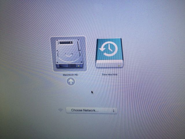

thanks for getting back again,
heres what i have for the bootable time machine thing...
Basically what happened was this:
I had to partitions, one main one that I needed, and a second one for playing around with OS X operating systems. I needed to put Windows 7 onto my computer, so I decided I would do three Time Machine backups(To the same time machine drive), and then take some of the remaining space (which was about 250GB at the time) and use Boot Camp to install it. It wouldn't let me, giving me error messages such as more than 10 GB needed (which there was), or the drive needs to be journaled(Which it was).
I decided it would be easier to just completely erase everything off of the drive, and restore from the Time Machine backups I made. When I selected my name from the Time Machine Dr., and selected the most recent backup, it finished a lot earlier than I expected, and when I opened up the computer I found that it only restored the second partition, and not the first one.
I eventually figured out that the most recent full backup (that appeared in the Time Machine/migration assistant UI) was made somewhere around October. When I restore to that back up, I can open up my account, click on "enter Time Machine" and view all of the files from the primary partitions backup on April 6 of this year, even though those files don't actually show up in migration assistant or the bootable Time Machine backup. I can interact with the files, i.e. play an audio file, or watch a movie by using the QuickView option, or clicking the play button on their icons, but I cannot copy them from the external Time Machine backup, to the internal drive.

Boot Camp will only work on internal drive(s). Starting with a single partition, BC might not be able to create its partition if there are files residing in the sectors it wants to use. The only way to fix that is to either use a defraging program such as iDefrag, or to Restore to an external, then back to the internal.
It's still not clear how this ended up with a bootable partition on the TM drive - even if you made three partitions - one for each backup (which isn't really needed, but would set the maximum backup space for each if you did).
When you say "erase everything off of the drive", do you mean using the Erase tab in Disk Utility? That will erase the contents of the partition, but if there's a problem with the drive's partition map, it won't help. You'll need to perform the re-partition steps I mentioned earlier.
I'm still not getting how you have any bootable partition with a TM backup on it (unless you put the TM backup on the same partition as you have previously put OS X on, which isn't really recommended - mostly because you're limiting space TM can use). For an emergency boot partition, it's good to have options, but I would keep external OS X installs on a different partition as TM. Having an external boot partition isn't as necessary as it used to be when we didn't have the Recovery Partition as an option on the internal drive.
The screen shot does show the TM drive as bootable, but it's not because it's being used for a TM backup.
Edit: Thought I'd mention a great way to backup a BootCamp Windows install is to make an image using WinClone. It creates an image that when restored, will be bootable. It's been indispensable when swapping out drives or if the BootCamp partition needs to be resized (use BootCamp Assistant to delete, then recreate a new partition of the new size).
