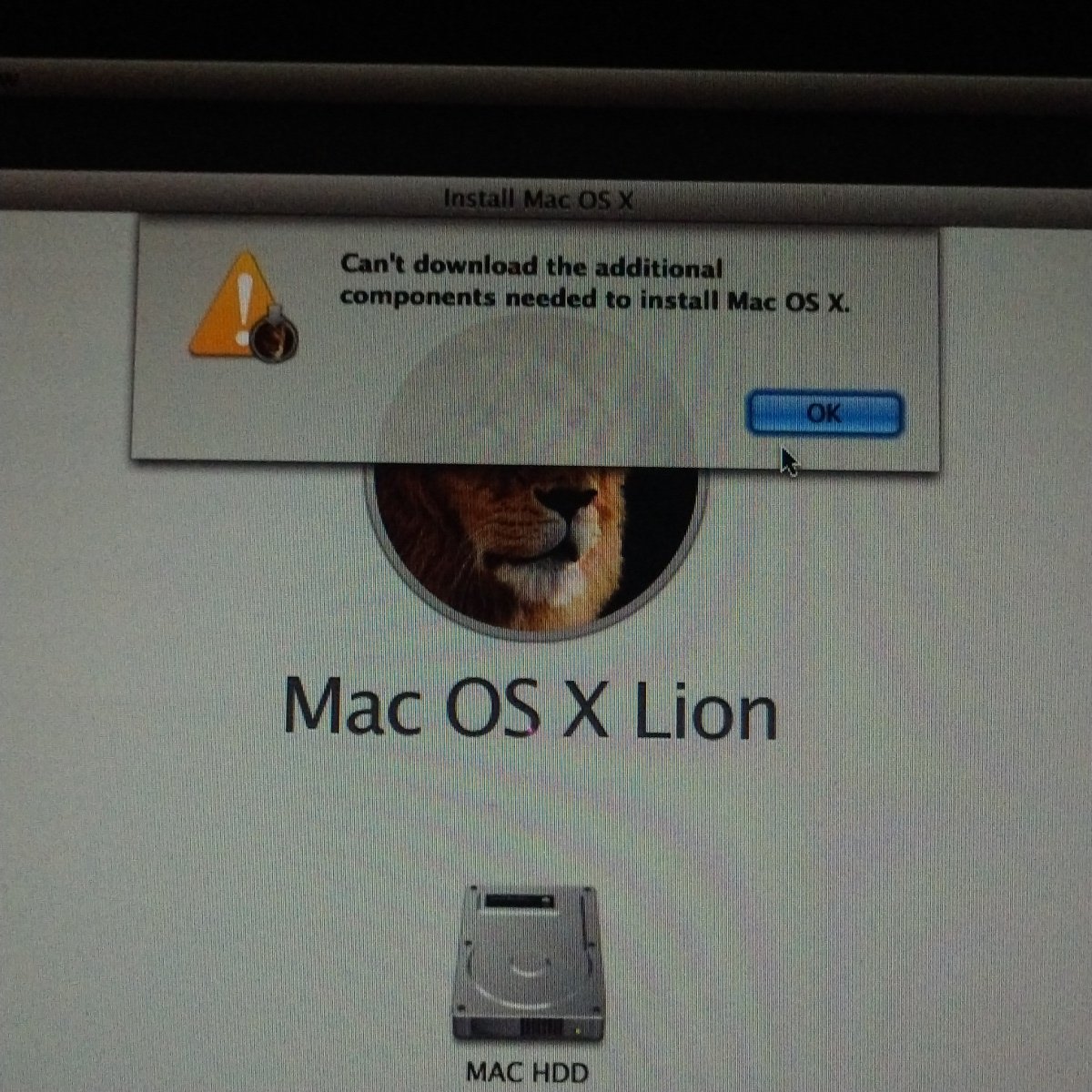

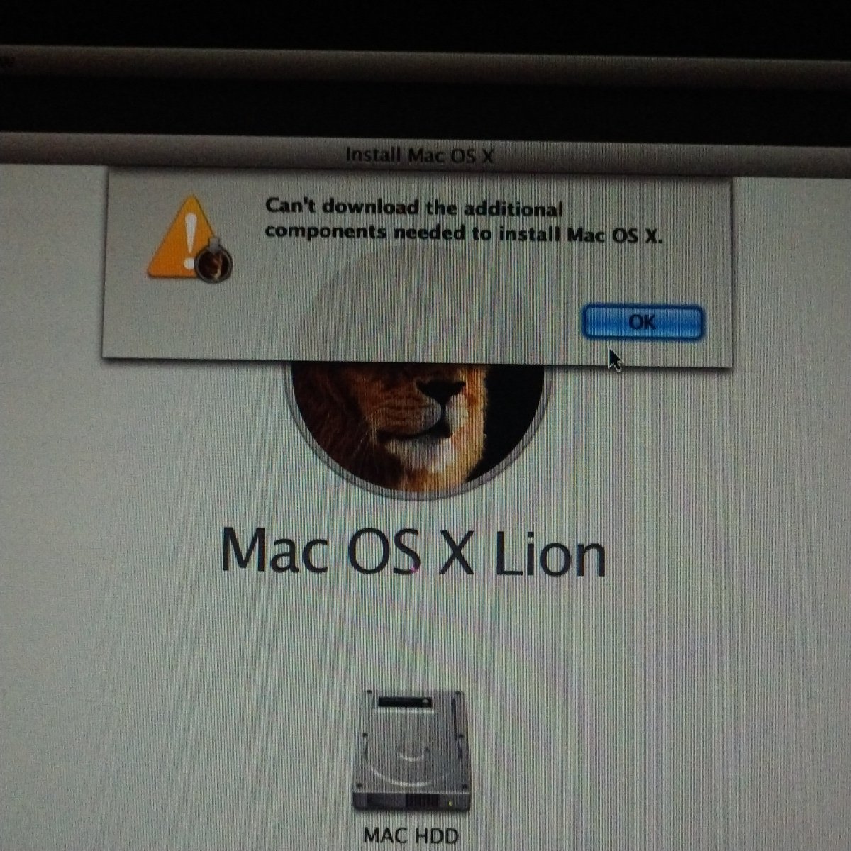

Please Help I'm stuck while resetting my Macbook Pro late 2011 to Mac OS Lion, it's showing can't download additional contents needed for Mac OS X, I'm also sharing at the screen I'm stuck so that it'll be easy for U guys to help me out....
It's the place where I'm stuck, I didn't took Time machine backup as I wasn't having such data to keep, tried Reinstalling Mac OS X it's showing all the time this....

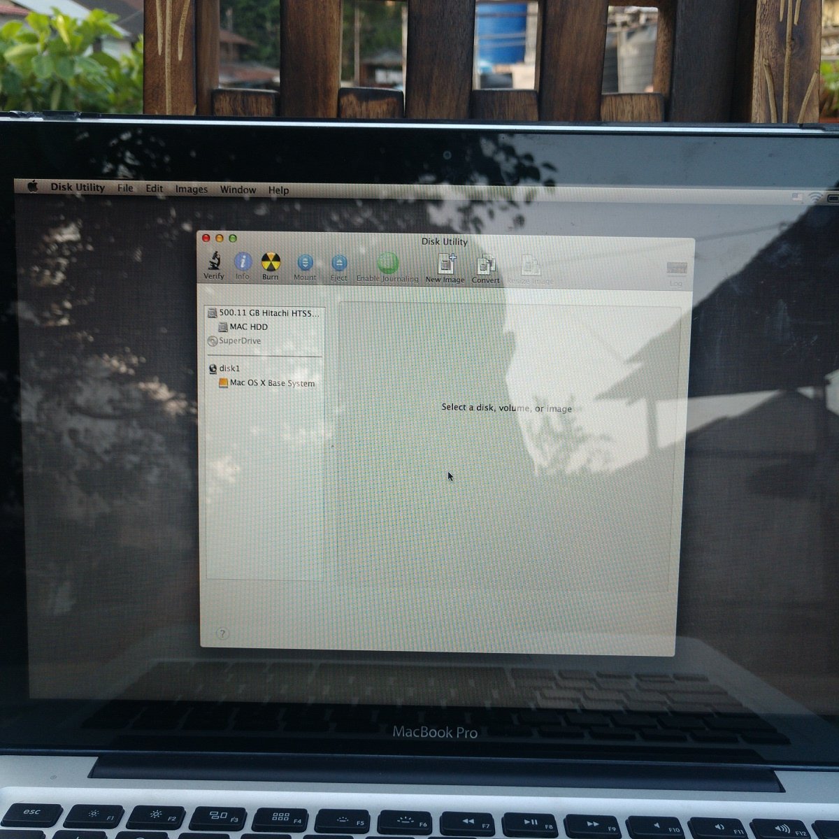

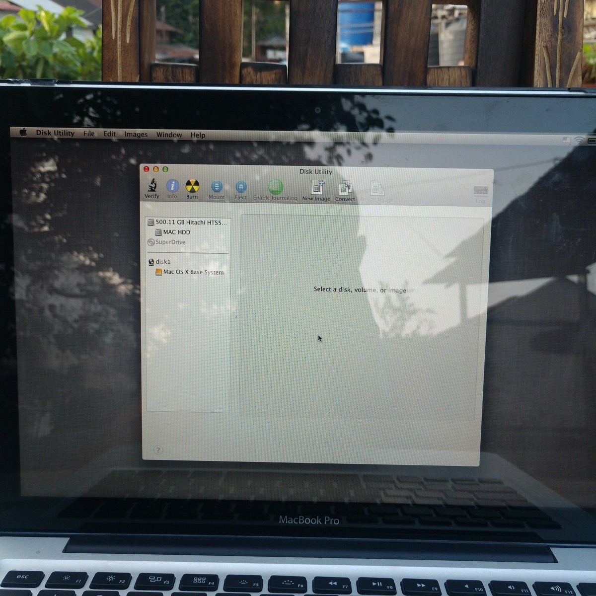

Disk Utility is showing this....
Please suggest a Solution without Bootable usb or any other external device(if possible) as I'm new to Mac world....
Please help me out Guys, Thanks a Tonz

I notice your wifi signal icon is grayed out. You have to be connected to the internet. Connected to your wifi and you should be good.

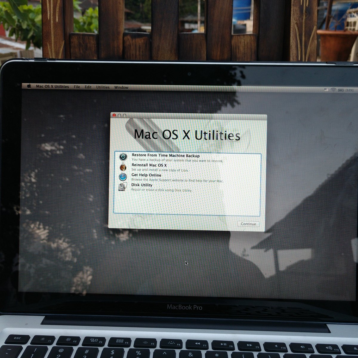

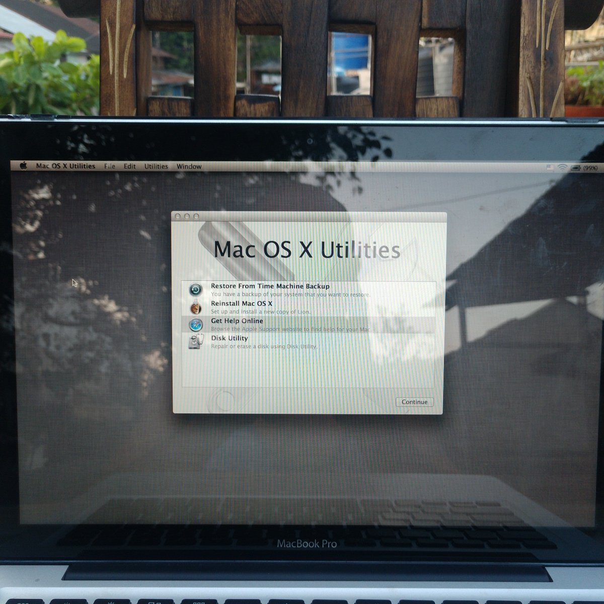

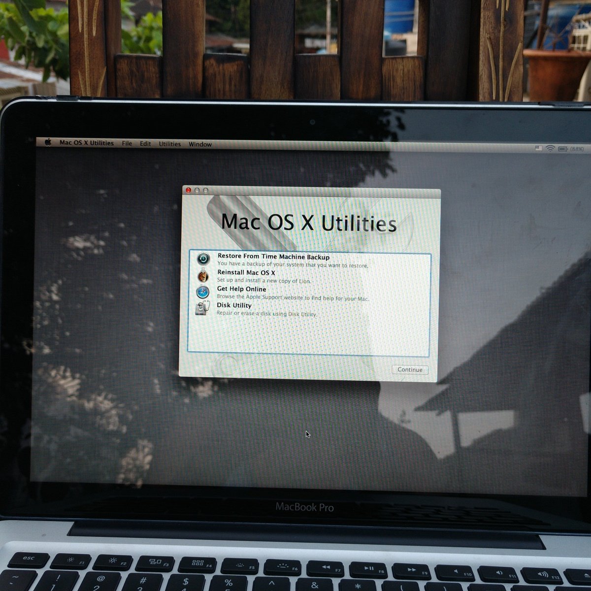

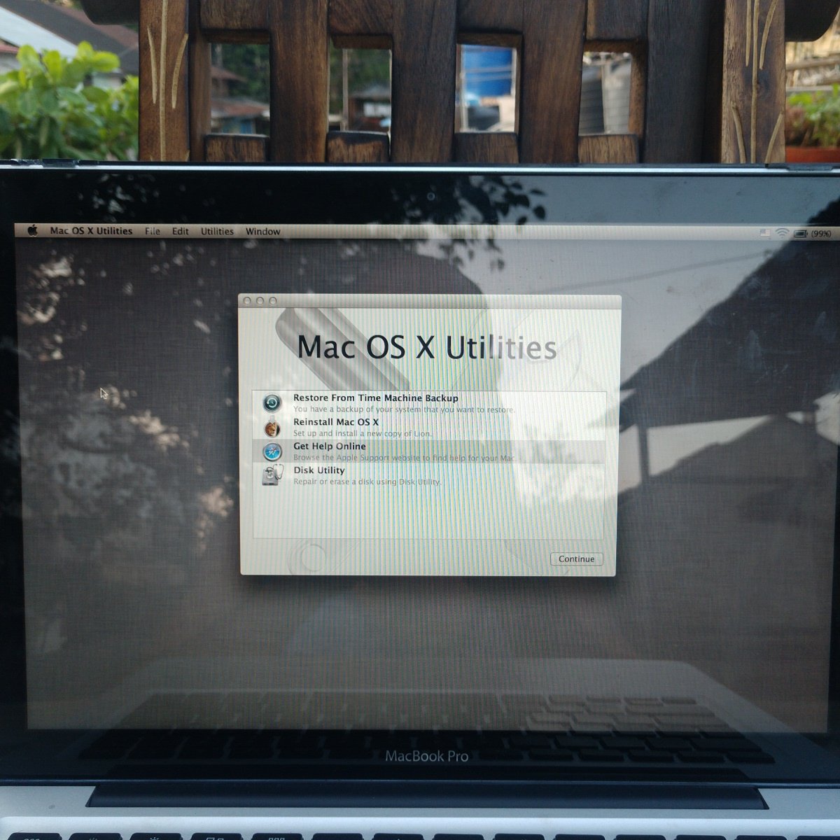

Cleared PRAM, then tried rebooting in recovery mode it then got me to
I'm not getting from here how can I opt for reinstalling another Mac OS i.e.high Sierra or other,

Cleared PRAM, then tried rebooting in recovery mode it then got me to View attachment 1773931 I'm not getting from here how can I opt for reinstalling another Mac OS i.e.high Sierra or other,
Ok..
Let's do this another way..
When you're in the recovery menu as shown above, I want you to click with your mouse "Utilities". This will drop the menu down and then click on "Terminal".
In Terminal mode,
Type in "date" without the quotes
It should list the current date. Due to the expired certificates for Lion, I want you to change the date of your computer to bypass this.
Then I want you to type in a new date which is Dec 11, 2011
So in terminal mode, type in "EXACTLY" what's below. This will change the date to 2011.
date -u 121111112011 and then press enter
type date again on terminal to confirm you have changed the date to 2011.
After that, I want you to select restart and then during restart press SHIFT-OPTION-COMMAND-R
In the Recovery Menu, you should be able to install Lion on your MacBook Pro now since you have changed the date to bypass the expired certificates. After Lion is installed, you can upgrade your MB Pro all the way to High Sierra.
Try that.

I jus finished trying it again same pop-up appeared Can't download required data etc.....
I did brought this MacBook Pro from another person, can that be an issue for this problem??

I do not really think that's the case. I suspect it's most likely that your MB Pro has the newest firmware BIOS and it won't allow you to install any OS less than the last one you installed. For example; if your last OS on this Macbook was High Sierra, then you can only re-install High Sierra again. You can go back to terminal mode and do this
date -u 121111112016 and reboot. This should force a High Sierra install on your MB Pro. If this method does not work, then you have to create a USB installer and install a new High Sierra OS.
By the way, do you have a router with an Ethernet port? Just in case WIFI isn't working properly, try connecting an Ethernet cable from your MB Pro to the router and have a direct Internet connection that way. And try again.
