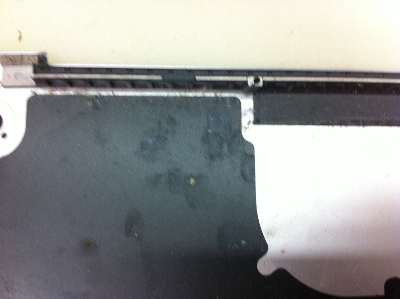

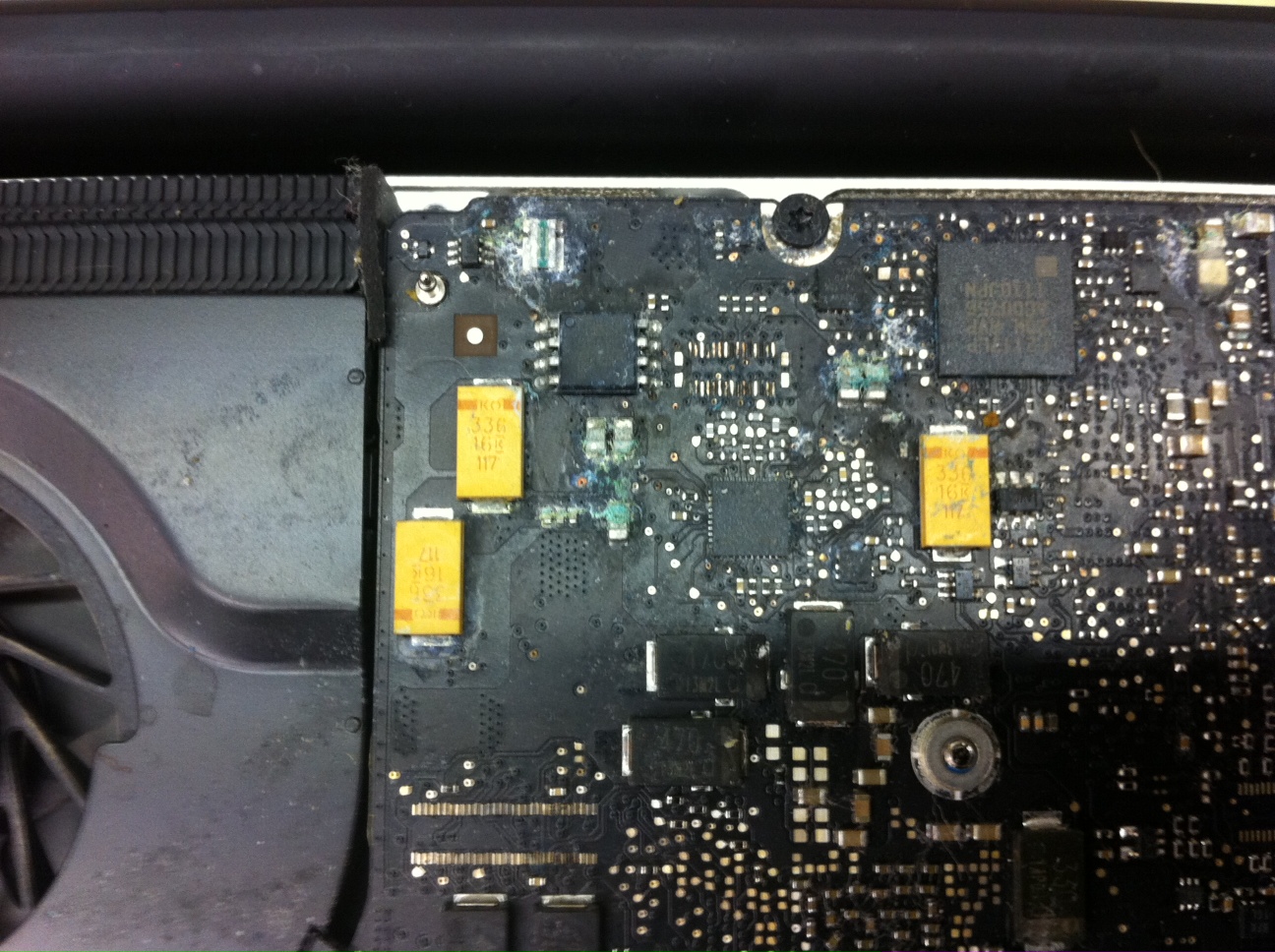

ok so im based in ireland and have been having problem with my macbook pro for a few week there would be a loud beeping noise - 3 beeps and then a break and the 3 beeps would repeat. The spinning beach ball appears regularly and last for extended periods of time. could be up to 2 minutes tat times. apple care mentioned this could be an indicator of a possible RAM problem and told be to bring it into one of their certified repair centres so i brought in into Mactivate in dublin. they did testing and couldnt find the problem so decided that they one replace one piece of RAM and give it back to me and if this didnt help they would replace the other.
When they opened up the back they say they found corosion of the motherboard and are saying it is the result of liquid damage. however no liquid has ever been split on or even near the machine. i got the laptop last july and have pretty guarded it with my life since i got it. no1 has ever used it other than me. they said that from what they could see liquid got it from the back where a fan is but like i said nothing has ever been split on or even near it. i rarely even drink near it.
so how is it possible that they say there has been liquid damage when there has never been anything split on it?
Id appreciate any advice on the matter. Thanks

It clearly shows that some liquid of some type has entered the ports at the screen hinge area. Could be moisture from using it in a very humid and cold area then bringing it into a warm space where the humidity condensed.
There could be a number of reasons. Have you ever transported it in a backpack in the rain?
Apple does not care how are where that happened. Sorry to say but your warranty is now void.
Your only option is to claim the lose on your home owners policy, if you have one that covers such things.

Theres no doubt it's had liquid inside it, but I think it's worse than water. I'd hazard a guess that it's some form of fizzy drink.

Liquid damage, near the hinges? How do you clean your screen? Perhaps it's from spraying cleaner on it - and it seeps through @ the hinges?
Do you take your laptop between environments (say outdoors then inside) with it running? (especially in the summer / winter - when moisture will condense due to the temperature differential)
FYI, an improperly cleaned board (from the manufacturer) can corrode - say they didn't remove solder flux - over time, even mild flux can chew away at exposed conductors.
If warranty is gone - and you're sure it's the corrosion causing this - use distilled or deionized water, no battery, no power (at all), and wipe down that area, the distilled or DI water will grab electrolyte / ions on the surface. Then use rubbing alcohol (isopropanol) to remove the water. Let it dry, and that may help things. Note, if you have a warranty, forget you read this.
Edit - looked at the pictures (didn't see them first round), that's electrolysis - so a conductive liquid - was in there, while power was on - and that corrosion is the result. Water, coffee, soda, vomit, tea, cat urine, of no matter, same net effect. That DI water trick has a slim chance in hell, but those caps on your board are mighty green - so they could be hosed. That said, I figure some chance in hell, is better than none.

I'm not sure if it's solder flux, but I have seen this once with a week-old MacBook Air. The logic board had corroded around an IC that would normally be well covered by a layer of black plastic below the keyboard. Apple automatically denies any evidence of liquid damage, but considering the circumstances and diagnosis the machine was repaired.

The first picture, top left corner of the motherboard, what is that white dot in the brown square? To me it looks like an LCI, which would mean it hasn't been affected by the liquid. Probably wrong though, I don't know the locations of the LCIs
