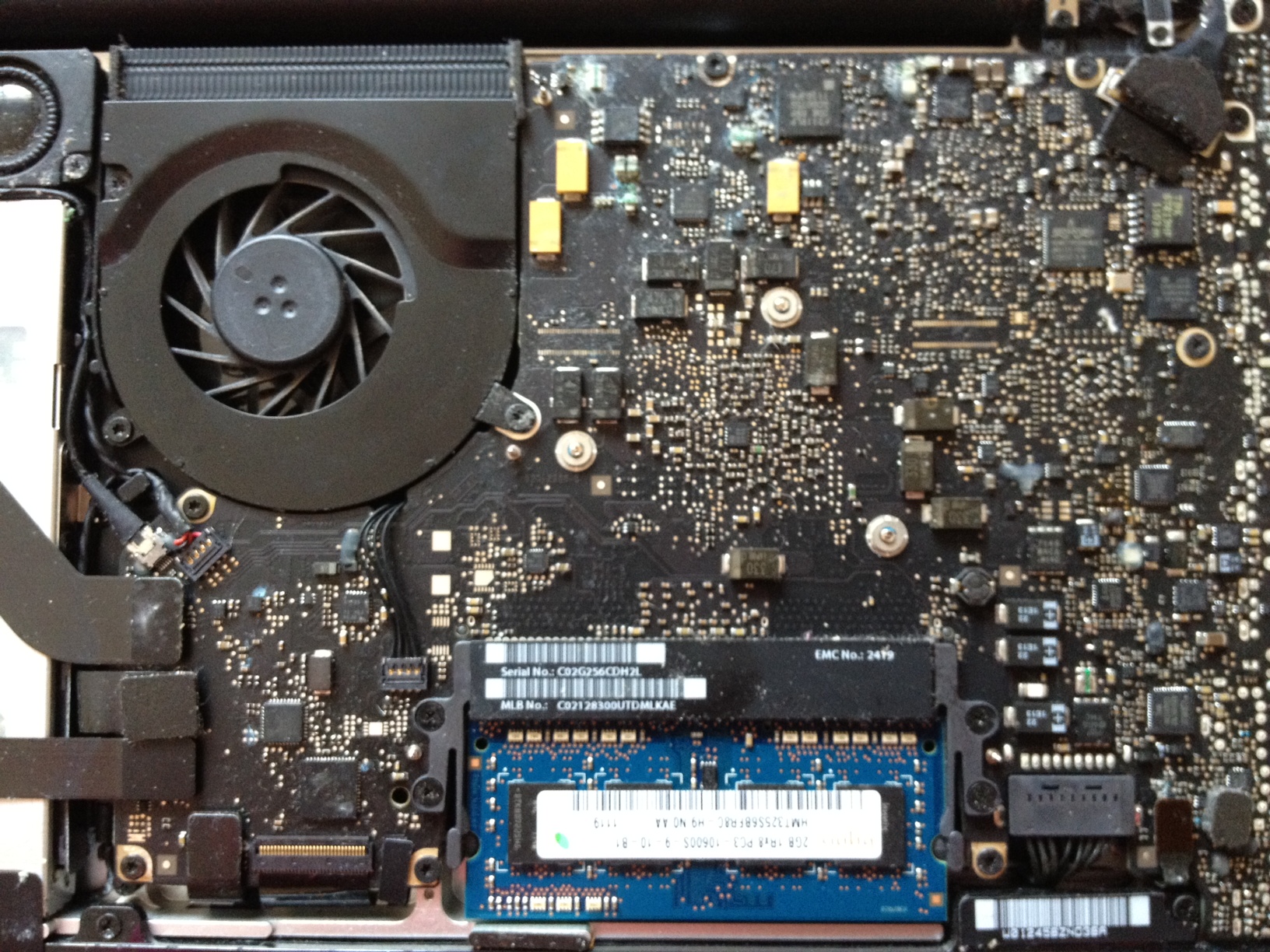

It's definitely liquid damage, but rather than speculating about how it got there, let's focus on what you can do about it. Doesn't matter how it got there at this stage as apple won't cover repairs if there are any signs of liquid damage.
1. Did you purchase 3 year apple care with the machine? You mentioned that you bought it in July, so it's less than a year old. This means that you're not making use of your extended apple care yet, so ask apple to refund it for you. They usually do this as far as I know.
2. The corrosion looks pretty bad, I would hazard a guess that cleaning the logic board with cleaning alcohol will do very little for you. Nevertheless, it's worth a try because it's the only repair option that you have as this stage short of replacing the logic board.
3. If cleaning doesn't help, claim it as accidental damage on your contents insurance. Pay the excess using the money you're getting back from apple for getting your apple care refunded, then get a new laptop from your insurance.

here is a picture i took my self

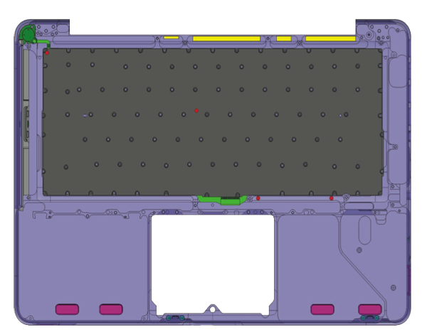

I don't know if they were lci's as Im not sure where the are located. Taking the bottom cover off, where would the be located?

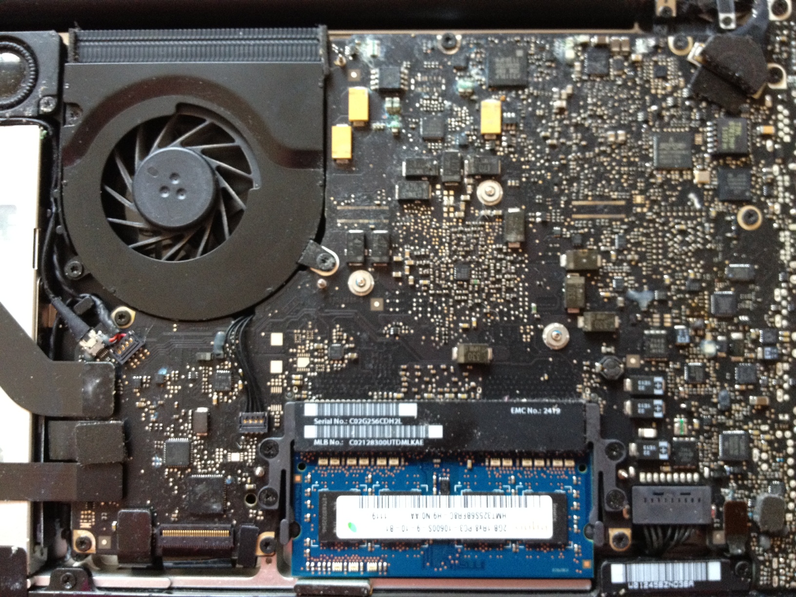

Annie90 - FYI, I would be willing to put money on your board having water damage. Do not take this the wrong way, I believe you took amazing care of your computer, however it did happen, if not by your hands, by ones you didn't see, or that handled this before you got it.
If those water indicators are NOT tripped, there is ample evidence otherwise to indicate it did occur. If you saw a used car for sale, and it had a clean history (no accidents reported, clean carfax / ect...) yet was smashed to bits - would you purchase it like a car that wasn't mangled?
Your warranty can be voided, even if those indicators are still intact. Those indicators are intended more for the opposite of your situation - for slight water exposure that caused damage, but did not leave any other indication physically. In this case, it's obvious.
If you know any nerds who have access to DI water / vacuum chambers, give them a ring. If Southern New Hampshire isn't too far a haul, message me. Otherwise.... Find yourself a solid repair shop and hope for the best.
I don't know but there are several white dots in that photo you took yourself that look a lot like LCIs. You'd be able to tell better by looking/feeling first-hand.

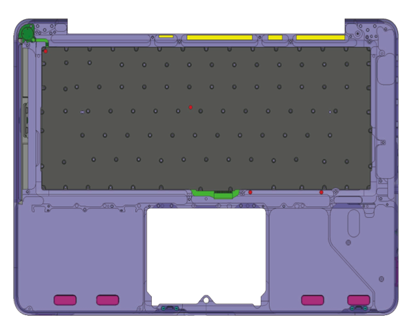

Again, as I said I dont know what model your MBP is but for the 13in, this is where its located.
The red dots are where they are located.
