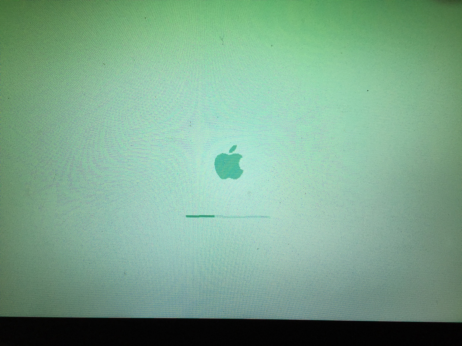

I'm freaking out! I was in the middle of doing my assignment when my MBP suddenly restarted itself and now it's stuck on the start up screen with the Apple logo and a progress bar, which hasn't moved in hours.
And the whole thing is badly pixelated for some reason. I have no idea what to do and I'm scared I'll lose my data as it's not backed up (stupid, I know).
Please help me, any advice would be highly appreciated!
Thank you.
Looks to me like a hardware issue....graphic card, logic board....🙁...had a similar issue last year...but I was very lucky...it was MBP early 2011.....got a new logic board, free of charge.

Agreed with poster above, looks like Logic Board. If you have the 15 or 17" 2011 MacBook Pro, or the 2012-Early 2013 15" Retina MacBook Pro, Apple will cover the repair free-of-charge. Just do it quickly because the repair program terminates at the end of this month.
Thanks for the quick responses! Can't remember if mine's 2010 or 2011. How can I check this with no access to the OS? Also will my data be lost?
STOP!!!
BEFORE shutting down your MBP, take some MORE good pictures!Using your Smartphone for example.. but the one here will be already sufficient to proof the failure.
Since this is a hardware-problem your HDD and data will be safe. BUT: Don´t remove it yet because there are some files on it that make prove that your GPU is failing.
So:
1) Make some more photos of the screen.
2) Shut down the mac and do NOT start it again before your appointment with genius bar or an apple-certified enterprise for service.
3) They will read out the informations and do a special test.
Show them the picture proving the GPU-failure.
4) Now you can make them take out your HDD/SSD
5) They will replace the main board for free.
Good luck! (and be happy that this happened before expiration of the so-called "Extended warranty") .So hurry up-
For further information look at apple.com for "Extended warranty" and "MacBookPro 2011"

Tell them that you have the infamous failure of the GPU and you have needs to IMMEDIATLY solve the problem, especially because the program is terminating soon. MAke some pressure and you will get an as fast as possible appointment.

Oh maaan, I'm doomed! Well it's not quite so bad but I'm left with no laptop for the next 7 to 10 days!
And as I stupidly assumed that it would be a quick, same-day turnaround procedure, I never bothered to back up and of my stuff (couldn't find my firewire cable). Actually considering calling them to take it back so I can transfer my stuff and then take it back again.
Anyway, aside from that, I had no issues with having it fixed free of charge as part of their program. All he did was check eligibility by entering the serial number on his tablet.
I briefly explained the issue to the guy and the second he turned on the laptop he said that it's immediately evident that this is in fact the problem. He ran some diagnostics to confirm and then checked it in for repair. Oh btw, during the diagnostics an exclamation mark came up next to the hard drive and I almost had a heart attack but he explained it's cause I've replaced the original drive with an SSD
