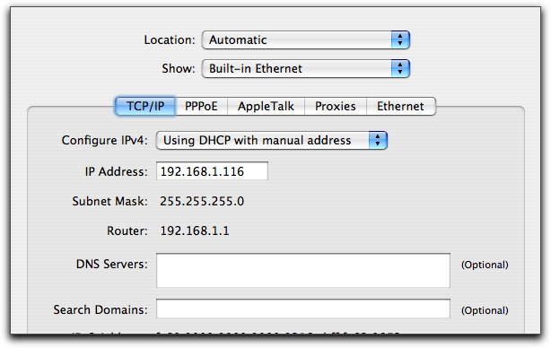

Oh, it's much easier than that.
Just choose "Using DHCP with manual address" in the network settings - all you need to do then is enter the IP address, nothing else.
In your case, you'd enter 192.168.1.15, and you should then be all set.

stoavio said:
Awesome. But, isn't 192.168.1.15 the router's IP address?
I'll try it.

Ok, I don't think that worked. Here is my router setup (main page again) and my System Preferences.
Router:
System Preferences:
I wasn't able to connect to the internet once I changed to 'Using DHCP with manual address'.
Possibly because another computer already has the '16' address because it was assigned by DHCP earlier.
Try 192.168.1.30 or something else which can't have been assigned already.
Edit: also, something's wrong because your subnet mask and router info should have been filled in shortly after you applied the change.

Ok, I've changed some things. Selecting 'Using DCHP with manual address' doesn't allow me to reconnect to the internet so I've selected 'Manually' from the drop down, entered 192.168.1.30 and then entered the nameserver returned by running the command: cat /etc/resolv.conf
I'm connected now. I wonder if this could create a conflict with the router and future IP assignments?

Yea, I kind of thought that too so I switched it to 'Manually' and it now looks like:
No - the router will never assign the '30' slot unless you change its current settings. I suspect the "Using DHCP with manual address" approach would have worked with '30' - it always does with me - but you found a way to get it to work, which is all that matters.
