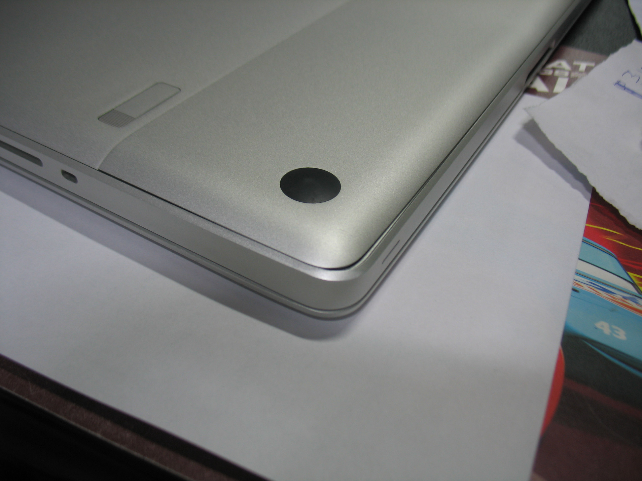

Ill fitting battery cover in my refurbished MBP 15"
Hi there guys,
I am facing a similar problem with the MBP battery cover. One side of the cover does not seem to fit properly and seems askew while the other end fits perfectly. i am attaching a picture of the problem for you guys to give me some suggestions
I tried bending the tabs, but could not get it right? Is that the solution to this problem. Any help in this regard would be greatly appreciated. You could also mail me at Vijayrajan10@gmail.com with any help whatsoever. :)
Thanx in advance.
