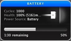

I have had my MacBook since May '07. It and I have done a lot of work together and until very recently most of this was done on the go. The battery has lasted 1,000 cycles and counting despite being rated as good for a mere 300. I still get between 2-3 hours out of it too.
Whoever designed that battery, well done. You may have tempted me to stick with Apple for my next upgrade.
Impressive 🙂 I wish my battery did that haha. I only have 34 cycles on mine, and my health hovers in between 94-95%

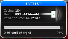

Looks like mine isnt doing too well, I'm on my second battery now, the first one failed, and the stats for this one aint too good. This is odd though, because i look after my battery, and if i am using my laptop at a desk i normally take the battery out to extend its health.

Aknowledge that its cycle count per month is around 27.
This battery was designed to last around 300 cycles with health at least 80%. There is no way that battery could last 4 times what it was designed for and still have 100%. If he´d said like 90% or something more realistic probably we wouldn´t be arguing about this right now. But this is just not credible, not even true.
Did you see the mAh decreasing? How come the battery has 5161mAh and that be 50% capacity shown in the graph. And then it says 5040mAh and be on 98% capacity shown in the graph??? The numbers just don´t match and don´t make any sense! Either iStat is false reading or this is an altered image. And for your reference, that battery was designed to hold around 5800mAh when full and at 100% health.
That pictures are not true! Any other questions?
You have no facts on which to base that assumption.
Apple states that "a properly maintained battery is designed to retain up to 80% of its original capacity at 300 full charge and discharge cycles". That means AT LEAST 80%. It can be higher, but Apple will replace it if it's lower (and still covered by Warranty or AppleCare).
It IS entirely possible for a battery to retain 100% of its health after that many cycles, and there are posts in this forum of properly calibrated batteries that have retained 95+% after 700, 800, 900 cycles (I'm referring to removable batteries, like the OP has). It's not commonplace, but far from impossible.
The 50% and 98% are not indicators of his battery health or capacity, but indicators of the level of charge remaining.
It's entirely possible that his readings are inaccurate due to not properly calibrating the battery. (That means PhotoShop isn't required to make such readings appear.)
I assure you these images are not edited
Great Photoshop works there pal.... That is just impossible. Sorry, maybe another day.
It's the same battery, and an unedited screenshot from the dashboard iStat app. The numbers vary because they're not all taken under the same workloads or at exactly the same time of every month (between the recalibration charge/discharge) I guess.
Bottom line: this battery has done a much higher number of cycles than it was rated to do (meant to hold 80% charge after 300 cycles or for one year) and still gives me 2-3 hours of battery life at full screen brightness and wi-fi on, and somewhere around 4 or so with the screen dimmed a bit.
