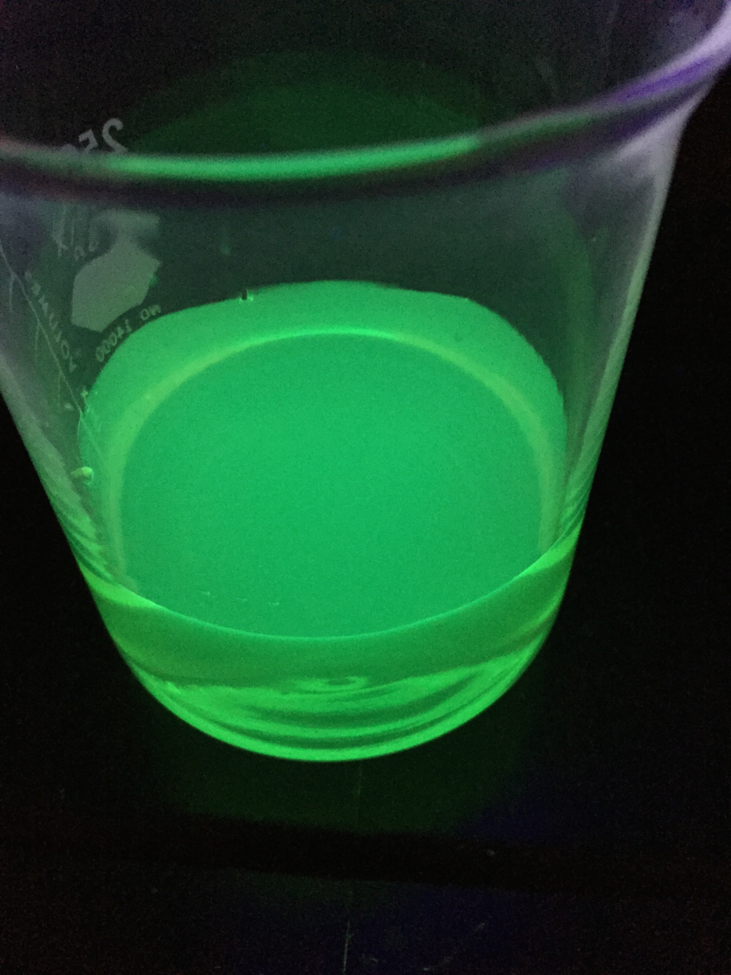

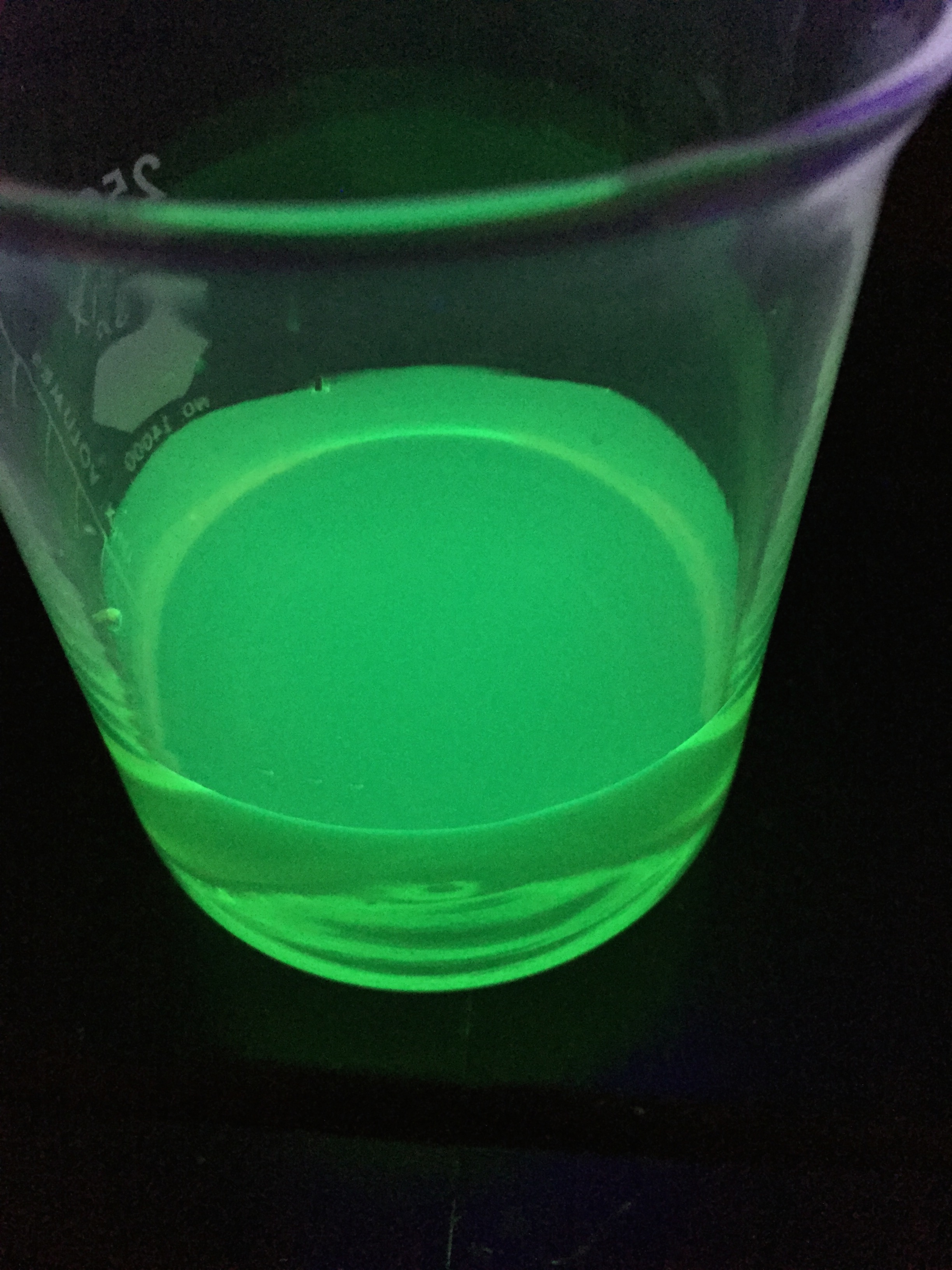

G5 pumps don't use water. They use some kind of convective fluid alright that does cause a lot of corrosion if it leaks.
AFAIK, it's mostly water, although it does have some fluorescein in it that makes it pretty under UV :)
I wish I'd actually taken the time to analyze this when I had it.
