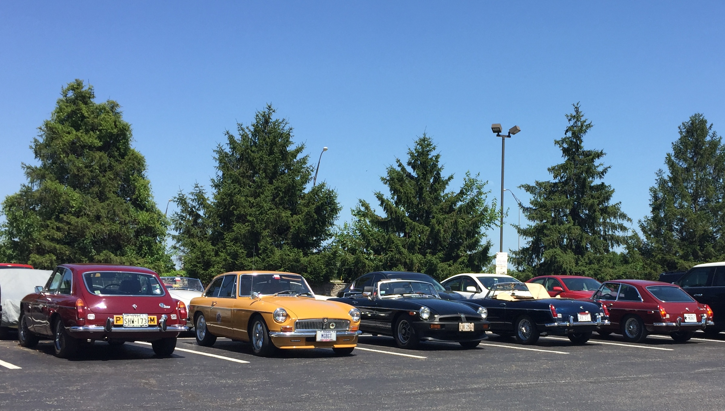

BTW, MG2016 is going on in Louisville. There's nothing like having every other car you pass be an MG 🙂 . I've seen more MGAs, MGBs, MGCs, TAs, TCs, TDs, Magnettes, and Midgets than I can count today, and the full blow show isn't even until Thursday 🙂
It's the first time I've had the experience of walking out into a parking lot when driving the MG and having to pay attention to which was my car 🙂
