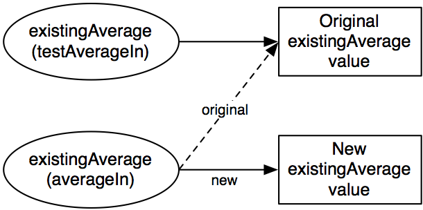

I've been frolicking in pointerless languages too much recently it seems, as I can't get this simple C function (it's within an Obj-C project, thus the use of Core Foundation classes) to work as I want it to...
This function is supposed to take an existing average value and a new value to average in, along with a weight for the existing value (the new value is assumed to just have a weight of 1.) It doesn't return a new value, but instead it should modify the existing average value that's passed in to instead hold a new average value.
Code:
void averageIn(NSNumber *newNumber, NSNumber *existingAverage,
               NSNumber *existingCount)
    double existingCountDouble = [existingCount doubleValue];
    double divisor = existingCountDouble + 1.0;
    double existingAverageWeight = existingCountDouble / divisor;
    double weightedExistingAverage = [existingAverage doubleValue]
                                    * existingAverageWeight;
    double weightedNewNumber = [newNumber doubleValue] / divisor;
    existingAverage = @(weightedExistingAverage + weightedNewNumber);
    NSLog(@"%@", existingAverage);
I wrote a unit test for this, which is demonstrating that something isn't working for me:
Code:
- (void)testAverageIn
    NSNumber *existingCount = @1;
    NSNumber *existingAverage = @5.0;
    averageIn(@2.0, existingAverage, existingCount);
    XCTAssertEqualWithAccuracy(existingAverage.doubleValue, 3.5, 0.1, @"Messed up averaging...");
The NSLog statement inside the method is printing out 3.5, which tells me that the arithmetic is right (or it at least happens to pass this test case... I'll write a few more to make sure it's not a fluke,) but it's failing this test and saying that 5 is not equal to 3.5 +/- 0.1, which tells me the existing average isn't actually being updated to the value that the NSLog statement prints out.
It seems obvious to me that I've made a mistake with pointers here somewhere, but I'm not quite sure where... I'm wondering if maybe I should be working with double pointers instead?
Yup, you'll need a double pointer for existingAverage.
Currently, when you call averageIn, it makes a copy of the existingAverage pointer - so they both point to the original number, but the pointers themselves are at different locations in memory. When you reassign existingAverage in averageIn, it creates a new object that the averageIn version of existingAverage points to, but the testAverageIn version of existingAverage still points to the old number. I've attached a diagram to illustrate this.
To fix it, change the existingAverage parameter to a double pointer (NSNumber **), change the call to "averageIn(@2.0, &existingAverage, existingCount);", and dereference existingAverage when you use it within averageIn (ie, change existingAverage to *existingAverage). This will ensure that you're working with the same pointer in both functions.

From what I understand of Obejctive C (which isn't much), you always use NSNumber*, not NSNumber even in local functions, right? I.e. if you just wanted to use a NSNumber inside a function, you'd use a NSNumber*
If so, then if you want to have a pointer to (A NSNumber pointer), you need to pass in a NSNumber**, and then do *existingAverage=@(...);. Right now, you are just changing the value of the local pointer, not the original.
if you used a double, you could get away with just passing in a double*.
Could be way off base. But basically, you need one more * than you'd "normally" use if you want to make this work.
