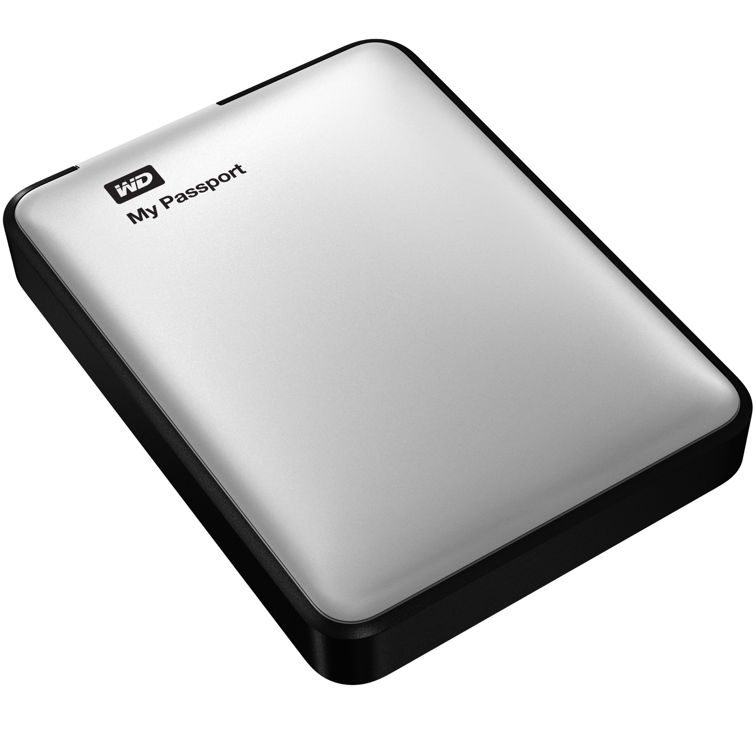

I just bought the WD 1TB My Passport USB 3.0. I don't know which drive they use in it, but it's very fast - approaching 7200 3.5" drives. I'm running it through a Pluggable 7-port USB 3.0 hub. It's virtually silent (as are most current 3.5" 7200 drives). It's actually a good deal, as you'd be hard pressed to buy a fast 2.5" bare drive and USB 3 case for what they get for the My Passport.
Computer is rMBP, mid-2012, 2.7/16/768. 10.8.3 and the latest firmware. It's highly recommended to be running at least 10.8.2 (and in the case of rMBPs, at least the first firmware update). I would recommend going the latest and greatest for your machine (10.8.3, etc.).
I've had about the same luck with both Seagate and WD, which is mostly very good.
7200RPM 3.5" drives are approaching 200MB/s by now, even the best 2.5" drives are around 100MB/s.
If you want to use it with your camera, you probably need storage – so I'd rather go with the 2TB Western Digital My Passport for Mac.

The problem with that is that the bare 2TB Western Digital Green 2.5" drive costs more than the My Passport I linked above, which has the same drive inside.
