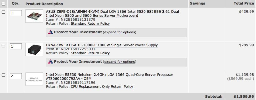

I realize that nobody actually wants Xeons or the associated expense, but I just thought I'd point it out:
If your machine isn't using Xeons, it's certainly not equivalent to the Mac Pro. You can argue this out and claim the uselessness of Xeons until the cows come home, but no build is "equivalent" without them.
That having been said, I'm now curious as to total cost of an actual mostly equivalent build (Rominator's point about the motherboard) that is an actual Xeon system. You'd also need the kilowatt power supply, four PCIe slots, etc. I guess substituting a card for ports like firewire 800 would be acceptable, as I'm not sure how many motherboards carry them.

The only thing I have against Xeons are the high mark-up price. After that, its the same thing as the desktop CPU without a disabled QPI.
I posted a combo with that... here let me post it up again.
From a purely technical POV, they're not. Just really close.
Where the issue for many comes in, is the fact that most users don't actually need ECC. In those cases, they can't but help notice the price differences in the retail market. In the component markets though, the prices are the same on Intel's published Quantity Price List, so the cost is theoretically the same (variations do actually occur, depending on the exact procurement method used, which is based on quantity purchased).
As in Xeon and ECC? Or i7's and non ECC?
In either situation, the PSU and case alone can be reduced spec wise to make a noticeable difference in price. BTW, the PSU rating in the MP is peak power (extremely common BTW), not continuous. So for a decent continuous rated unit, you'd only need to be looking at a 700W model, not a 1kW unit.
Just in case you get bored and take the time to cost out such a system/s. ;)
