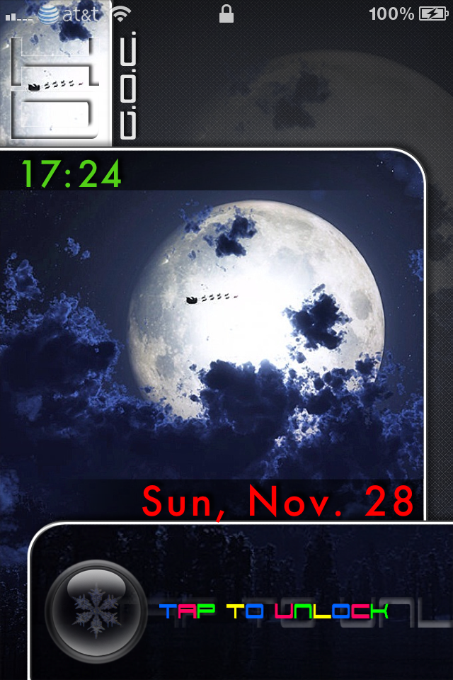

Winter/Christmas Themed
Season and Holiday change to my G.O.C. HD themed iPhone 4. Just keeping it fresh and showing my current winter themed and soon to be Christmas themed using G.O.C. HD.
The Wallpaper and others are posted HERE

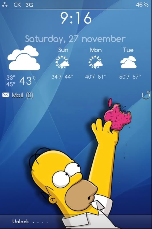

LEXS, I had another question I'm hoping you can help me with.
I've been tinkering with both your original version of 4Day and TJone's modified version (they're both GREAT!) One thing I've noticed, however, is the "slashes" between the hi/lo temps on the forecast days is slightly off. It's moved over toward the low temp a bit too much.
I was thinking, I don't mind just removing them so there's no slash between the hi/lo but I'm not sure where to do this. Can you point me in the right direction?
Original (with some weather icon mods by another member):
TJone's modified version (and TJone...it seems the 12-hour clock IS working now, so I'm very happy about that!):
Thanks for your help and the wonderful lockscreens!
You are Welcome Looking good :)
The slash / between the Hi/Lo to move over Edit LockBackground.html
These lines
<p style="display:block;position: absolute; top: 141px;left:125px;width: 30px;color: white;font-size:12px;" id="jour1" >/</p>
<p style="display:block;position: absolute; top: 141px;left:195px;width: 30px;color: white;font-size:12px;" id="jour2" >/</p>
<p style="display:block;position: absolute; top: 141px;left:268px;width: 30px;color: white;font-size:12px;" id="jour2" >/</p>
On each line you will need to move left px
Example
left:125px may be 126 or 127px
Do the same with each line moving it 1 or 2px
