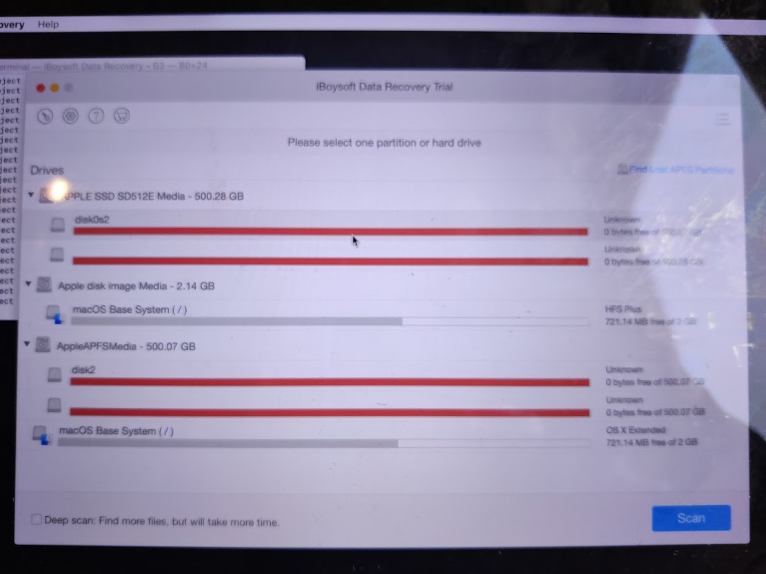

As the title describes my power cut out (faulty power cable) when I was upgrading from Mojave to Big Sur about a month ago. My 2015 Macbook Pro now won't load past the Apple logo and my Macintosh HD partition won't mount no matter which method I use. I have a second partition for the new OSX update which I have included a screenshot of after using iBoysoft Recovery to remove some important files.
Should I delete the APPLE SSD SD 512E MEDIA partition that High Seirra created?
Will FSCK or diskutil repairvolume fix my Mojave partition and will it be safe?
Does anyone know how I can fix this or what should read to learn how to fix this?
Thanks!

Thank you for the reply
I have files on the drive I unfortunately needed to remove and these are not working properly when checking on a another machine so I need to try and save these if possible (for now) and avoid formatting.

If this is so easy to do why is there recovery software that works in Recovery Mode? My Macbook Pro is from 2015 running Mojave so I don't think it will have Filevault.
A bootable USB will install files of the OSX onto the SSD I'm trying to remove files from and potentially overwrite files I'm trying to recover no? What am I missing?
If you delete the Apple SSD (with numbers drive) that will erase and then you can rename it and that will get it to mount.
I'm not trying to mount the Apple SSD volume, if anything I would be trying to mount the AppleAPFSMedia volume as this has my data and original Mojave installation (volume as shown in my screenshot). What am I missing?
