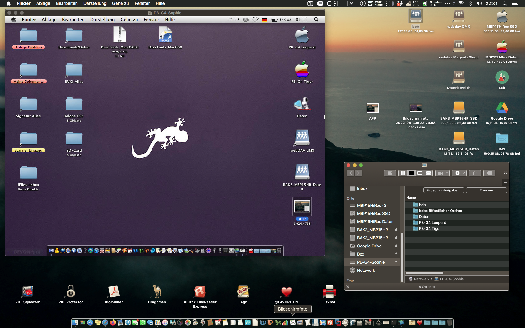

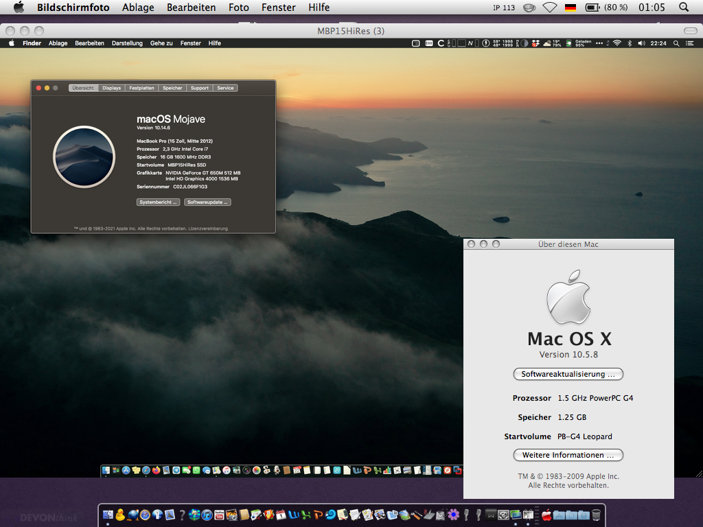

Oh, replacing that file was not a big deal on my early2008 MBP with ElCapitan.
I guess, I'll give that a try on my mid2012 nr MBP with Mojave tonight (it has SIP deactivated anyway due to problems with VMware Fusion).
I'll let you know ...

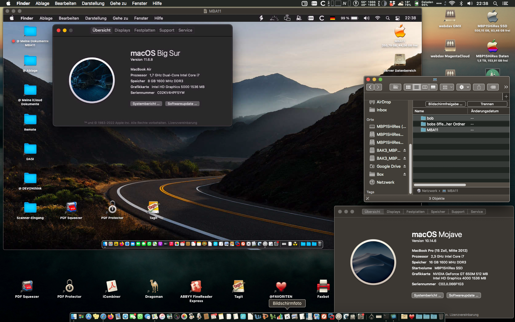

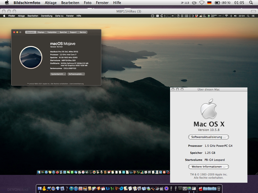

Update:
just succeeded in replacing Mojave's AppleFileServer.app with the version, that comes with Leopard(PPC).
(As I was told, that file is identical to the one for Leopard(intel).)
ScreenSharing/FileSharing between Leopard(PPC) on my PowerBookG4 and Mojave on my mid2012 15"MBP9,1 works like a charm.
I also successfully cross-checked that FileSharing/ScreenSharing between Mojave and BigSur isn't harmed by having the AppleFileServer.app file replaced by it's older version.

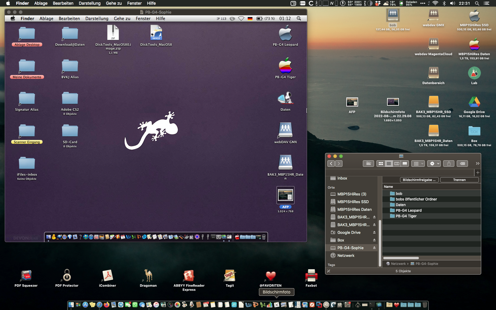

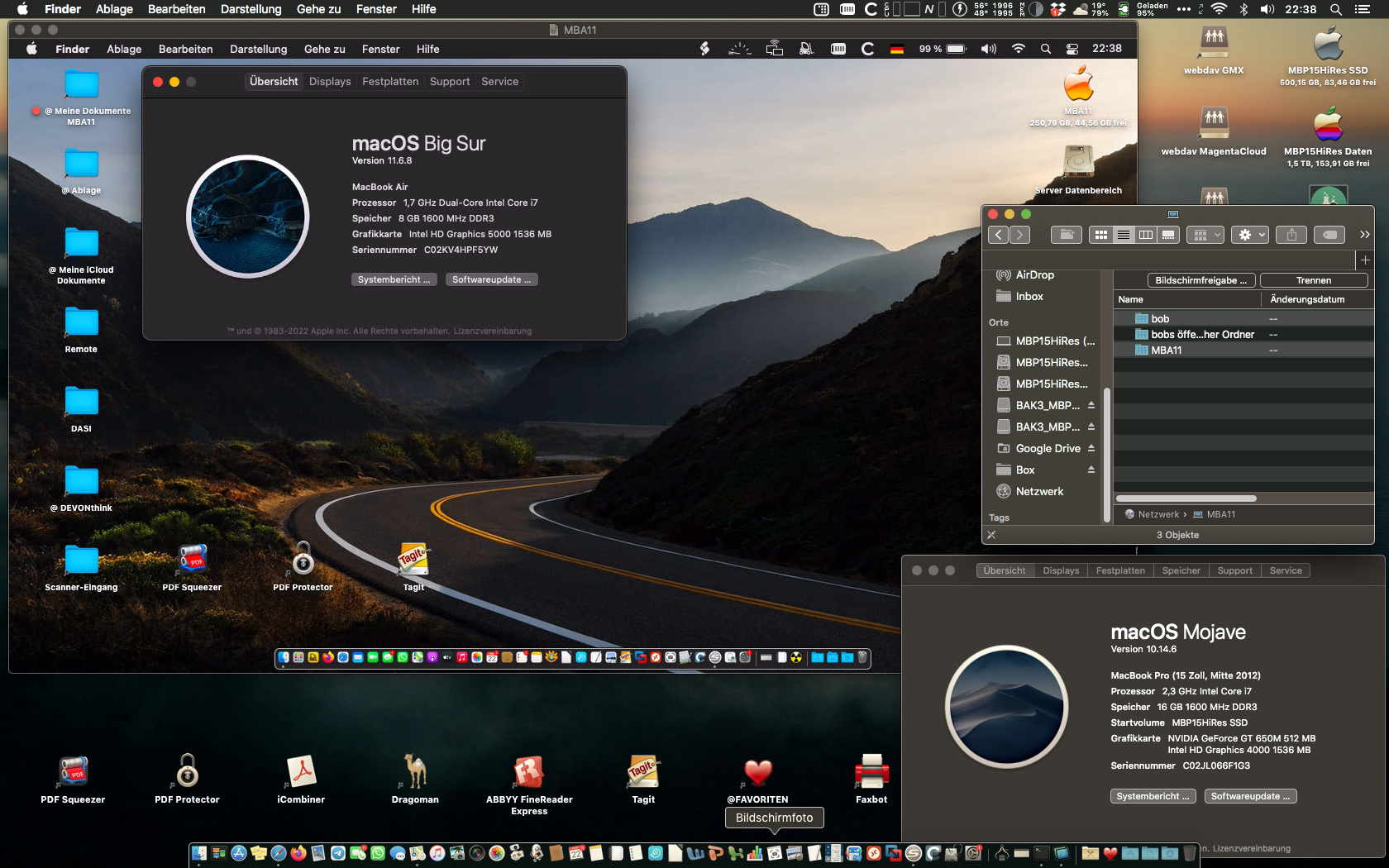

Here some screenshots ...
(it's quite nifty to have more than one user-account on the faster intel/Mojave-Mac. User-accounts, that can be accessed through FileSharing/ScreenSharing from the PPC-Mac in the background, while someone else is sitting in front of the intel/Mojave-Mac working within his/her very user-account ...
So that makes the intel/Mojave-Mac sort of a terminal-client server for attached PPC-Macs)

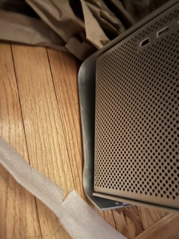

Well, I am glad to say I finally found my grail G5! A 2.3 dual core. I just hope it arrives in good condition. It was sold as bootable but nothing else was tested. I have bought from this seller in the past. His prices with shipping on some machines are too good to be true but that are! I did have a minor problem with a Performa 640CD. The front bezel broke in transit. To be fair, they are delicate machines.

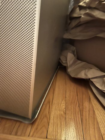

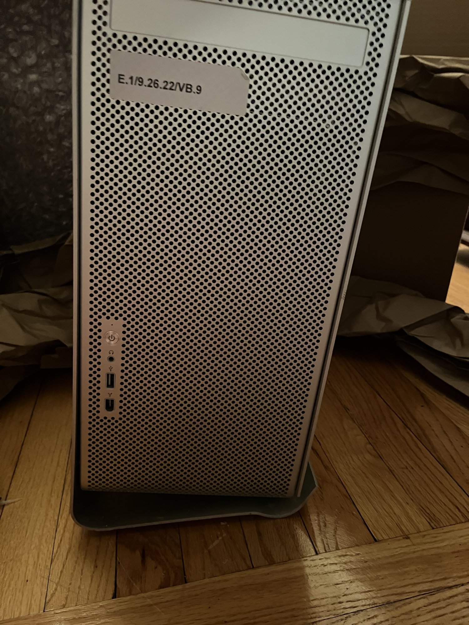

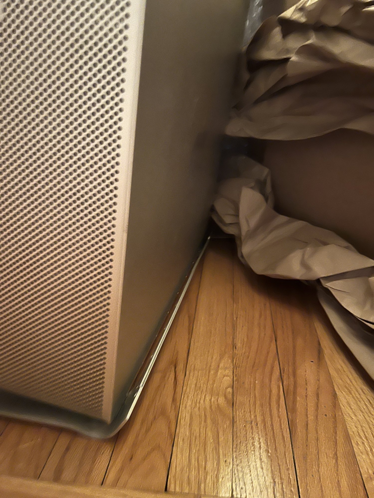

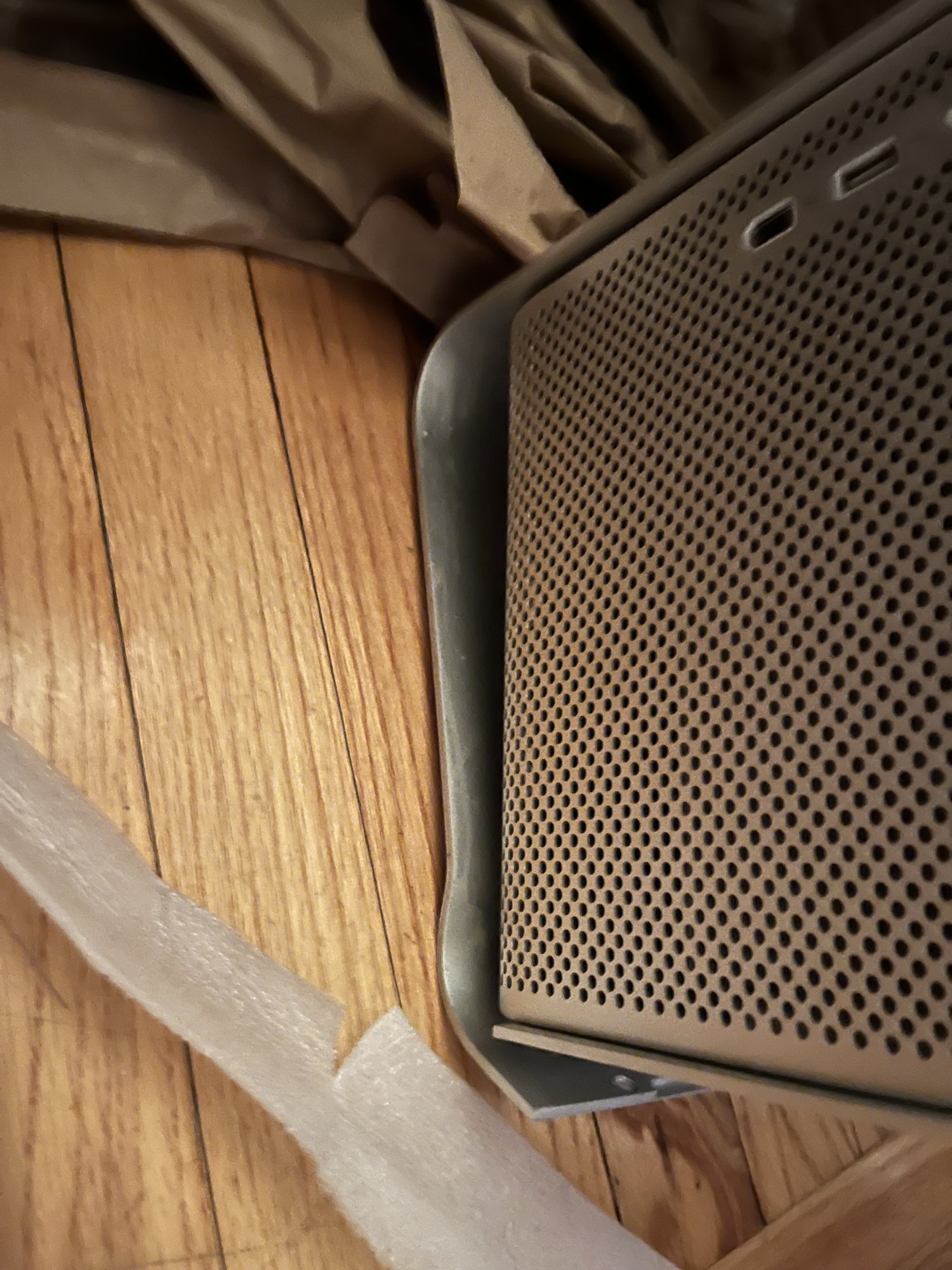

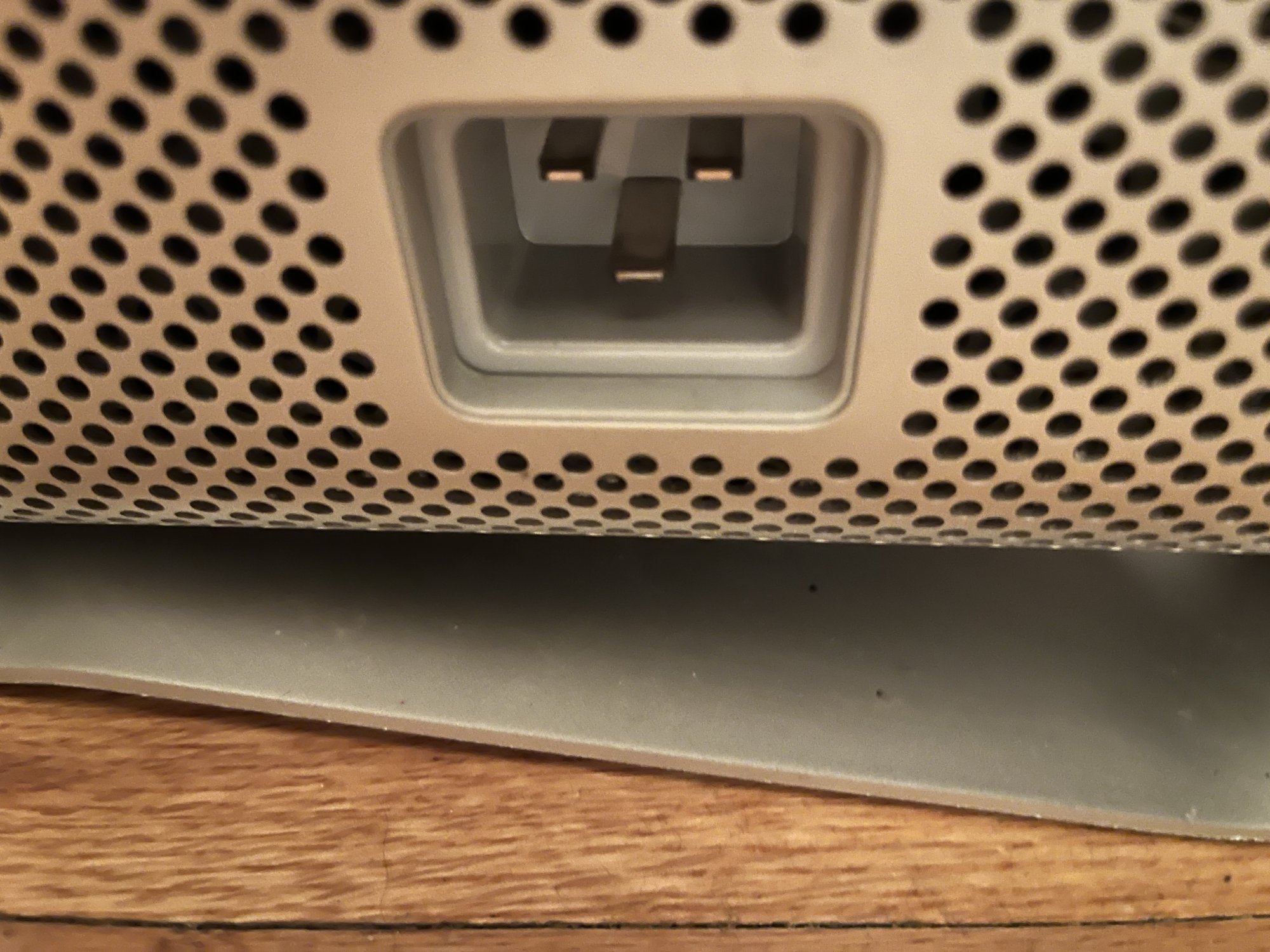

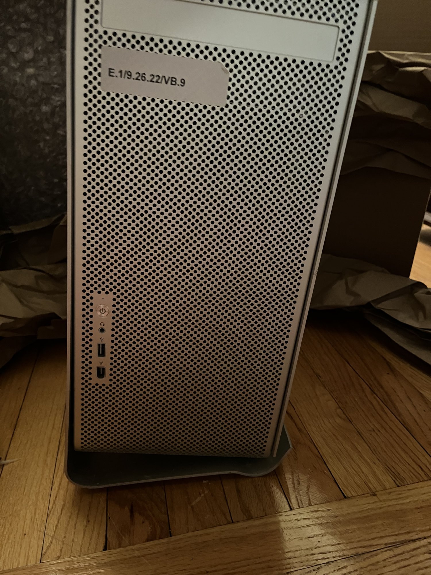

I am trying to find one locally. I don't want to risk another damaged case
Unless you have a specific reason to keep it I would recommend you return it as it is now not what you purchased. If anything maybe the seller will offer a discount as return shipping would cost them.
I sent them pictures. I probably should have just started the return process on eBay. I'll give him until Monday to respond.
If he wants it shipped back, I am worried about more damage happening that I can then be liable for.
I would hold off on opening a case with Ebay. Let the seller have an opportunity to respond and see if you can work something out. If you have to send it back send it in the same packaging in which you received it. Thus, if there is further damage you can point to the inadequate packaging to bolster your case.
I had a situation where I purchased a G5 from Ebay. Prior to doing so I reached out to the seller and explained to them that it needed to be packaged well, sent him a couple of pictures of damaged units so that he could see what typically happens, and stated I would be returning it if there was any shipping damage. He said he would package it extremely well. It arrived and, unsurprisingly, it was damaged. He offered to refund the purchase price but expected me to still cover the shipping. I told him that was a strong no and the best way he could keep from losing more money on this transaction was to just let me keep it and refund all my money. We couldn't come to an agreement on this and in the end I ended up using Ebay's buyer protection which resulted in my shipping the system back to him at his cost.
Reactions: ww2_1943

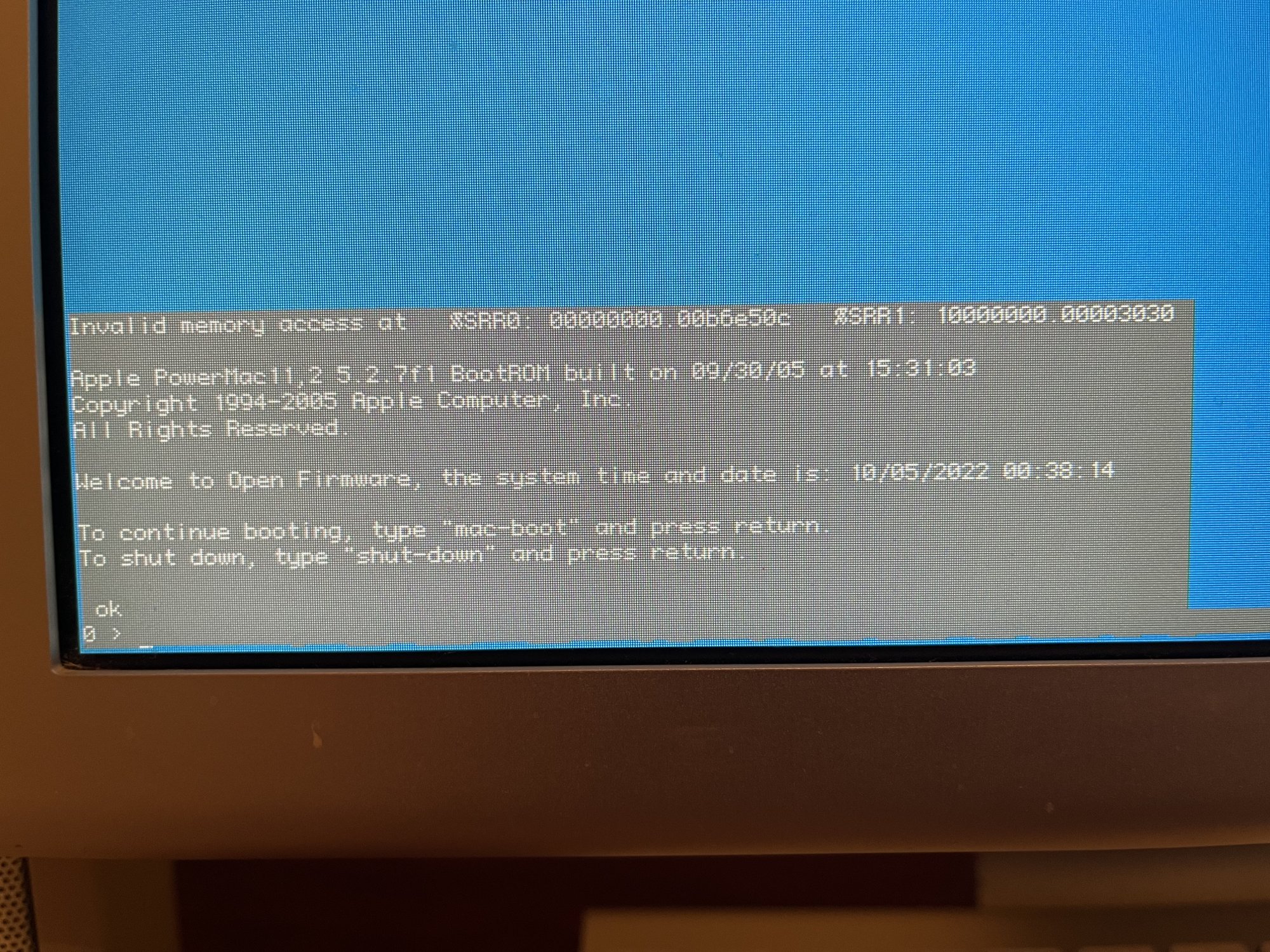

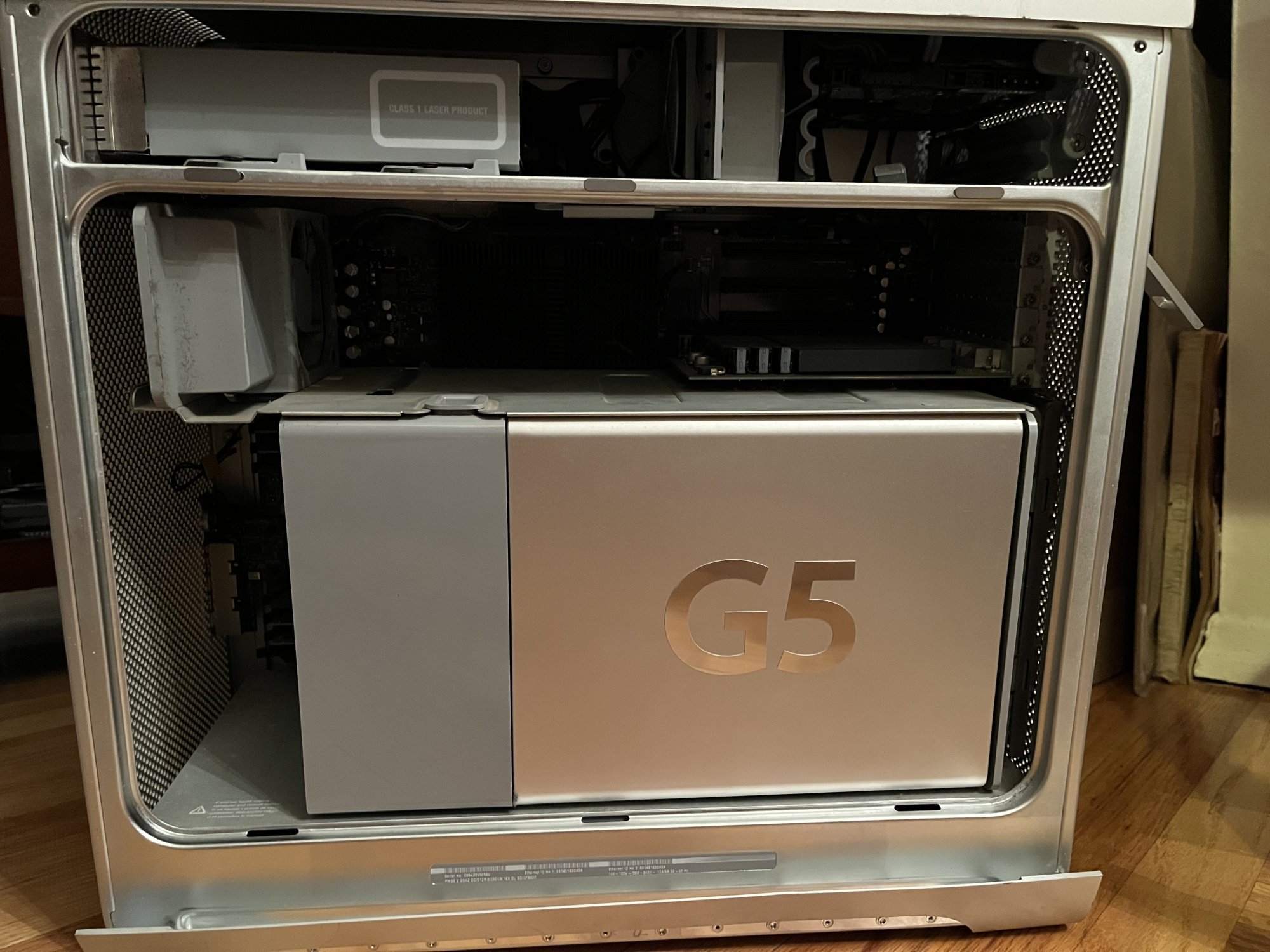

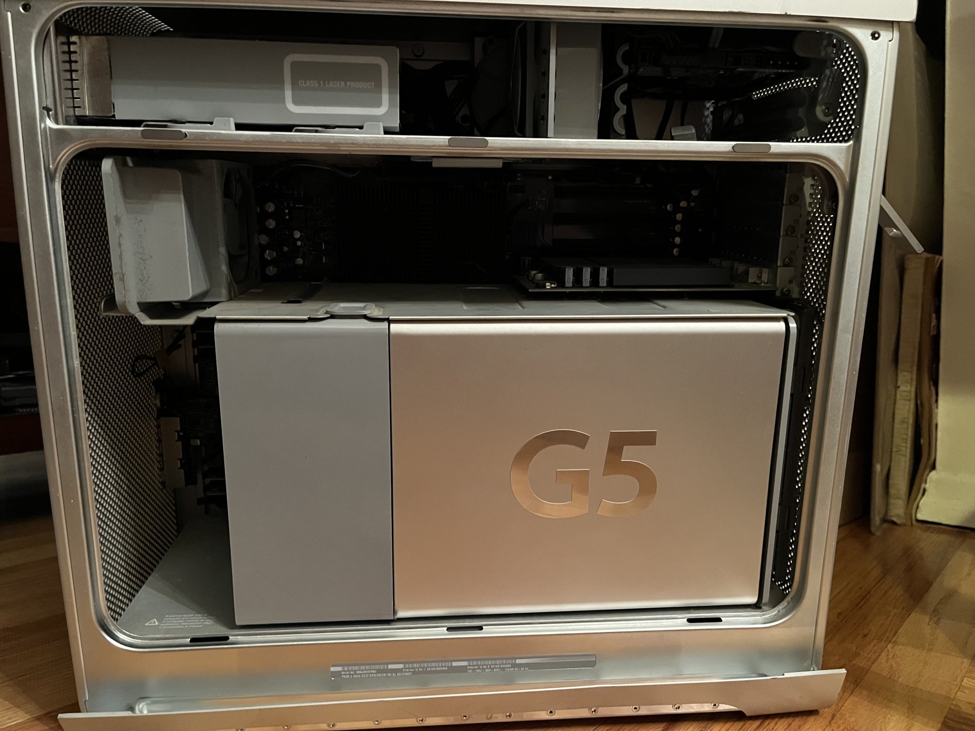

The G5 boots and seems to work. Obviously, I still need a new case though. I tried running the ASD disc and I keep getting this message. I know this is the right version for this computer.
