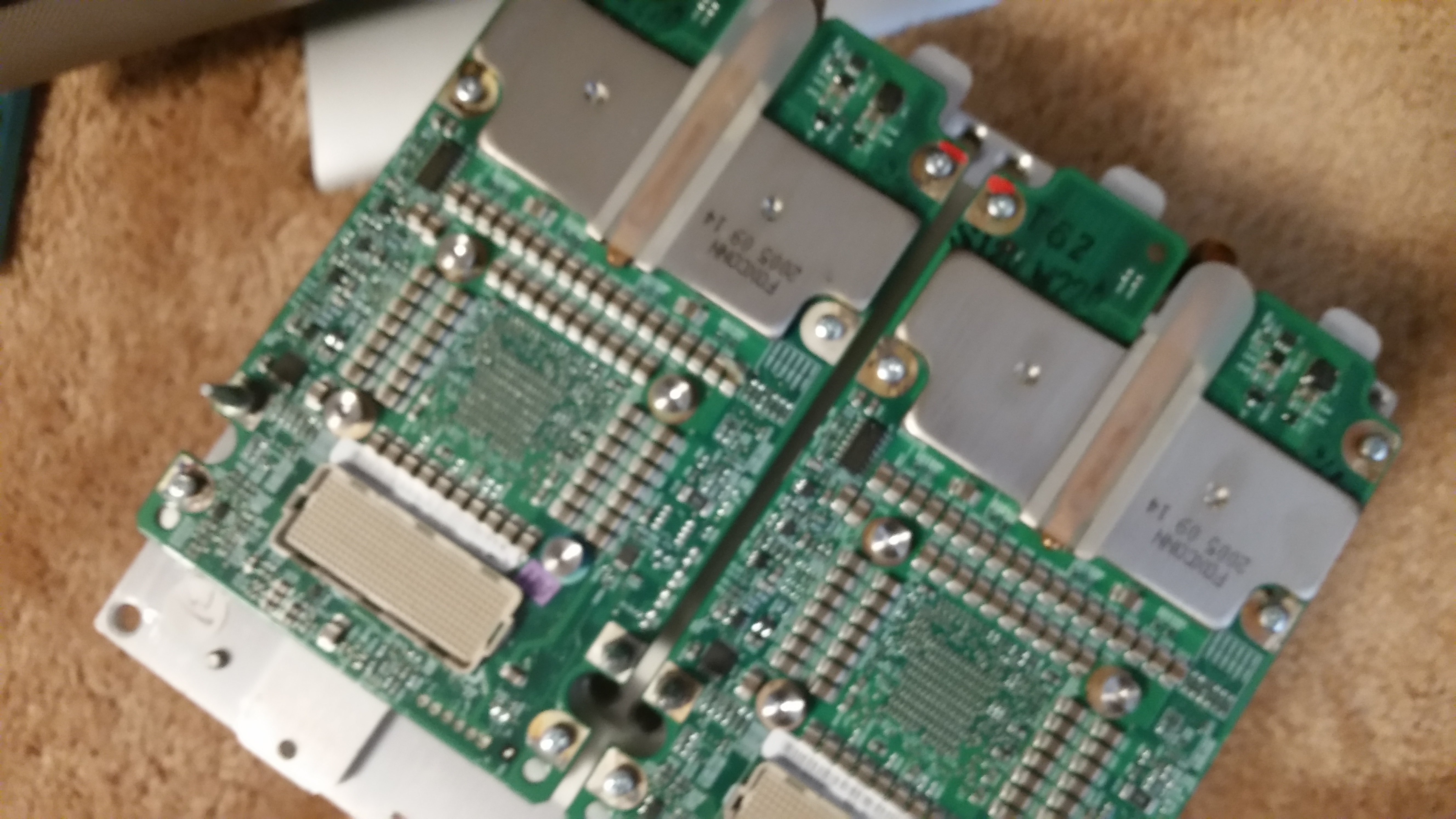

I got the cover off after an hour of -bleep-ing with that plastic pin, and now I'm ready to take off the cooler and swap the processors, I'll report back after cleaning off corrosion, cooler liquid, and possibly changing the liquid. Fingers crossed!

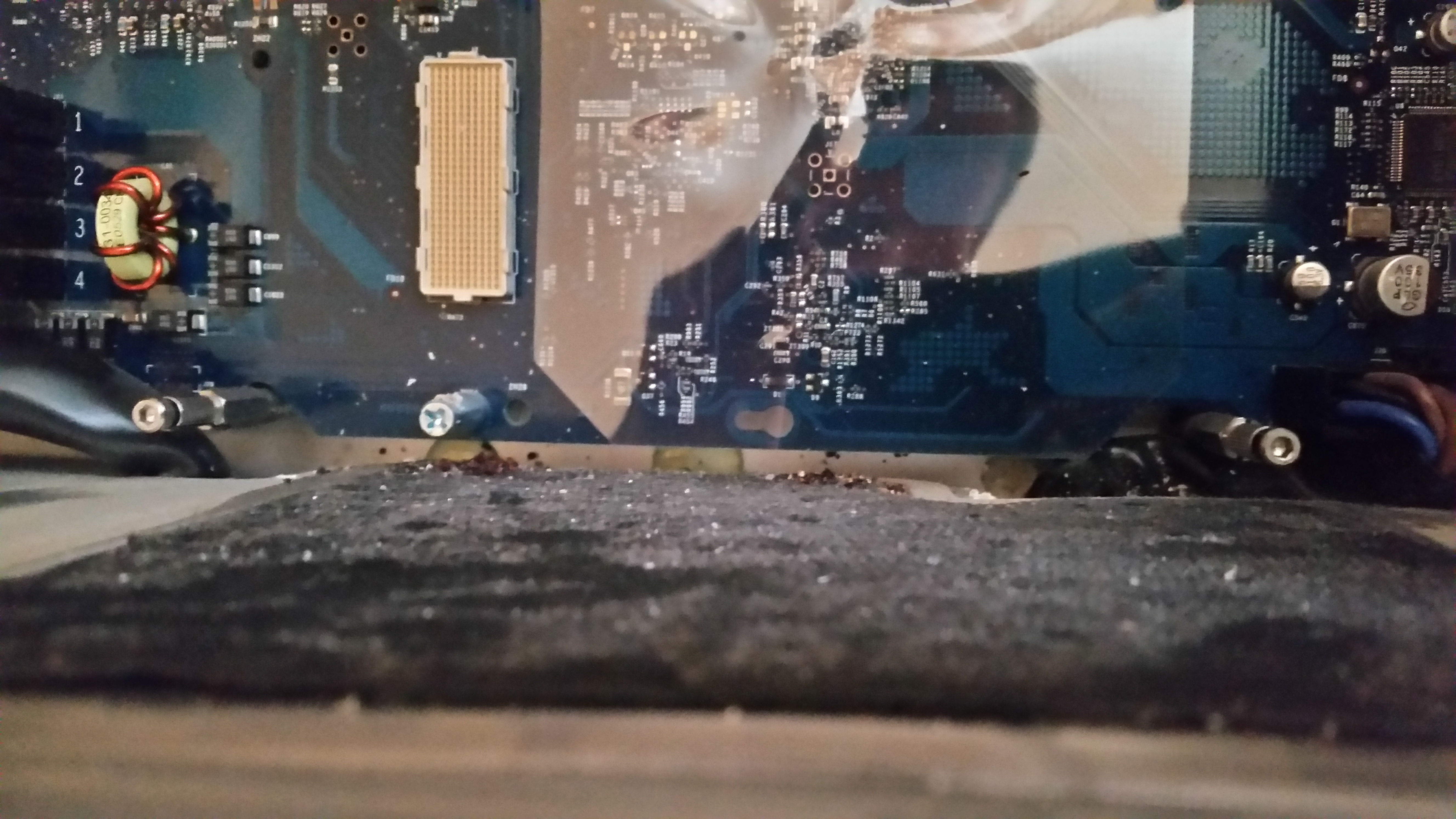

EDIT: huge roadblock.
Check pics, tell me what to do, most of the mb and case right there is damp.
[doublepost=1506886194][/doublepost]Corrosion is really bad on the case, but what should I use to clean it? Also, do the processors look fine and HOW DO I EVEN SWAP THEM?

Should you be concerned? Probably.
At this point, I would just salvage what you can, ditch it, and buy an air cooled model. One of the dual core revisions, specifically. Much less problems.
Without a doubt, the seller knew all about this.. that's why it was a dollar!
You've got a bit of a big job to clean it all up. Take your time and pull EVERYTHING apart, especially the Power Supply Unit, open it up, carefully blow out all of the loose dust with a compressor (or canned air) and clean all the components with cotton tips and a couple of old toothbrushes. Be sure to leave the PSU unplugged for a couple of hours before opening it up though, you don't want a zap from any residual power.
Pull the main board out and clean in behind as well. It can take a few hours to get into the G5 on your first attempt. It's not like working on a PC (or a G4). You'll need the right tools. I went full McGyver on this and fashioned a long-handled hex-key from whatever I could find in my toolboxes (imagine a straightened out smaller L-shaped Hex-key, joined with cable-ties to another larger hex key for leverage). This is required to remove the CPUs and heatsinks on the air-cooled units. I'm not sure if you can use a shorter tool on the LCS.
For cleaning components, I've always used Isopropyl Alcohol (99%). I don't know about mixing this with the leaked coolant though, maybe someone with a chemistry background could chime in on this. You don't want to turn your logic board into soup.
On the corroded panels and screws, you could possibly rub the rust back a bit with some fine wet and dry sandpaper then use a water dispersing product to protect it from any further corrosive ingress (I'd use WD-40 here in Australia, not sure if it exists in other countries). If you wanted to go the extra mile, coat the areas in a rust converting paint, or just find replacement parts from another cheap (non-rusted) G5.
