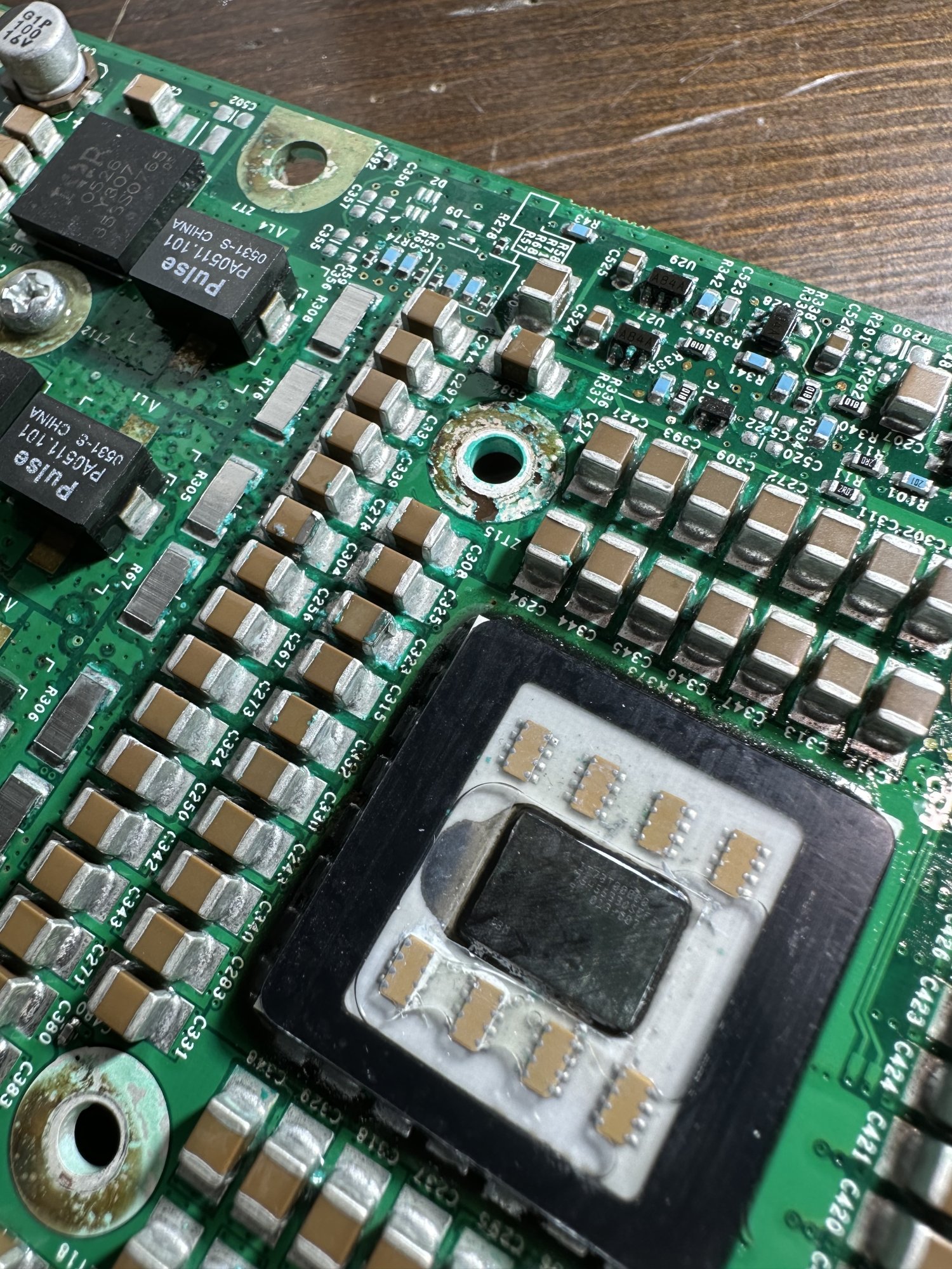

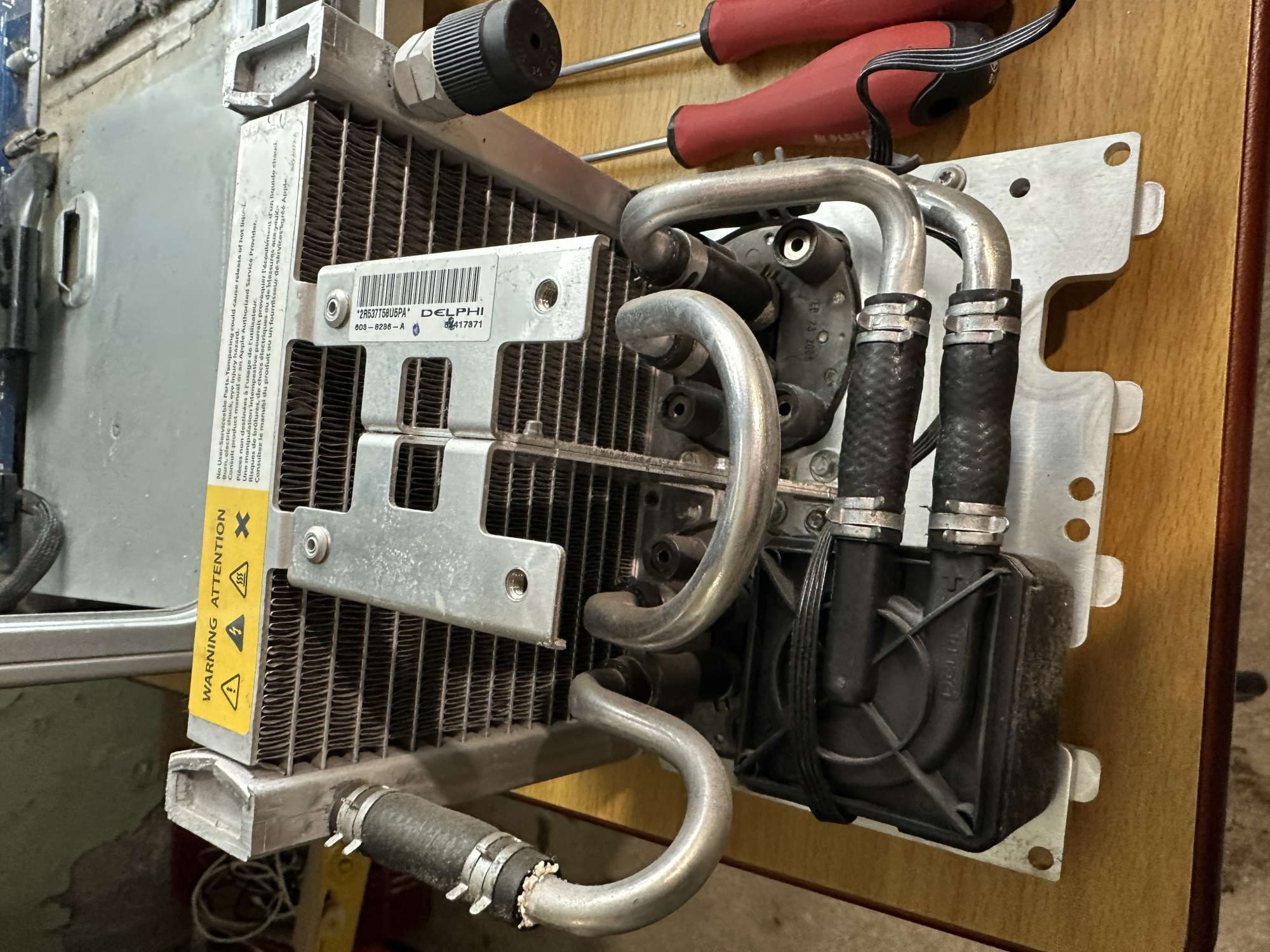

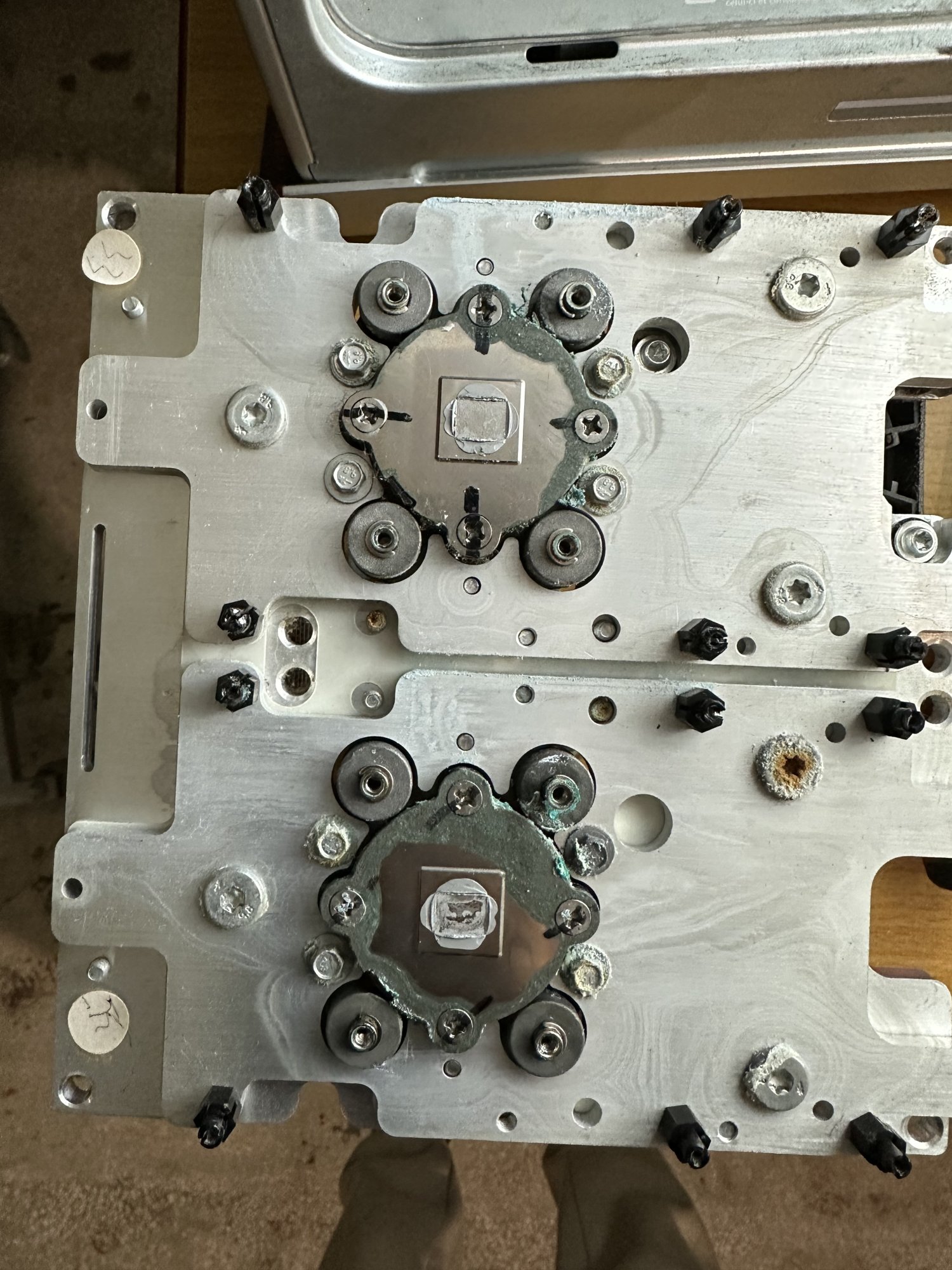

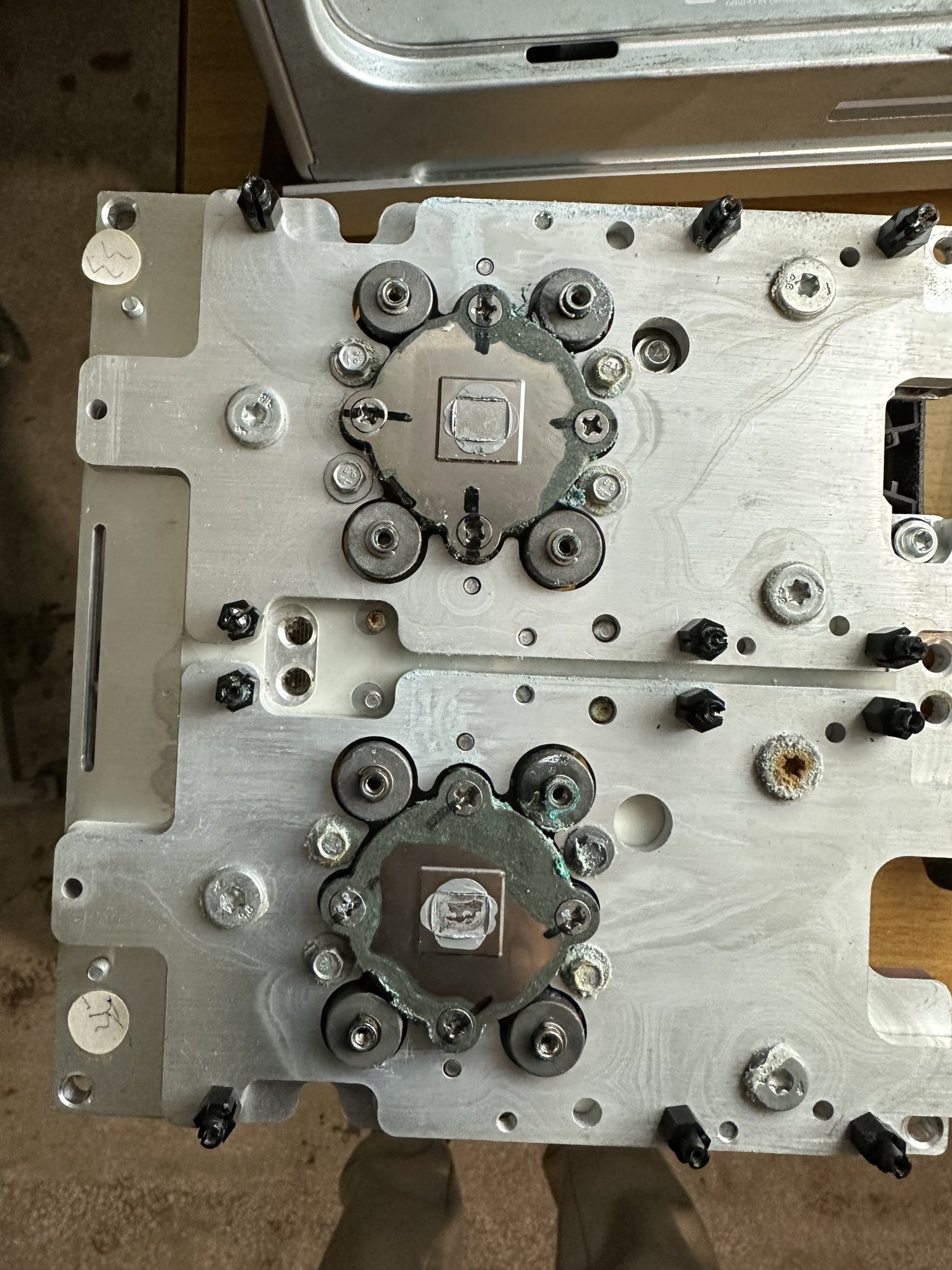

Hey guys, thank you for helping i am new to mac collecting and repairing them is difficult for me. Sadly the water cooling has leaked .One of the cpu boards is fine but the other one has some corrosion on it, which i am cleaning now. My watercooling unit has a single delphi pump. I drained it. Can i fix the watercooler , and put new hoses and glycol in it or do i have to search for an air cooler?

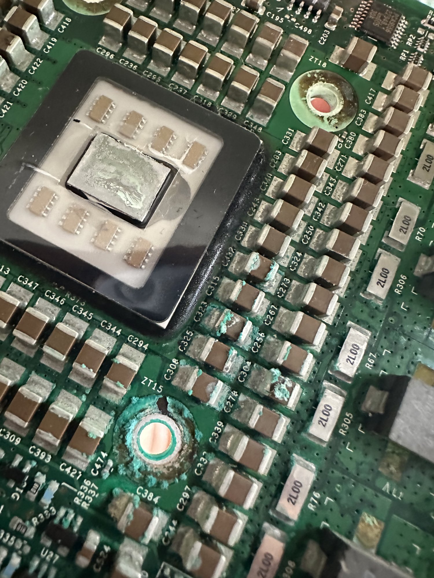

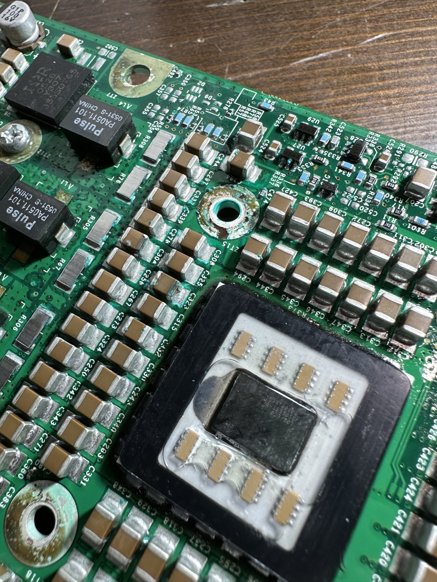

Here is the cleaned up cpu board.. I think this will power up. Sadly there are no air coolers in my area I can buy for this mac. So i would have to restore the cooler with new hoses. Can I test if the cpus working without a cooler some way? How can i run the pump without the computer? What diameter tubes do i need, are they special for watercooling? After many hours of research here are the best guides i found for the single pump delphi cooler i am going to rebuild the water cooling. liquid cooling rebuild video :: Liquid cooling rebuild and pump maintenance
:: xlr mac guide to overhaul liquid cooler.
@peterto11 What did you use to clean the corrosion? I have used baking soda and a toothbrush to clear corrosion off boards that I've worked on. It neutralizes the acidic nature of the corrosion and tends to do a fairly good job cleaning the parts.
Just ethyl alcohol and a soft paint brush because i didn't have a spare toothbrush. I just put alcohol on the board waited 15 minutes, and brushed about 10 minutes and most of it fell of. I needed a thin knife for some very hard bits that stuck to the chip's legs but i also got that off.
