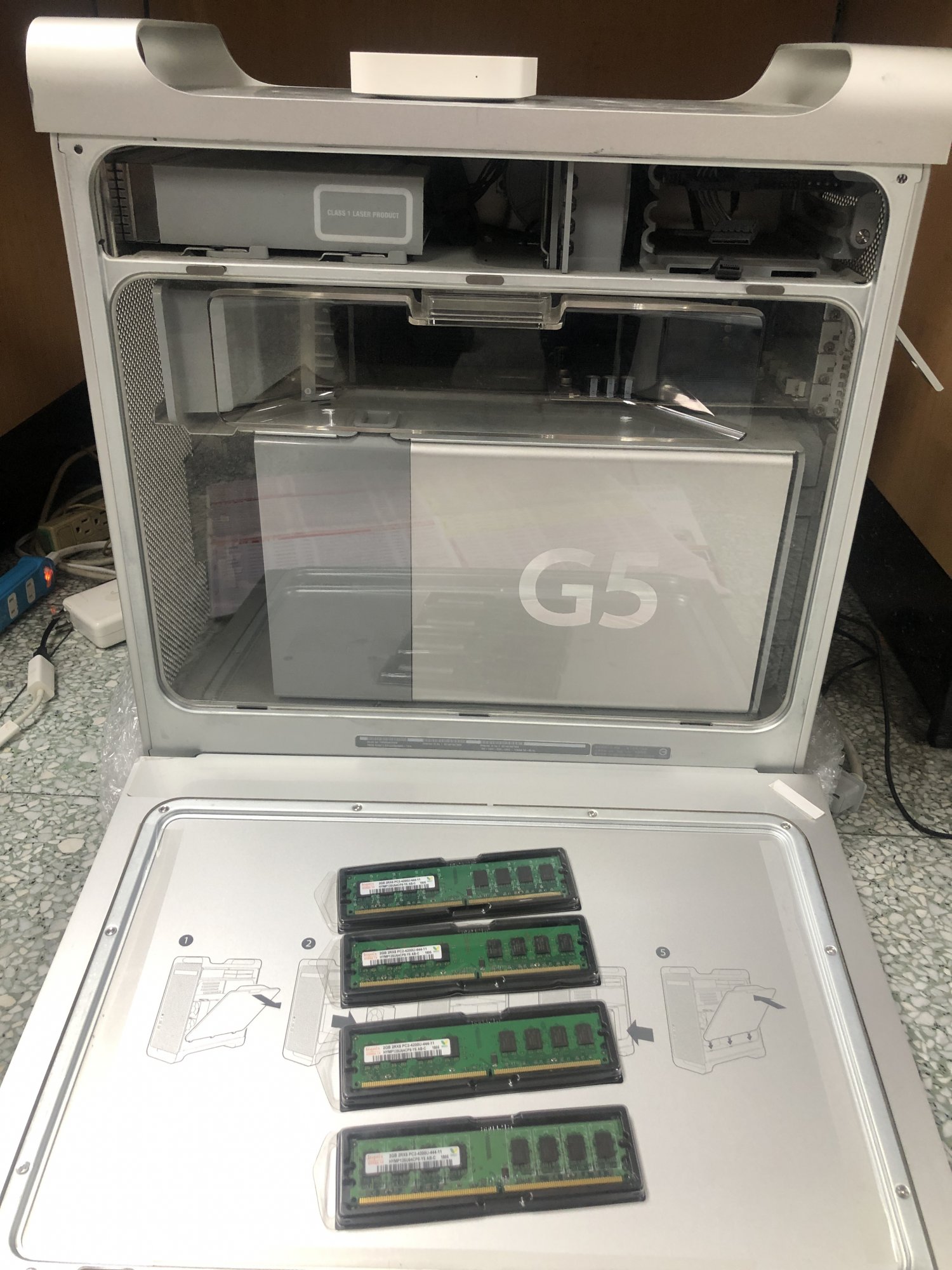

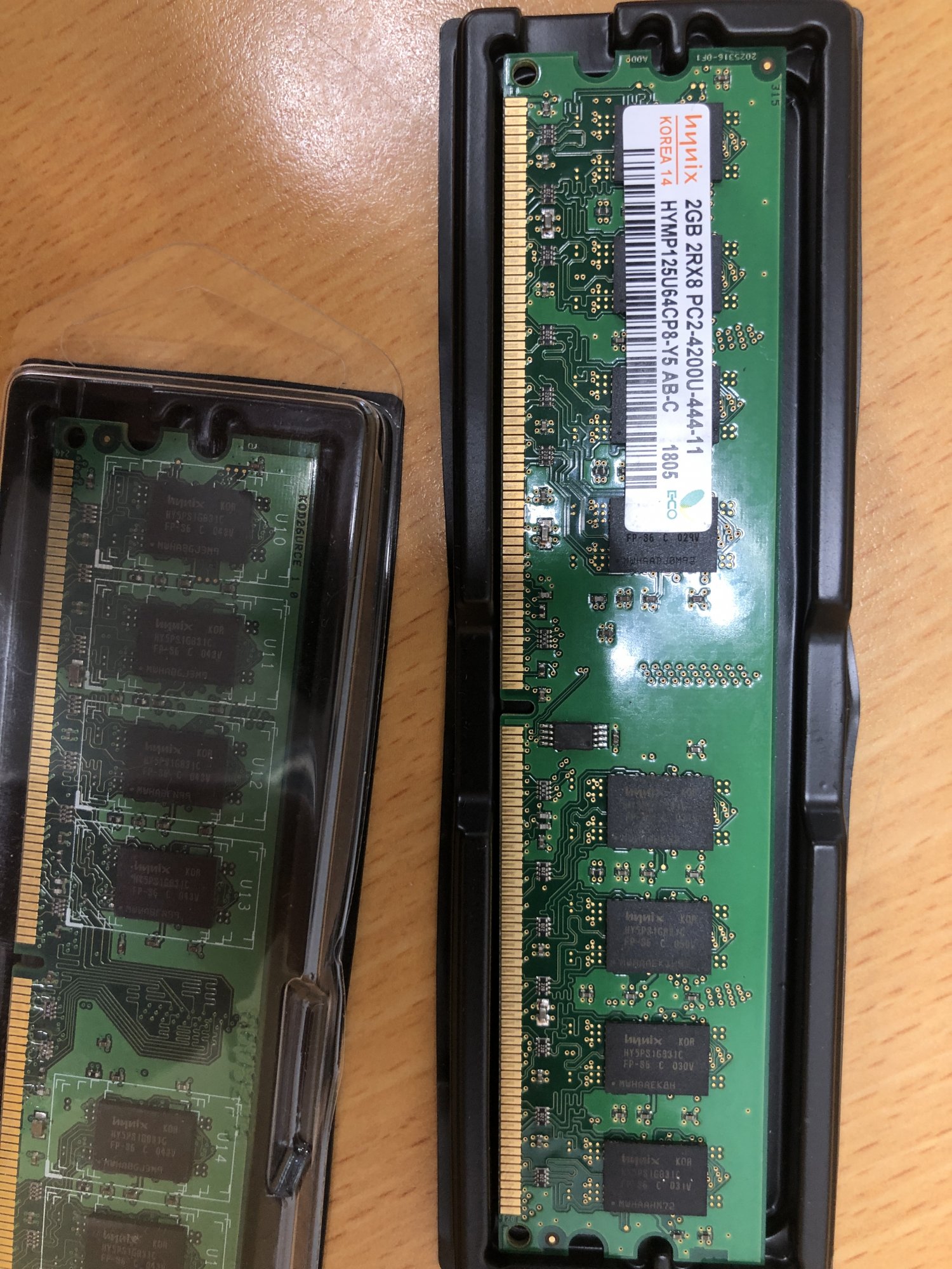

I got these sticks and they seem not to work. They fit into slots, but are too wide in “depth” and cannot be fixed in brackets. I tried just to keep them in slots and start the Quad – it does not see them. Disappointing since 50 bucks wasted.
Specs seem to be correct, but dimensions aren’t.
Does your pm have memory already installed? What do the old sticks look like next to the new ones?
Installed ones are newer DDR2 800MHz (recognized as slower). I am somewhat afraid to pull them out, because if I do something wrong with that, I cannot start the machine (there is just one pair of those installed).
Ok it turned out I did not push sticks strong enough. I managed to fit them in. However, initially all 4 sticks were not seen by the Quad, after reshuffle of sticks and reboot I got two of them recognized. Two still aren't.
What can I try doing?
Follow the installation method linked below. The ram modules need to be installed in pairs and in the specific order shown.
If installed correctly & they still do not work, I’d send them back as faulty and get replacements.
Yes, I have checked that before installing, so sequence is correct. Perhaps slots got dirty inside or oxidised, or otherwise RAM is defective. Sending back isn’t an option in my case, I got it from Yahoo JP auction, sending it back and forth would cost more than RAM itself.
