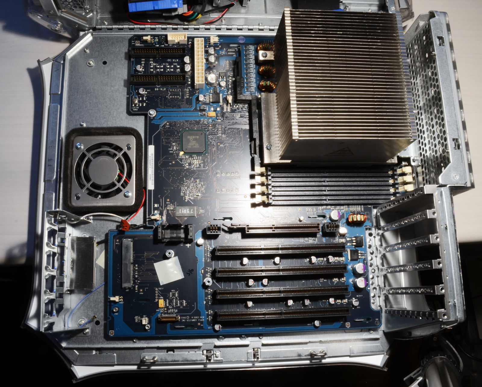

My MDD has the finned CPU Heatsink it looks like this:
(Not My MDD)
Both of my Dual 1.25 GHz FW800's came with the thin bladed heatsink, like the one shown in your photo. My single processor 1.0 GHz FW800 came with the heatsink that looks to be machined from a single block of aluminum.

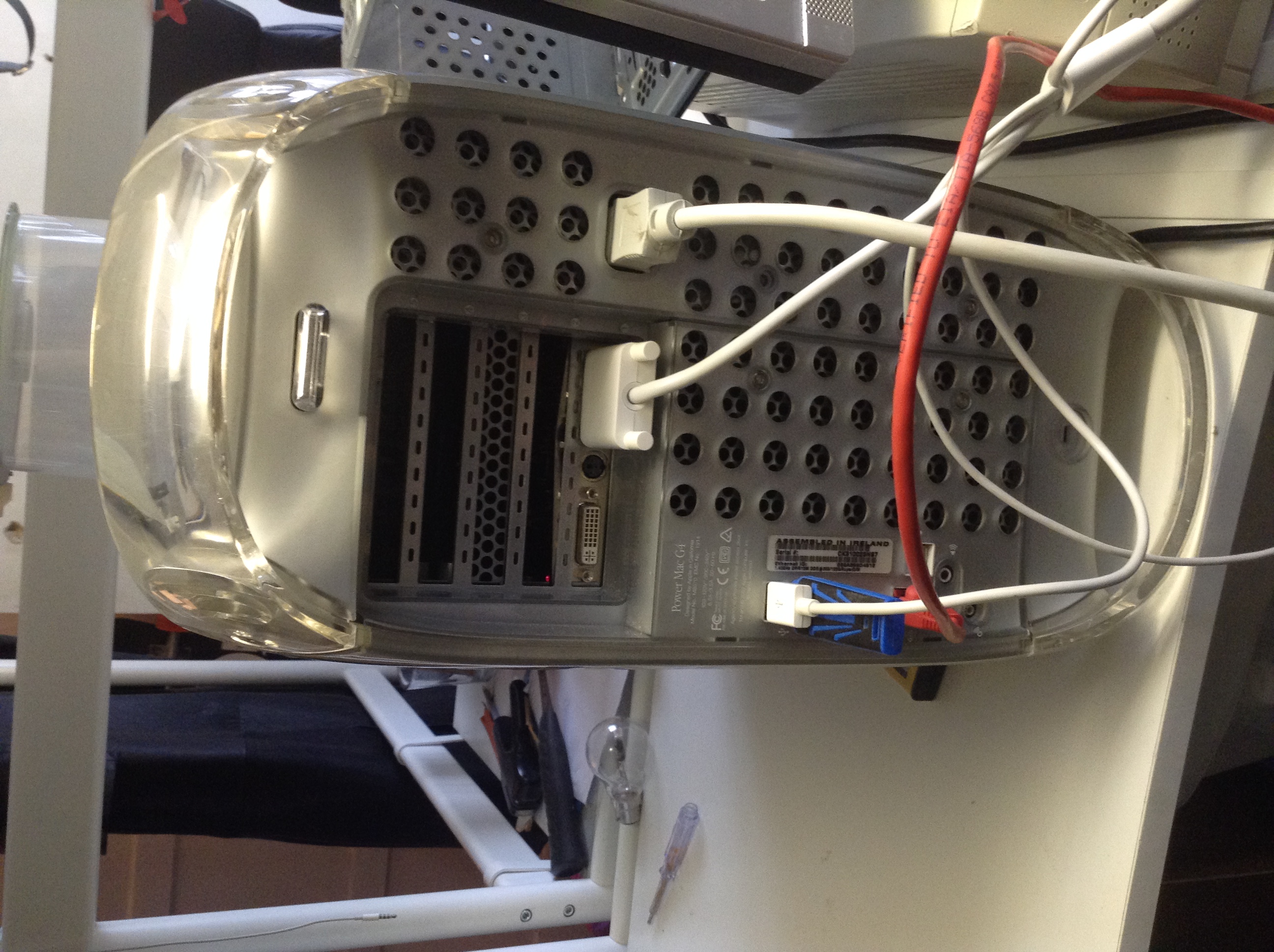

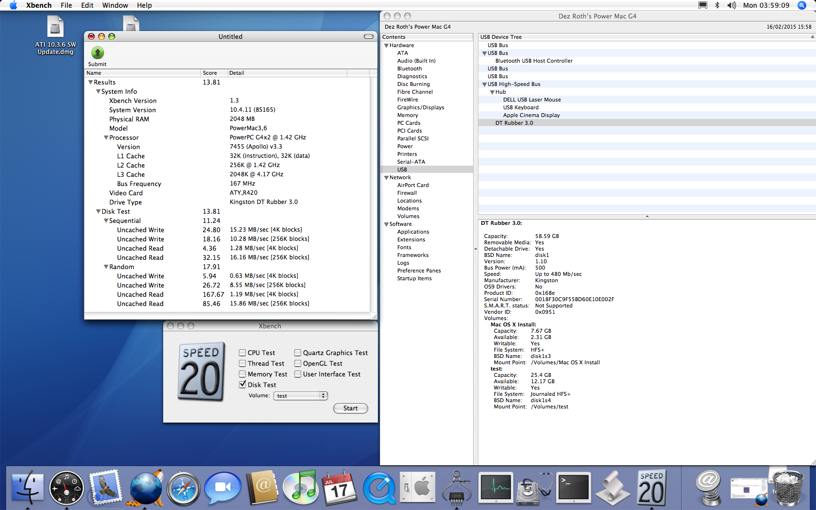

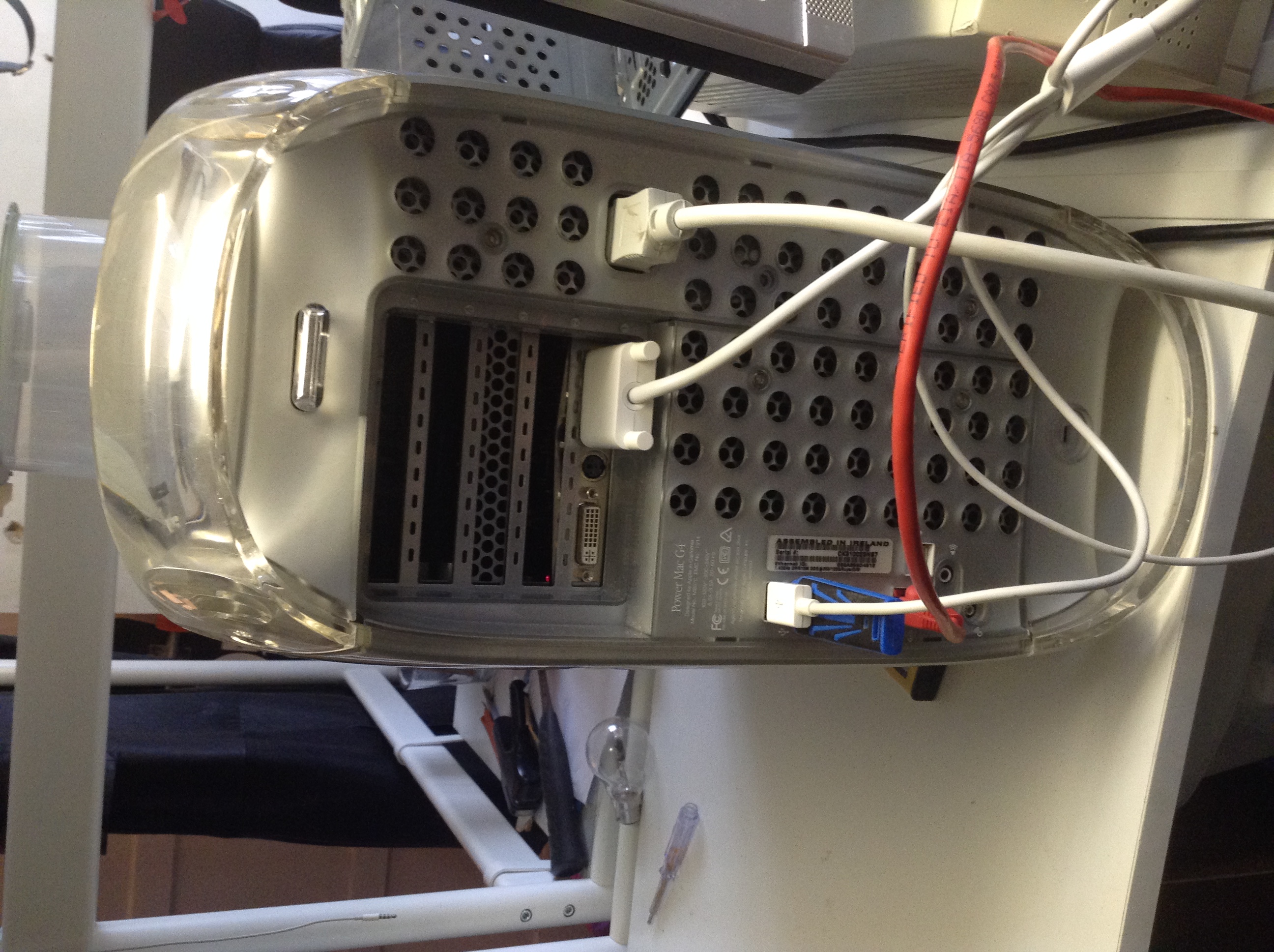

technically speaking, Wouldn't a USB 2 PCI card be moot? USB 2 has speeds of 480Mbps but isn't the PCI Bus limited to 300-something?
*ahem* 😛 (no USB 2 card fitted)

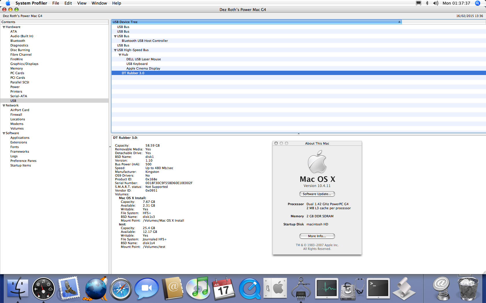

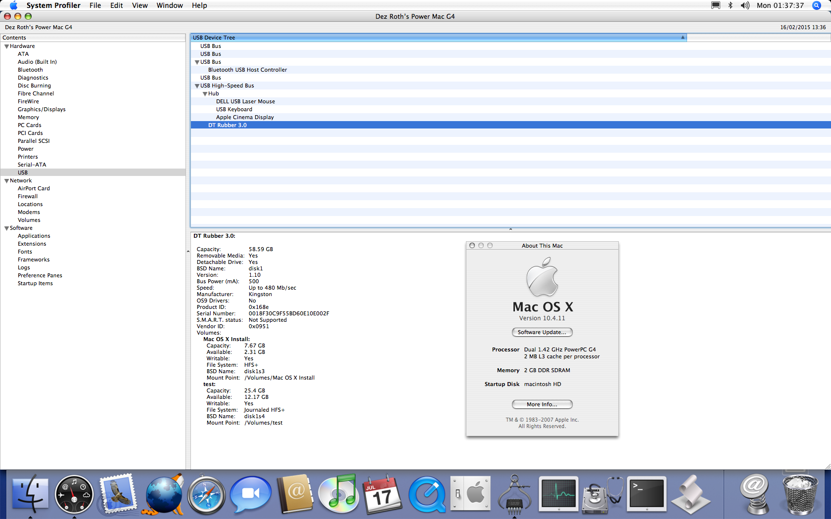

iTunes often sometimes trick the OS into thinking it has USB 2 ports when it really doesn't. It has something to do with iOS devices requiring a USB 2 port. A good example of this is any G3 system with iTunes 9.
I have never ever opened itunes on this install of OS X and I can tell you from Booting from it (that USB stick is my portable leopard install 😛) that the USB Port is USB 2... I can also try running xbench on it and see what I get...
iTunes doesn't ever have to be opened for it to trick OS X into thinking the USB port is a USB 2 port.
Then Do explain How Im getting these speeds In xbench if its a USB 1.1 port like your saying...
