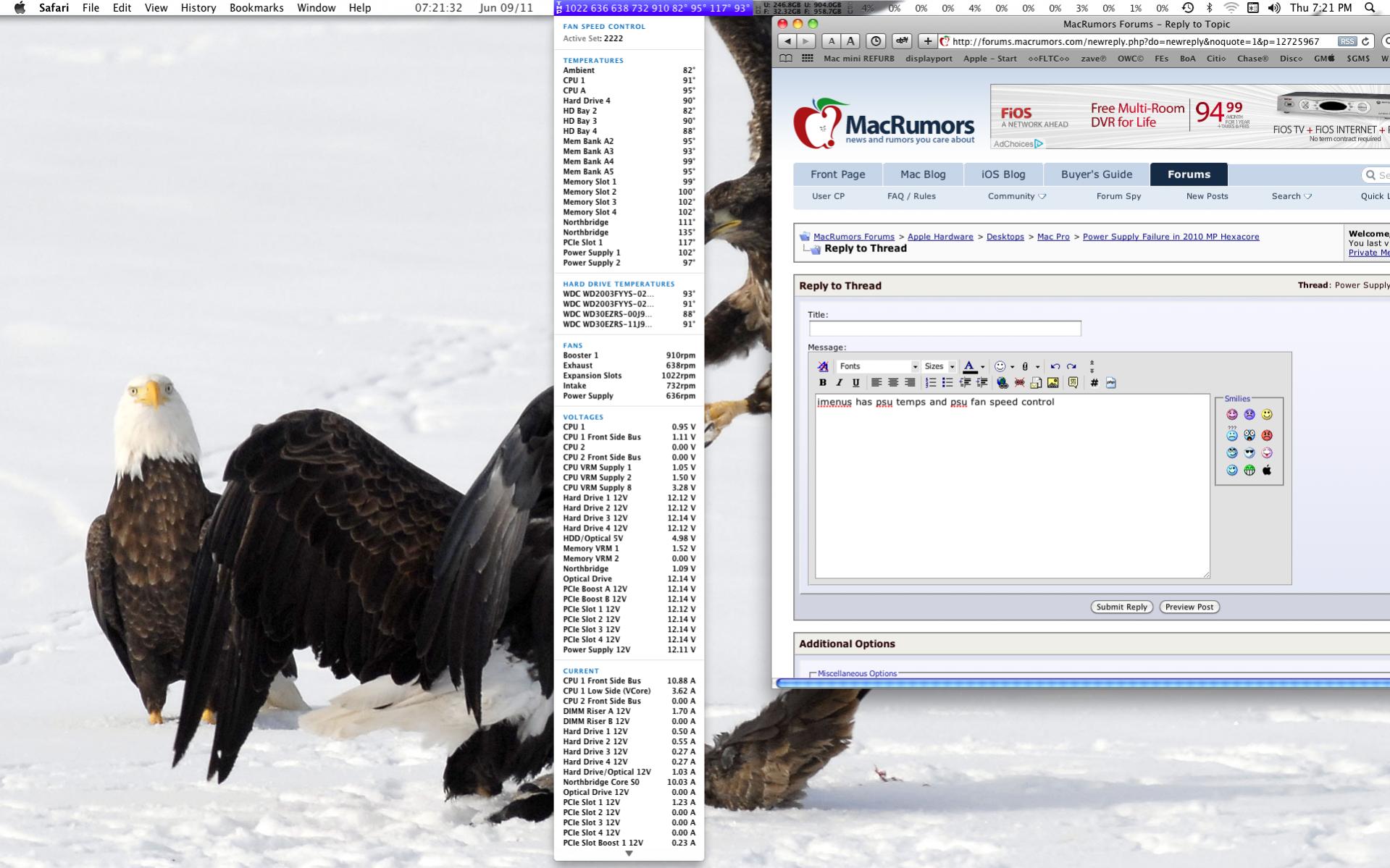

imenus has psu temps and psu fan speed control. the deluxe version is 16 bucks. you can set up to 6 sets of speeds for the fans.
So my psu is 102 and 97 my fan is 630 rpm. if i was pushing the machine like you do I could set a higher set of fan speeds to keep the psu at good temps.
see screen shot:

Is mine abnormally high? I cranked all the fans to max. and my room was filled with dust. I guess it's time to clean the tower.

your fans are a little lower that may be why.
how warm is your room.
my house had ac on and was around 77 f the temp near the computer was 82 f
you read a lower temp near the computer 79...
we have a 20f difference in temp for the psu. my screen shot was with lite use.

Thanks - do you have a link for "imenus"? Can't seem to find it just by Googling. Other options for monitoring temps? Any utility built into the OS, or is 3rd-party software necessary?
And any guidance on what represents "good temps" for the psu and other components would be helpful too.

as for temps
cpu should be under 152f or 67 c
psu should be under 140f or 60 c
hdds should be under 140f or 60 c
gpu 175f or 80 c
ram 203 f or 95 c samsung as per this pdf page 22
Clean it out, and see if that drops the temps to an acceptable value (the left side of the linked image is running near the limit, but the one on the right is even worse and it's at a lower ambient temp).
If that doesn't help, turn down the Air Conditioning a little (try to get the ambient room temp to 75F/25C).

they like 50c max that is 122 f and even lower then nanofrog's suggestion.
so the psu is hot for that mac pro 122 and 117
the 122 equals thermaltake's max. the fan speed could use a boost and a good cleaning should help. I am glad nanofrog mentioned I might be off with temp.
It is.
PSU's run cooler if the load is less than it's continuous rating, which is usually the case inside a MP. So unless I missed something, this is WAY to hot for the load (screen shot shows: Power Supply 1 = 165.5W; nothing shown for PSU #2, which does have a thermal reading, but I don't expect both to add to 980W).
