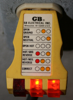

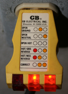

As a matter of elimination get a circuit tester $10 to check for wiring config.
you may have reversed wiring?
As a matter of elimination get a circuit tester $10 to check for wiring config. you may have reversed wiring?
Reversed polarity does not and must not cause appliance failure. Polarity exists as another layer of human safety protection. Every appliance must work perfectly normal when white and black wires are reversed.
