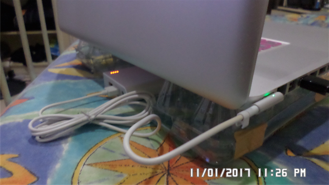

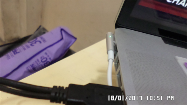

View attachment 687428 View attachment 687429 View attachment 687431

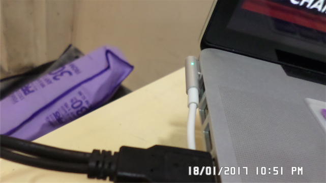

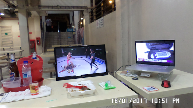

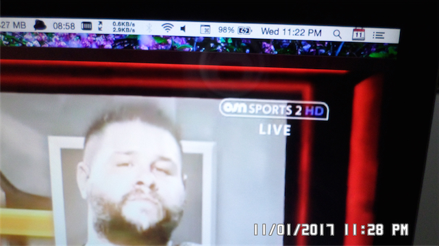

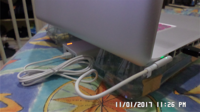

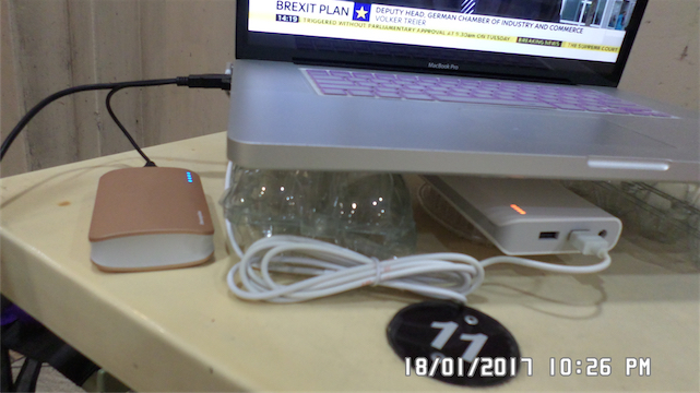

If I understand you correctly, in my case RoMoss Sofun 6 charges my MBP 17 inch when I use it to power it on as per pics above..
1. Do note that the Sofun 6 model (15,600mAh) output=65W max good enough for non-retina and retina MBP/MBA 13/11 inch models up to late 2015.
2. However the Sofun 9 model (23,400mAh) output= 85W max good enough for my late 2011 MBP 17 inch model and all 15 inch non-retina and retina models up to mid 2015.
My late 2011 MBP 17 inch battery capacity is 8850mAh at 93% health. I am a heavy chrome user with 10-15 tabs open/photo video editing at 75% brightness and I easily get 5-6hrs of use/ when used with the Sofun 9 model i get an additional 5hrs of battery while recharging my MBP17.
But more so than not, I use an external USB portable 22 inch 1080p monitor at 100% screen brightness with the MBP17. The battery life drops to 3-4hrs depending on whether i am watching 1080p or 720p streaming on Kodi on the external monitor. The Sofun 9 gives it an additional 4-5 hrs and the Sofun 6 gives it an additional 2-3hrs of viewing time.
IMHO the Sofun 9 is a better buy for S$30 more..23400mAh vs 15600mAh=no brainer.
Anyway I got my inspiration from Mr Jonathan Sim's blog article at http://autumnfloods.com/2016/03/17/...ook-air-to-last-for-the-next-couple-of-years/
I can't thank him enough.

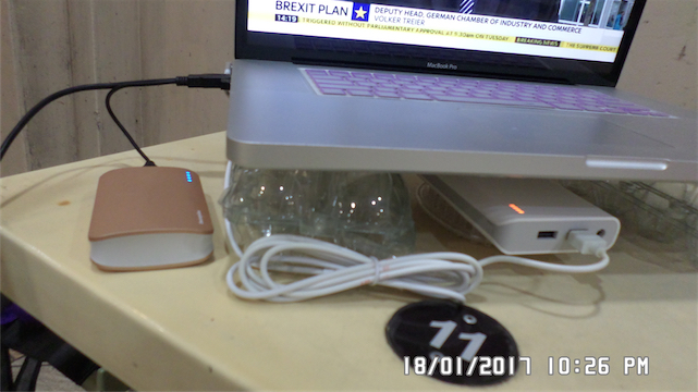

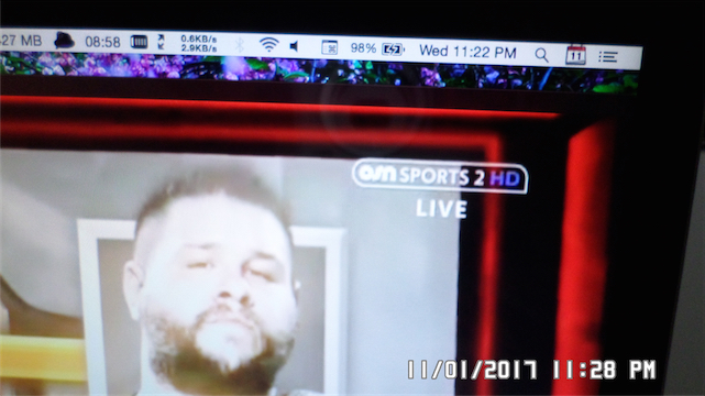

View attachment 687545 View attachment 687546
If I understand you correctly, in my case RoMoss Sofun 6 charges my MBP 17 inch when I use it to power it on as per pics below..
Wow that's even better. So if I understand correctly, you first exhaust the internal battery on your MBP, then you plug in the SoFun6 & get another 2-3hrs of usage. So at the end of the 2-3hrs when the SoFun6 is exhausted, what percentage of power would have been charged on the internal battery of your MBP?
There are unavoidable times i drain the MBP17 internal battery first ( I try not to) then plug in either Sofun 6 or Sofun 9. No problem it charges the internal battery all the way to 100% while I am using the MBP17 on its own. But when using concurrently with the USB portable monitor it charges the internal battery to about 70% on the Sofun 6 and about 85% on the Sofun 9.
I also do the opposite first for setup convenience..I exhaust the Sofun batteries first... at the end on the Sofun 6 = MBP17 reads 90% battery left / on the Sofun 9 = MBP17 reads 100% battery left.
I tend to do the opposite first. I exhaust the Sofun batteries first. Why? during setup i usually plug everything first for convenience.. at the end on the Sofun 6 = MBP 17 reads 90% battery left / on the Sofun 9 = mBP reads 100% battery left.
But there are unavoidable times i drain the MBP17 internal battery first then plug in either Sofun 6 or Sofun 9. No problem it charges the internal battery all the way to 100% while I am using the MBP17 on its own. But when using concurrently with the USB portable monitor it charges the internal battery to about 70% on the Sofun 6 and about 85% on the Sofun 9.
Ok, the internal battery on 2011 MBP 17" is rated at about 8600mAh (if I got my math correctly with internal battery rated at 11v) so it's definitely good news that the SoFun6 rated at 15,600 mAh can power the MBP AND charge the internal battery to 100% within 2-3hrs.
So am I right to say that w/ SoFun6, you can literally get 2 * 7 + 2 (maybe 3) = 16-17 hrs of usage out of your MBP? Assuming a fully charged internal battery would last you about 7hrs, then 2-3hrs to charge it fully via SoFun6 while exhausting the SoFun6, then another 7hrs on fully re-charged internal battery! I'm excited!
