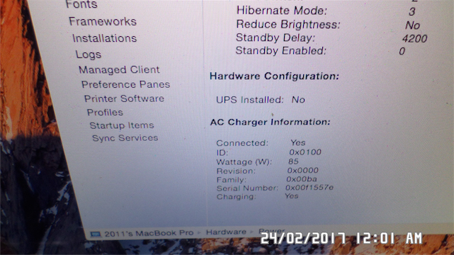

2. However the Sofun 9 model (23,400mAh) output= 85W max good enough for my late 2011 MBP 17 inch model and all 15 inch non-retina and retina models up to mid 2015.

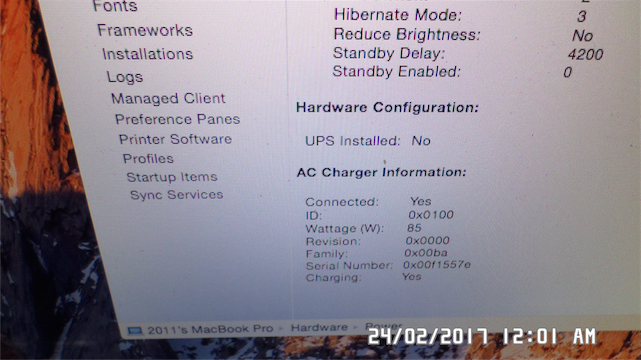

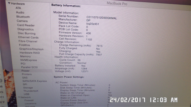

1. Eventhough RoMoss's website stated..."Output eUSB:..(65W Max)..." , I thought it would be best to doublecheck
through Yosemite's System Information, as previous experience with other manufacturer's portable batteries have made me wary of misleading information.

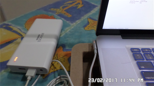

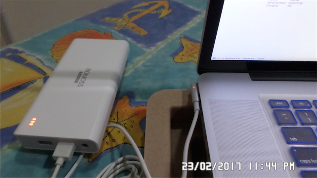

2. early 2011 MBP 17 charging while I am using it

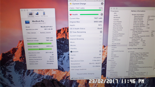

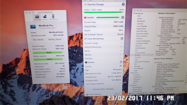

3. Verified with Coconut Battery & Battery Health software that RoMoss is charging at this point in time = 12.4 Watts
Battery currently @ 94% state

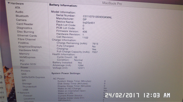

4. System Information under Battery Information/Charge Information/shows Charging-Yes
5. System Information under AC Charger Information/ shows Wattage (W): 85
FYI yes the RoMoss is being recognized as an AC Charger
From this I concluded that the true output is 85 Watts max
