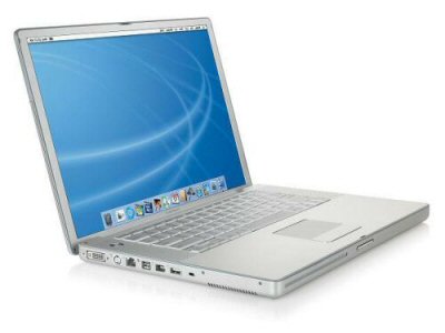

I've had this PowerBook G4 about 10 years.. never used it much after the initial purchase so long ago. Edit!!! Lol it's actually a 17".
It's the top of the line spec and the last of its kind. But I've since lost the power brick for it and I recon the battery has gone the way of the dodo..
I'll need to buy a new power brick. Can anyone recommend one that doesn't cost the earth?

I would check on eBay. Pretty easy to find. Make sure to get a 65W charger. Some of the cheaper ones, keep in mind the sellers often try to pass off 45W as 65W and you won't know until you put the Mac on the charger.
I'd avoid anything costing $10 or less. Had one of those $10 one's catch fire on me once inside Starbucks.
Thanks, lol visual mistake, it's actually a 17" inch PB. Cool I'll get a 65w one. Chances of pram Batt still being good?
