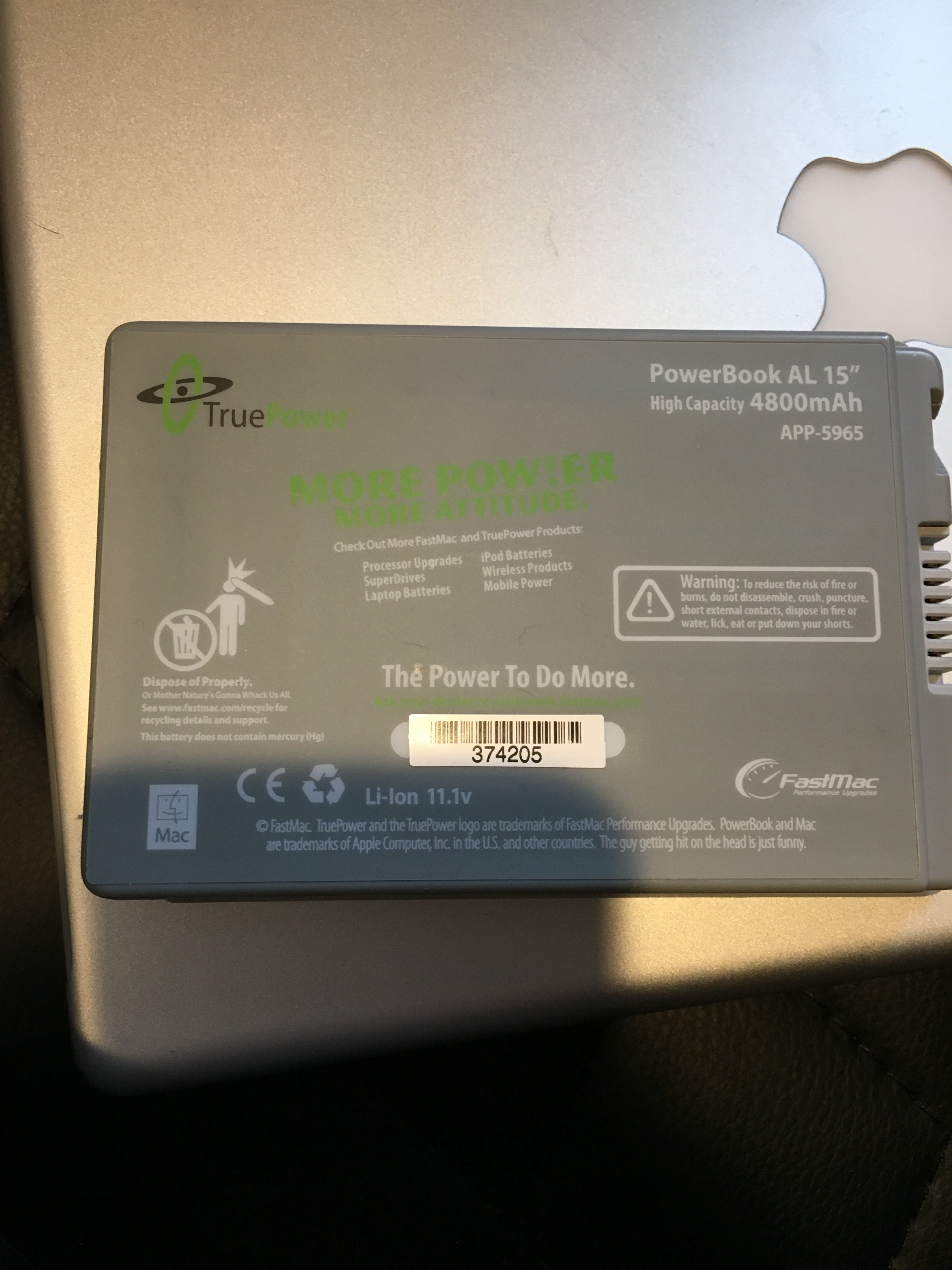

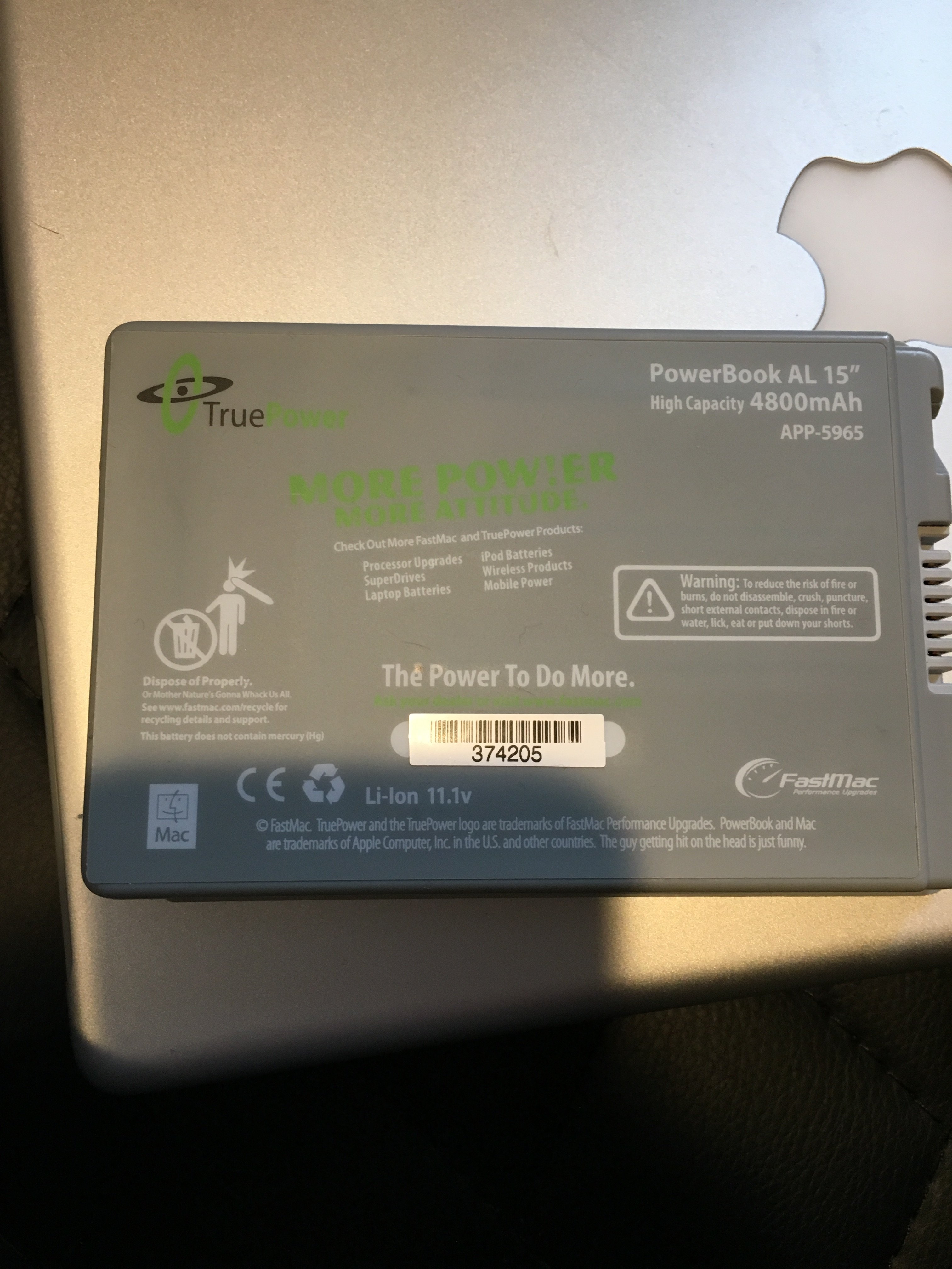

I have a decent battery in my PB G4 "15 that hasn't given me a problem, I'll pull it out and give ya the brand when I can.
EDIT: here's a pic, it looks like it's a FastMac battery
Interesting. I note that it's a battery for a 15", and I see that it's still listed on Amazon - although probably old stock. I say this because I can find no reference to a FastMac 12" PowerBook battery since 2007/8.
