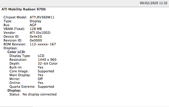

Current update: it's booted! I'm posting this from it.

Actually had some time to spend on this today! I had a fair amount of fun getting an identical drive, eventually sourced one from China mid pandemic. The 'book is now assembled with the drive in place. I'm installing Tiger / Leopard to different partitions on it.
The machine seems to work, although occasionally hangs, and doesn't restart until I bridge the reset jumper on the logic board... not sure about fully assembling the case until that is sorted out!

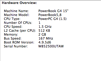

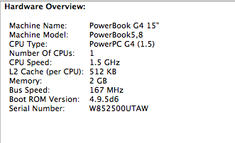

I'm very tempted to have a look at the CPU on mine... I think I've now seen the same doc as @LightBulbFun - this points to a 7448 prototype option, as well as 1.5 and 1.67 7447s. Interestingly it tells you what to switch around to fit a 7448 to a DLSD board (I'm not doing this.).
Also - I agree that every shipped DLSD is a 7447. I dropped everymac a mail to ask them to correct the site 😀
Edit: looks like i can do it in OF, so will have a look at that; although having read the saggy noodle/rabid thread I would assume mine is a 7447 like all the rest as it reports 512 KB cache.

your prototype DLSD has a 7447B CPU, but I am pleased to see its working well now 🙂
